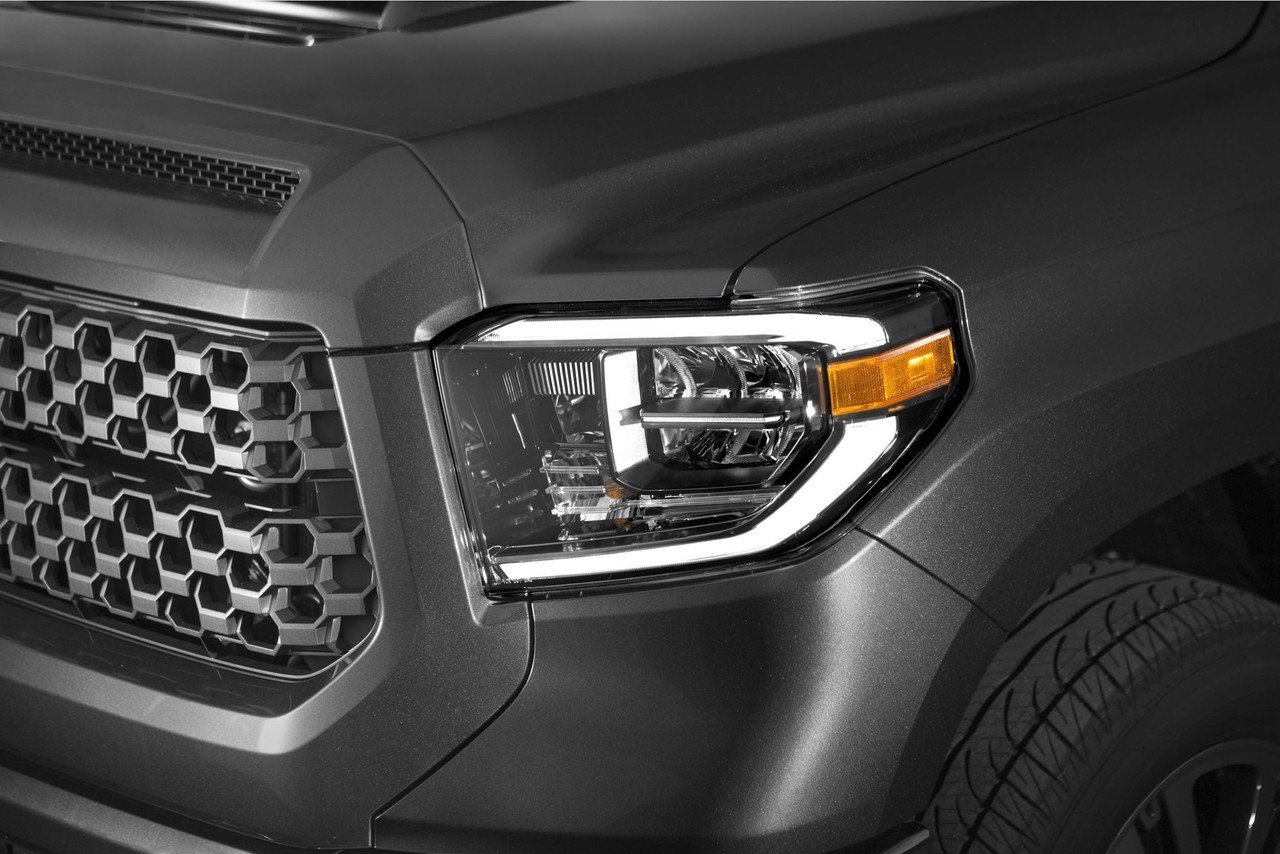

    Someone gave me one of these headlights for free. Before I order the other one and the harness I wanted to make sure this one works. I have a 2017 SR5, if I were to directly plug this headlight in what would happen? Would it just not turn on or? I plan on getting the harness from @iHacker but I want to make sure this headlight works first. upload_2020-6-1_1-1-44.jpg

    As long its not broken, it should work with the correct iHacker harness.
    They're not plug and play with the stock harness, you will need to get the conversion harness to test it.

    You actually just need the adapters not the entire conversion harness like the older trucks without the LED DRLs.
