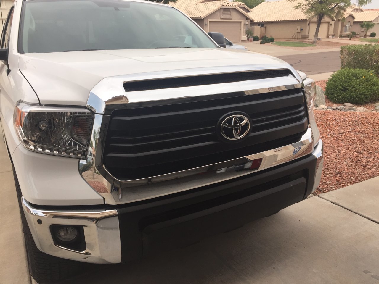

    I have a 2017 Tundra SR5 TRD off road 4X4 I bought a few months ago. I could not take all the chrome on the grill anymore. I really wanted to go the TRD Pro grill route, but wanted to try the plastic dip route first. So far I really like it. I actually used Dupli Color custom wrap paint in the carbon matte black. I like the dupli color, but, it did not spray well when the can was tipped more than a 45 degree angle. I removed the grill and placed on some saw horses to paint.
    Anyway here is the picture of the finished product. I left the Toyota emblem chrome but I may change that. What do you guys think about the emblem?

    I like it. I have the same front end. I don't have a problem w chrome, but holy crap it's a lot of chrome. Every time I look at it I think of the cylons from the original battlestar galactica. It just needs a red light going side to side.

    Nice , it looks good with th chrome badge, imo.

    I like it. Personally I would black out the emblem too. If you don't like it just peel it off.

    Love it the way it is.. You've convinced me, and I'm going to do it. Did you take the grille out to paint it? If so, how easy was taking it out?

    Looks great. How many coats of plastidip did you put?

    Yes, I removed the grill to paint. It was very easy. 5 to 10 minutes tops! When you open the hood you will see 4 screws and 2 of the plastic rivets. Remove those and there are 2 clips on each side near the bottom that you just kind of lift and pull forward on the grill and they come undone. The Toyota logo just clips on with 3 clips. Very easy to remove

    I did about 4 or 5 coats. Did the 1st coat lightly, then 3 or 4 more medium coats. I basically used the whole spray can for the job.

    I like it! It looks great since you kept the chrome around your grill, and at the ends of your bumper. As long as you keep that chrome, I vote you keep the emblem chrome. Good job with your project!

    I agree! It's been a week now and the more I look at it, the more I like it as is. I don't think I'll be blacking out the emblem.
