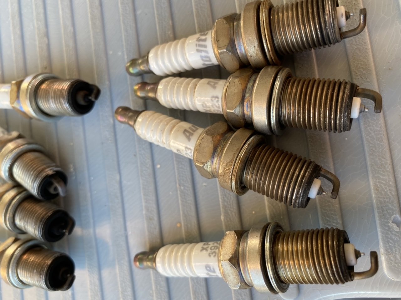

    Ok I’m gonna go out on a limb here and say my ecm is toast lol. One whole side is not firing it seems. What do you guys think. Look at the plugs I pull. Top is driver side. And bottom is passenger side. And who the hell puts autolites in a Toyota lol. I’ve got denso on the way. If you all can see the pic let me know what you think. Anyone seen this before? ECM fried?

    The drivers side is soot covered ones but they are not wet, correct? Passenger side is not wet and very clean and white?

    The gap is really wide on the top plug that is clean. Looks to be .100 looks rich on the other bank. The ECM would not be my first thought. I'd get some correct heat range ND plugs and gap them and start over.

    No neither of the sides were wet. And yes the gap is way off on many of these. But the truck ran good at low rpms. But when you tried to gas it it would hesitate and surge. Passenger side sounded like a dual exhaust system which it does not have. Now I know why it was sounding like that. It was never firing. No cel until after 3000 rpms under load. Stomping the gas in park sounded perfect it reved good. This was so weird. After 3000 rpm still no cel but when I hook up the code reader I get random misfire codes.

    Yes you are correct. The white clean ones came out of the passenger side. Looks like they never fired for a long while. I just bought the truck a month ago. But I never really floored the gas or tried to accelerate heavily. I wish I had to see the faults on this thing. Live and learn from now on.

    I thought about the timing being off. But still those plugs should have some soot on them. So to me that tells me they are not firing at all. Right before I pulled the plugs I let the truck idle a couple of minutes.

    The sooty black plugs are the one’s I’d be more concerned about.

    Haha they are only sooty because they are doing all the work. But the plugs and coils will be here Saturday. So I’ll see what difference it makes. Rock auto was the cheapest for quality parts. Then the Ecu will be here maybe Sunday or Monday hopefully. Either way it will be the last item replaced. But it will be interesting to see if quality plugs make a difference but I still doubt it will fire on that side.

    Au contraire sir, those 4 plugs are covered in black soot because of incomplete / partial combustion, be it a rich mixture, low compression, or a severe restriction on the exhaust.
    Which brings up another possibility. A plugged cat.

    Did you find any codes. Thats where i would start. Their white because its to lean. Yes they are firing you will notice if one is not firing. The engine would shake like crazy trust me i know. Been there done that. I would say o2 sensor if i would guess. You need fuel,air and compression to start an engine. Looks like you have fuel on drivers side. Air is probably there and compression these engines are really strong. Pretty sure theres compression. Or you have clogged fuel injectors. Its most definitely computer related though
