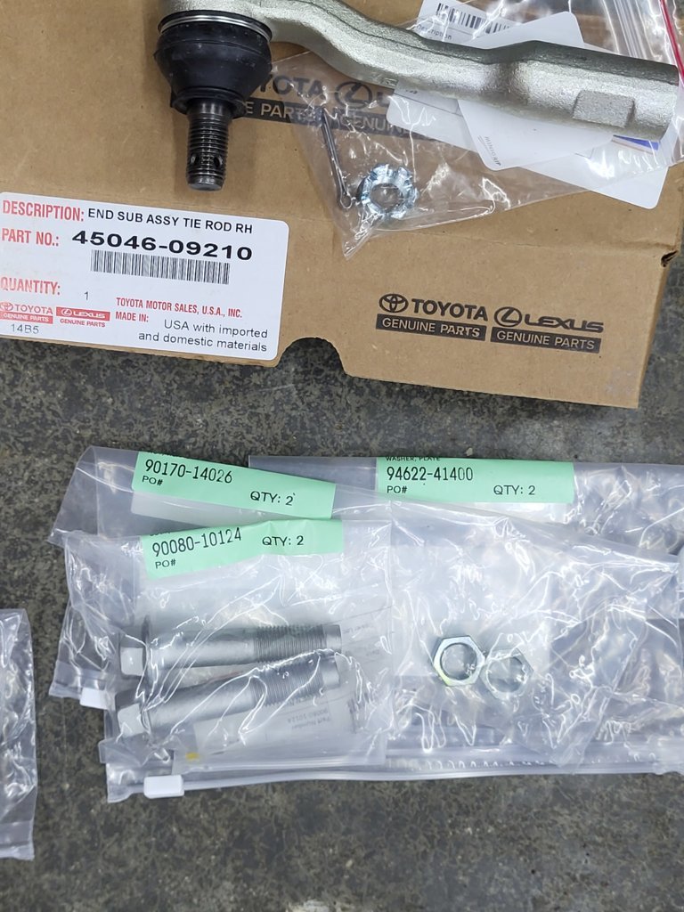

    Ok now I will post some pictures of the parts I finally got and the truck.

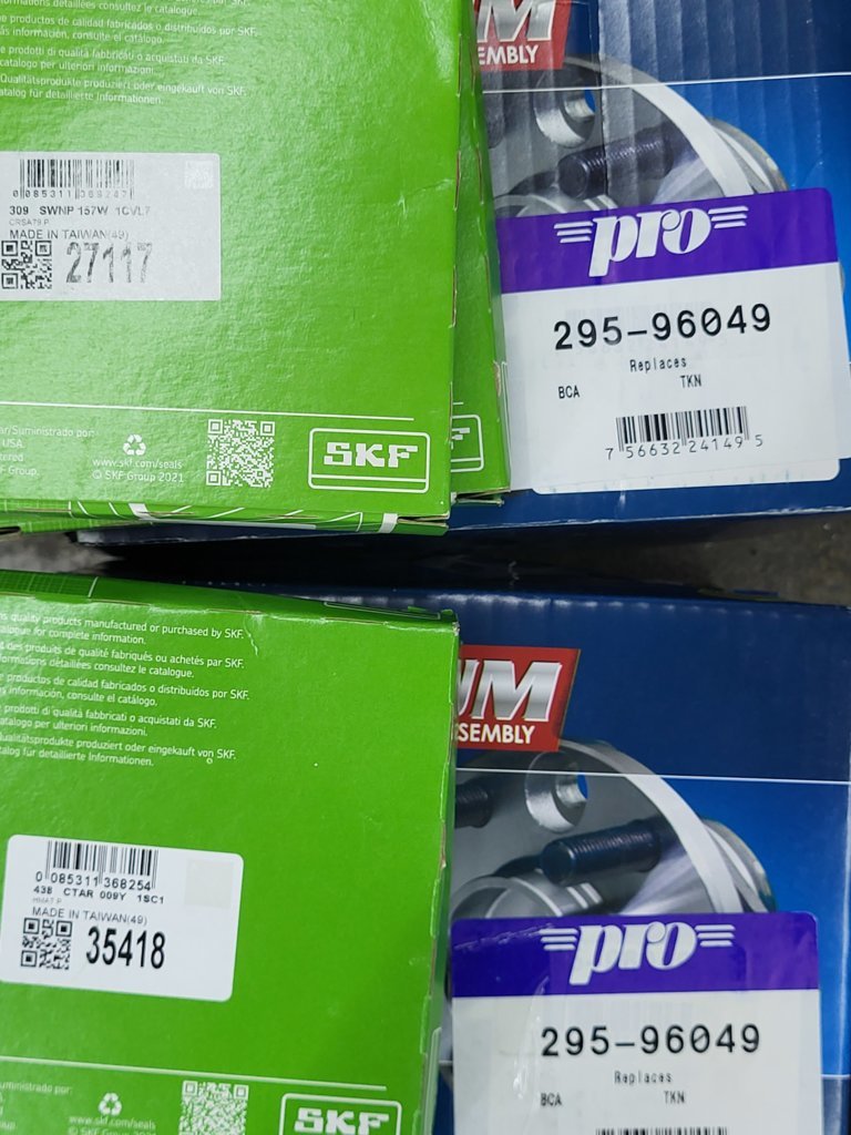

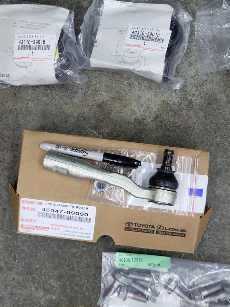

    20250613_172133.jpg Ok here are pictures of what I hope to install this weekend.
    And my special little helper.

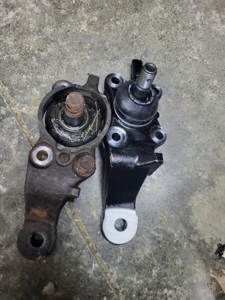

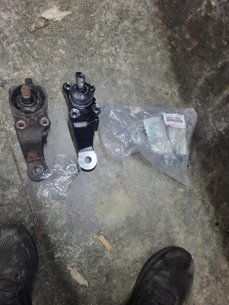

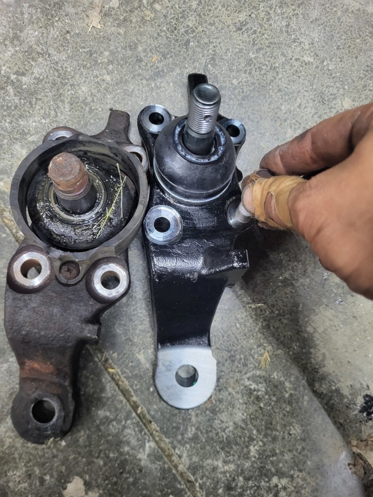

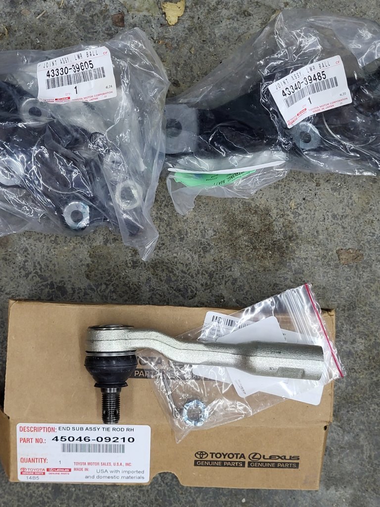

    So the lower ball joints are not the correct ones. I thought I ordered the correct ones. Did as much due diligence as I could. Im screwed at this point. I thought I ordered the bigger ball joint for an 04.
    Nope looked at order and the numbers match what they sent. Which were exact fit for my vin....
    All the other stuff is correct why they made this shit so difficult I'll never understand.

    Size of the bolt head is the typical indicator of small vs. larger LBJ on the '04s. 14mm = smaller joint, 17mm = larger joint. Going from memory on that. If the dealer won't let you return them (not sure who you ordered from), you may be able to recoup some of your expense selling them on the Marketplace here, once you reach the 50-non-spam post threshold.
    There's a sticky thread dedicated to correct LBJ part numbers: https://www.tundras.com/threads/lower-ball-joints-part-numbers.97100/unread
    The 2004 LBJ 'correct part number' info is in there, and this chatter on '04 trucks, IIRC.

    I thought they were bigger ball joints i ordered. But they were not. So for now its getting a car quest lbj... I will contact Serra Toyota where I ordered them from. To see if I can return them. But that will be after I get it put back together hopefully in a couple of hours. I got the bearing tie rod end and ubj installed. Just gotta get the rest put back together.

    Put the crapquest LBJ on for now but plan to replace it within a couple of month or you’ll regret it when your truck is destroyed.

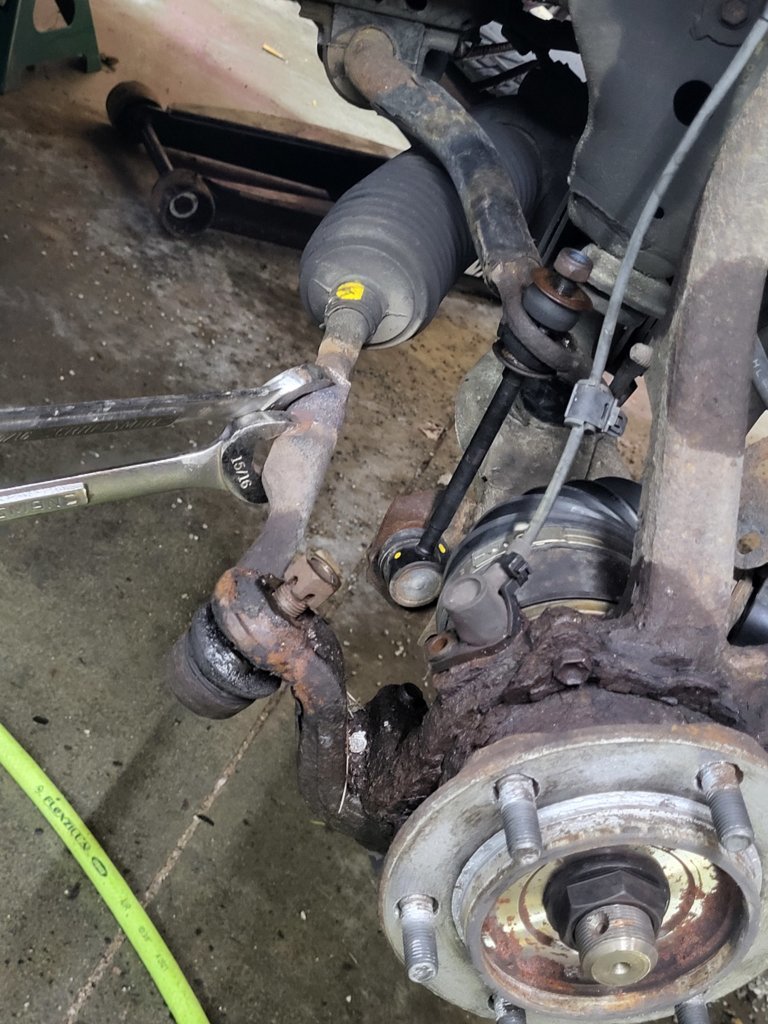

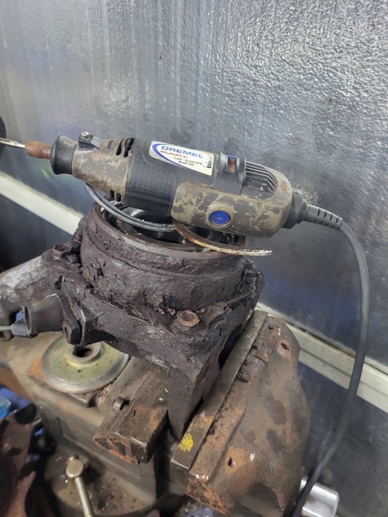

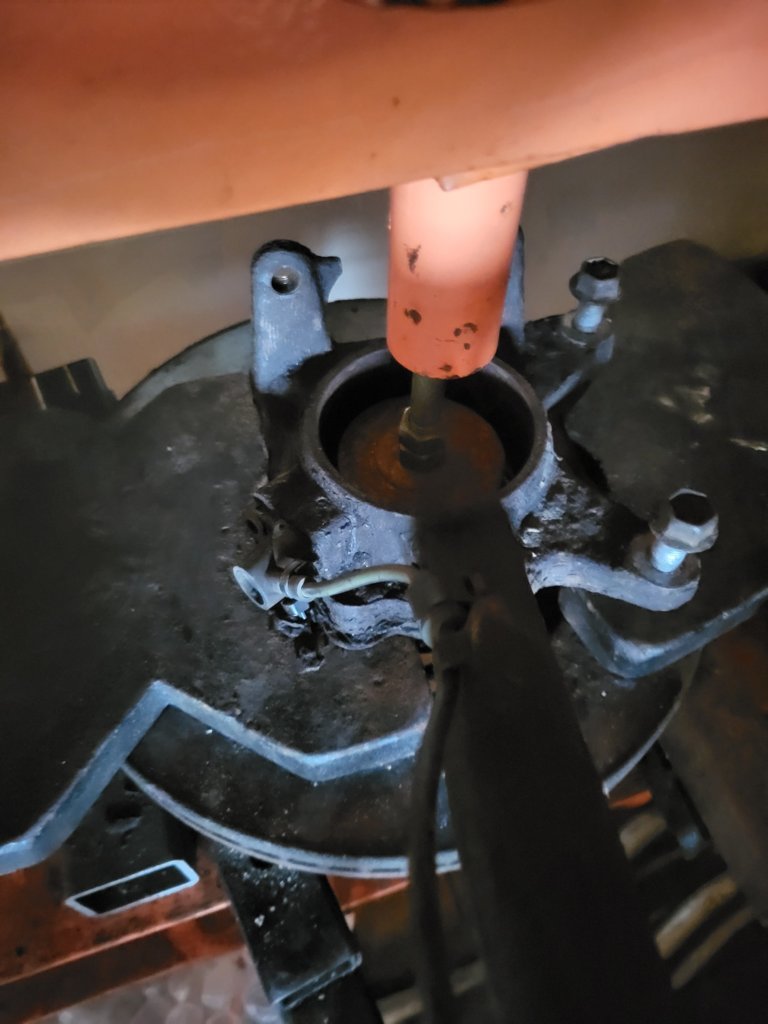

    So so far I have gotten the passenger side done. Lots of hiccups along the way and it definitely took me alot longer than I thought.
    Frozen cotter keys having to be drilled out snap rings having to be cut out instead of popped out etc. Following a poor information video on the press work for the wheel bearing.. luckily I didnt destroy the new one in hindsight.20250613_202454.jpg

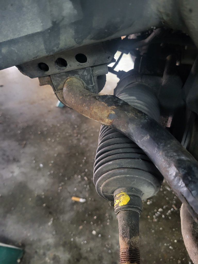

    Tie rod removal make sure you mark it so your atleast close on reinstall.

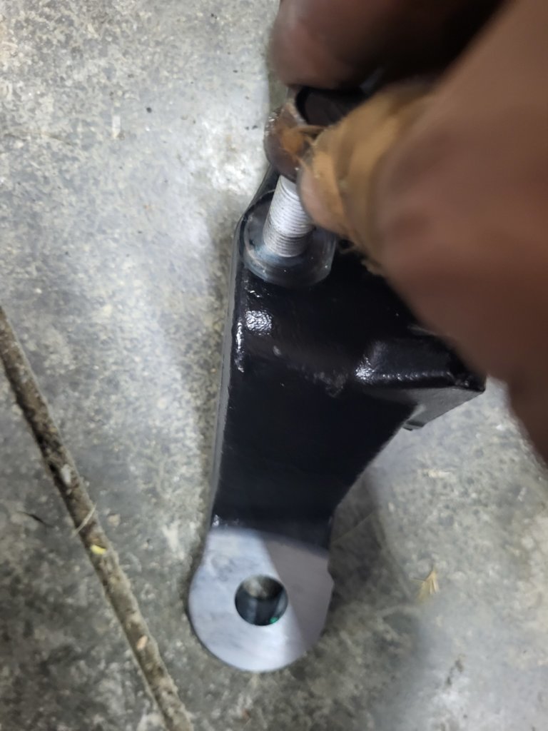

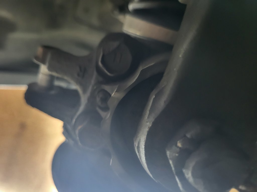

    20250613_230928.jpgdamaged bolt on lbj had to file the sides I assume it was hitting the lower arm when turned all the way to the left?

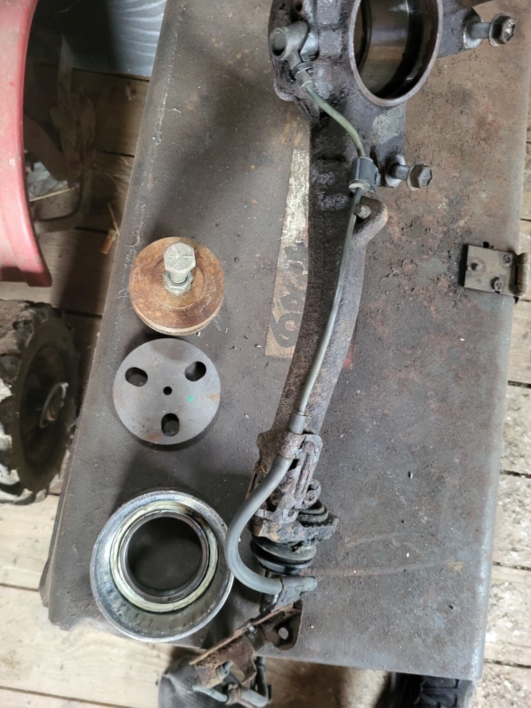

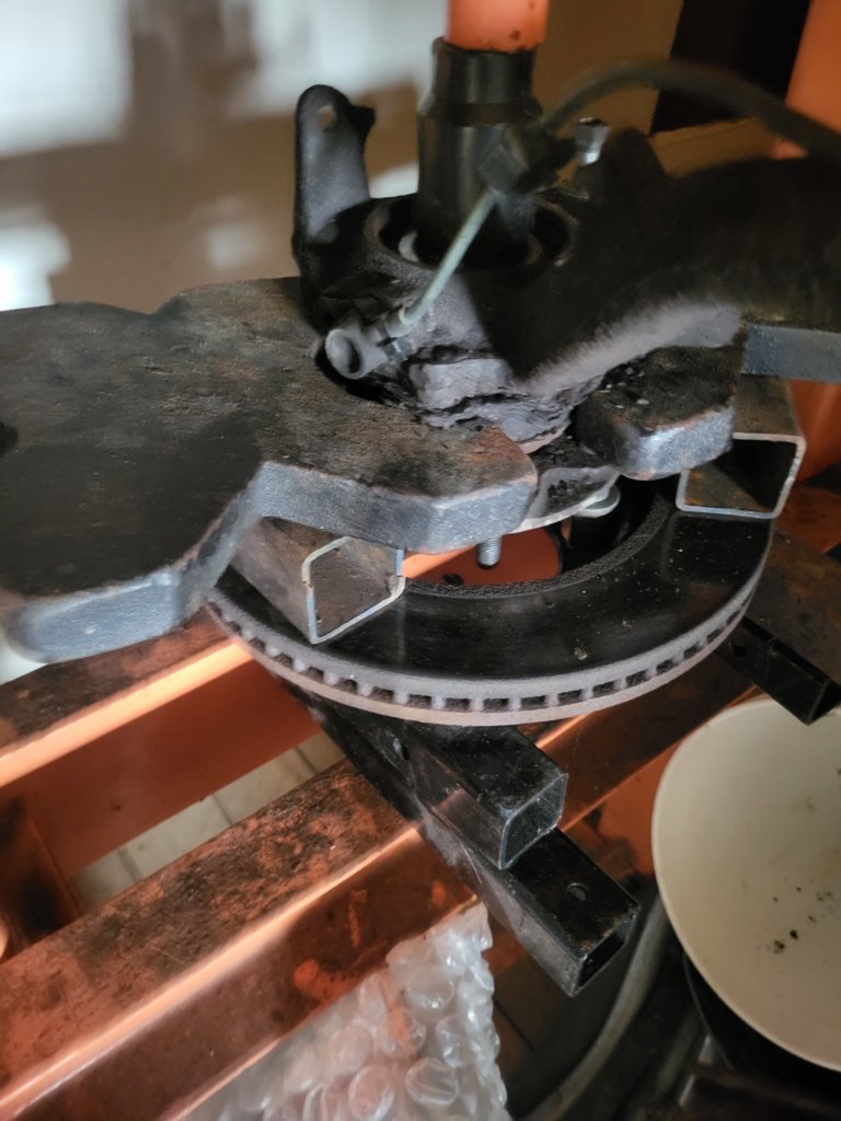

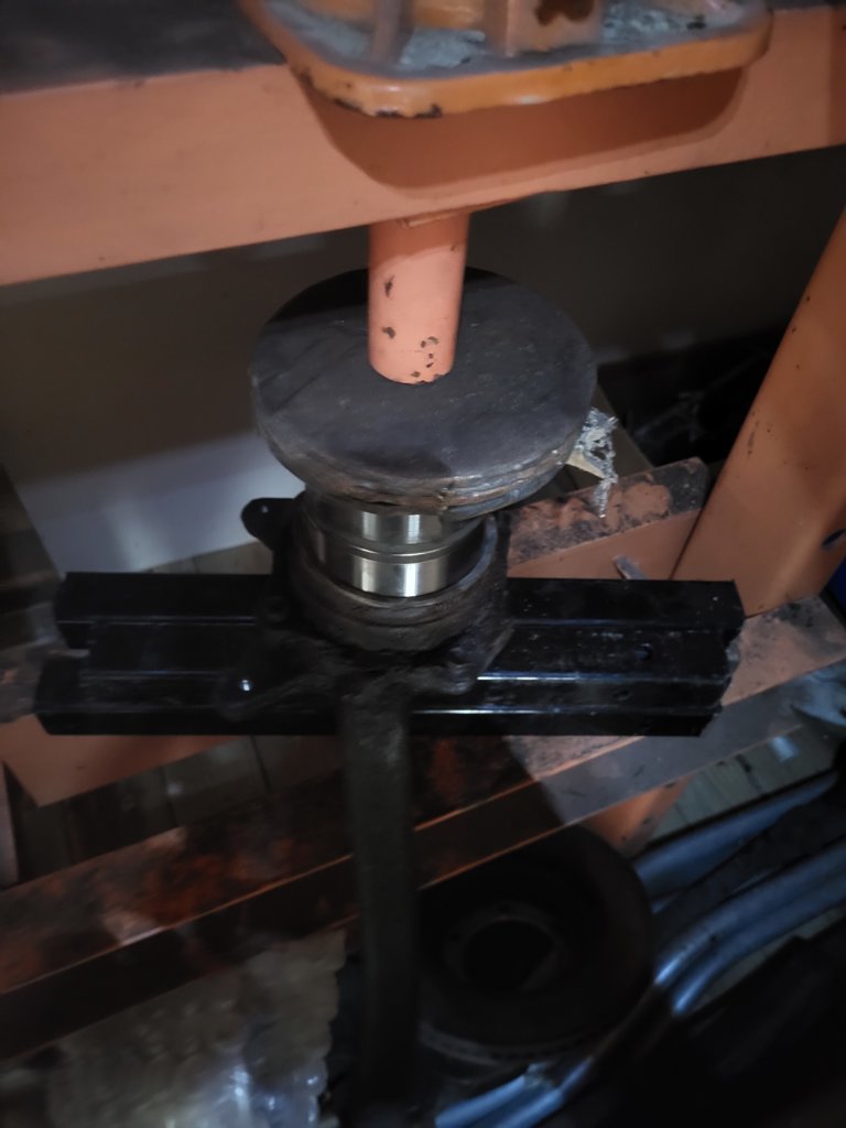

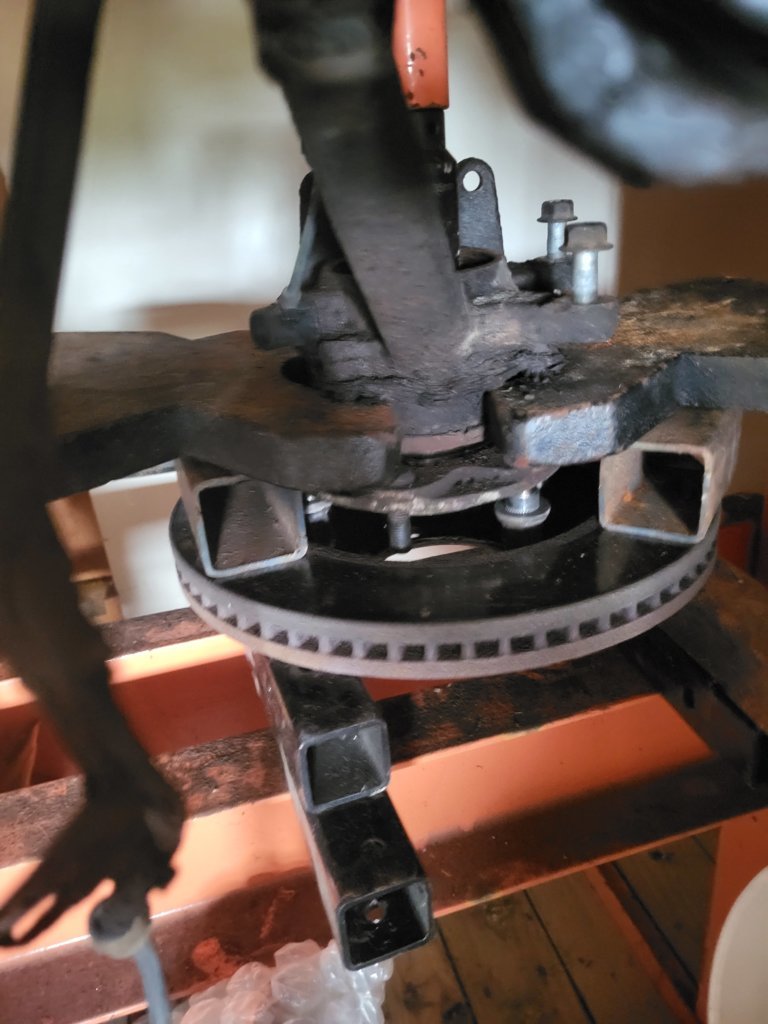

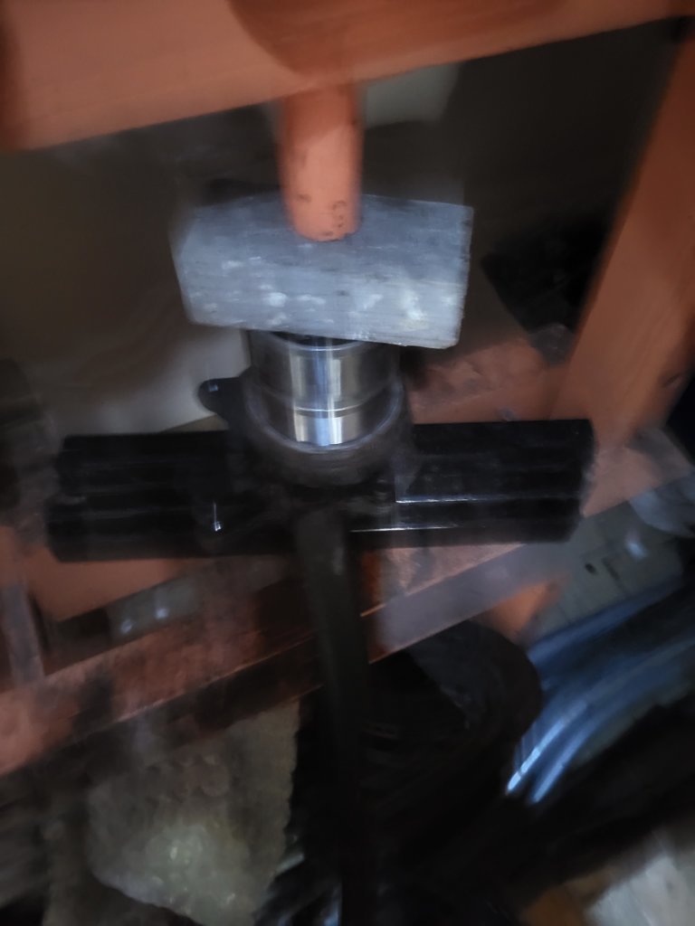

    Pressing out the hub you will need atleast 3" of block ups to hold your press plates. I ended up using 3.5" of material. After the 2" didnt work hindsight since I was not reusing hub I could have continued it would have just pressed out the studs.
    I used the old rotor as a base but put it on support tubes I've heard others say they have broken the hub.
    This would be much easier with another pair of hands and if my press plates fit around the hub a little better. Also watch your toes when it finally comes loose.

    Don't think I took picture of the 3.5" block up but same ides as shown in the other 2 pictures.

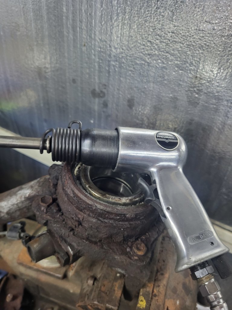

    Seal was pretty easy just use a chisel and hammer to knock it off.
    The snap ring was seized and I broke one of the pull ears just attempting to get it loose. So lots of pb blaster and the air hammer lightly punching all the way around the snap ring. Then take a cutoff wheel and notch the snap ring dont get into the spindle. After cutting a couple of notches I was able to chisel out the snap ring in peices.

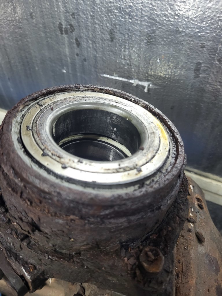

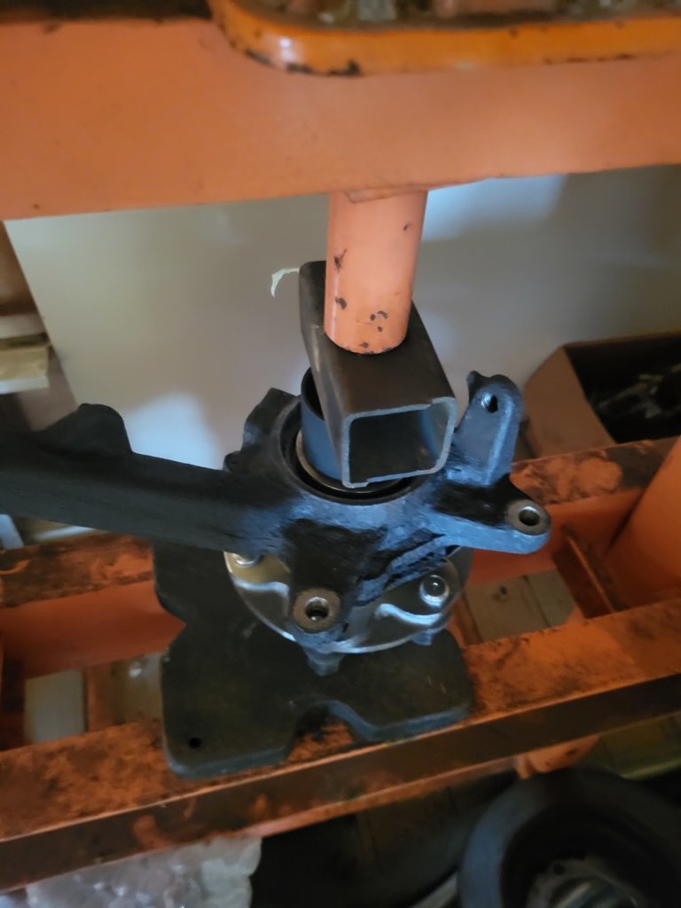

    To press out the old bearing You will need something round about 3-1/8" to 3-1/4" to I meant to figure this out and grab something or make it at work. Luckily I had something laying around that I could peice together.
    Thankfully this part isn't as bad setting up in the press.

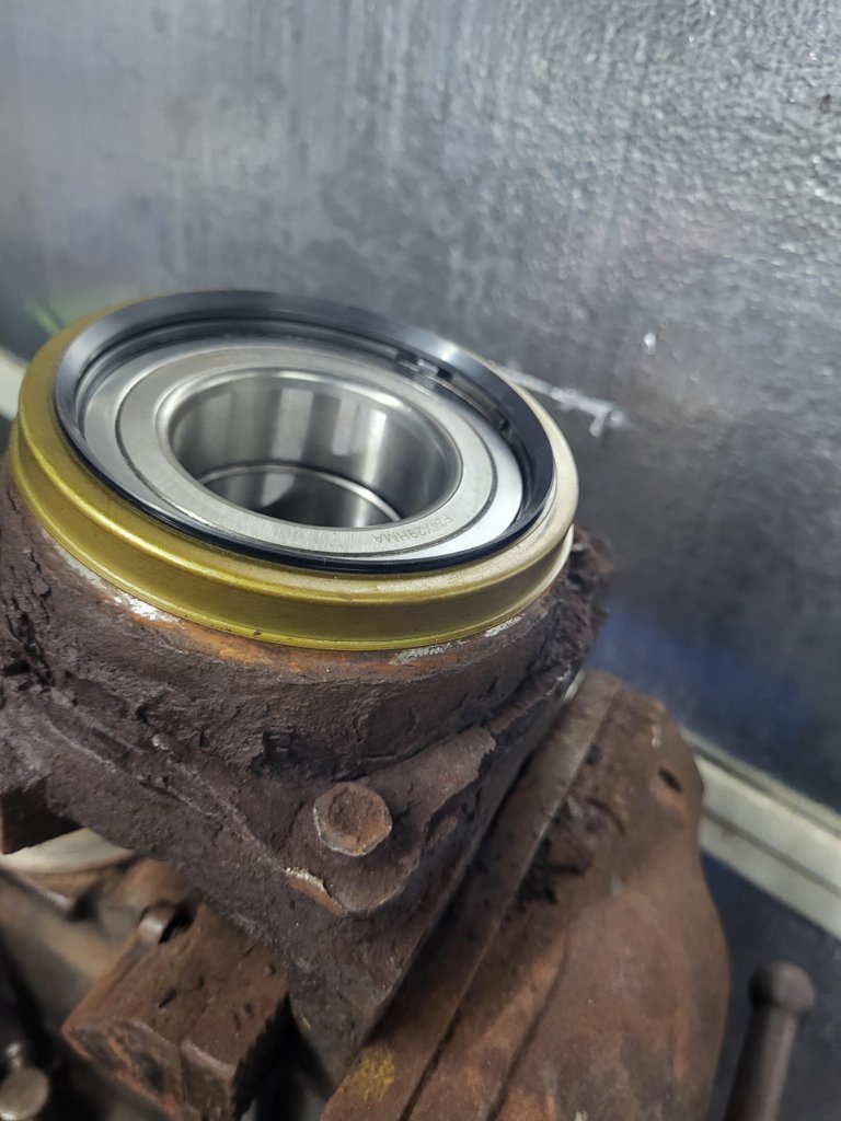

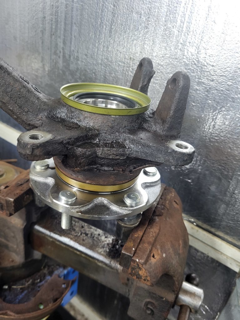

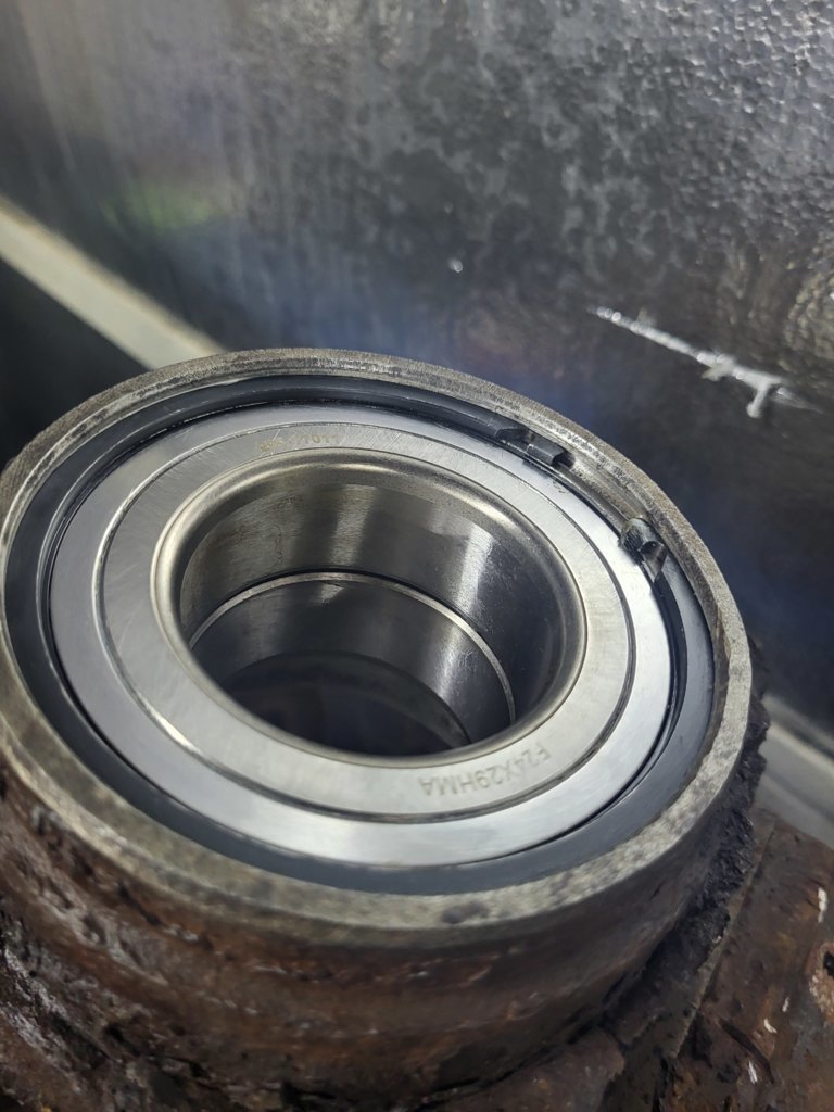

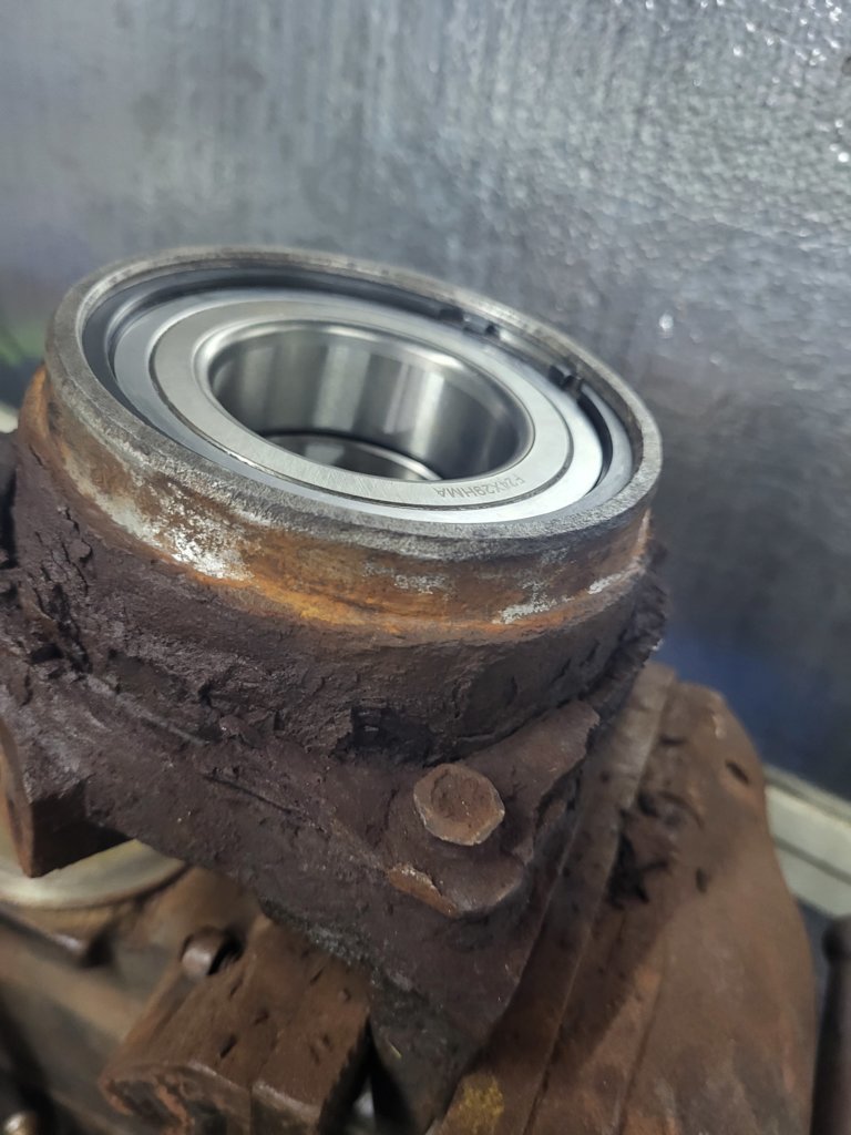

    Make sure to clean up inside and outside of where the seals get installed. I forgot to do one and had to grind the rust with the new bearing installed not ideal. Make sure you clean the snap ring groove well also.
    Use the old bearing to press the new one in. I will also note that a 20 ton HF press does not like this job. At a few points during removal I thought I was going to have to take it into work and use a bigger press.
    20250614_212715.jpgwhere i forgot to clean the rust...
    20250614_212833.jpg just tap the seal on with dead blow be careful and don't hit the rubber part.

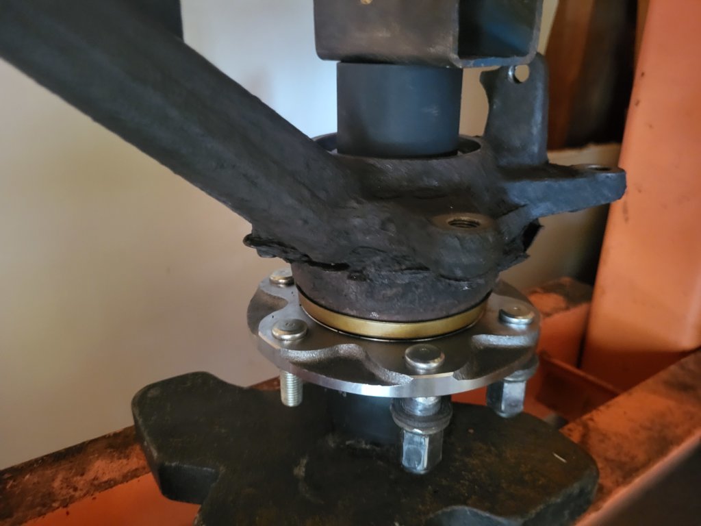

    I forgot pictures of pressing the hub back in. Thankfully I didnt ruin the new bearing as I did part of that process wrong make sure you support the bottom half of the bearing not just the spindle.
    While pressing in the hub. There is potential to destroy a new bearing because there is 2 halves you need to support the bottom half.
    Also after the hub is pressed in you need to install the abs ring then the spacer then press the spacer in. I didn't press the spacer in the first time careful what videos you watch.
    I thought I destroyed my new bearing as when I put it back on it wobbled bad. Watched a diffrent video before I lost my mind.
    This video is much more informative than the first one I watched.
    https://youtu.be/_Yy9-VLahbA?
    It saved me from tearing out a good bearing.
    I ended up having to buy a HF ball joint press kit just for the cups. They are probably not Ideal but in a pinch it worked out to do the spacer and the UBJ with the spindle out. I swear I have more round stock somewhere but couldn't find it.
    Thought I took pictures of doing the UBJ also but must not have. Pretty easy if you have cups for a ball joint remover or proper sized round material thats hard enough. I did it with spindle off in the press. Wasn't bad other than the ridiculous snap ring design with the pointed ends that don't work in your favor.

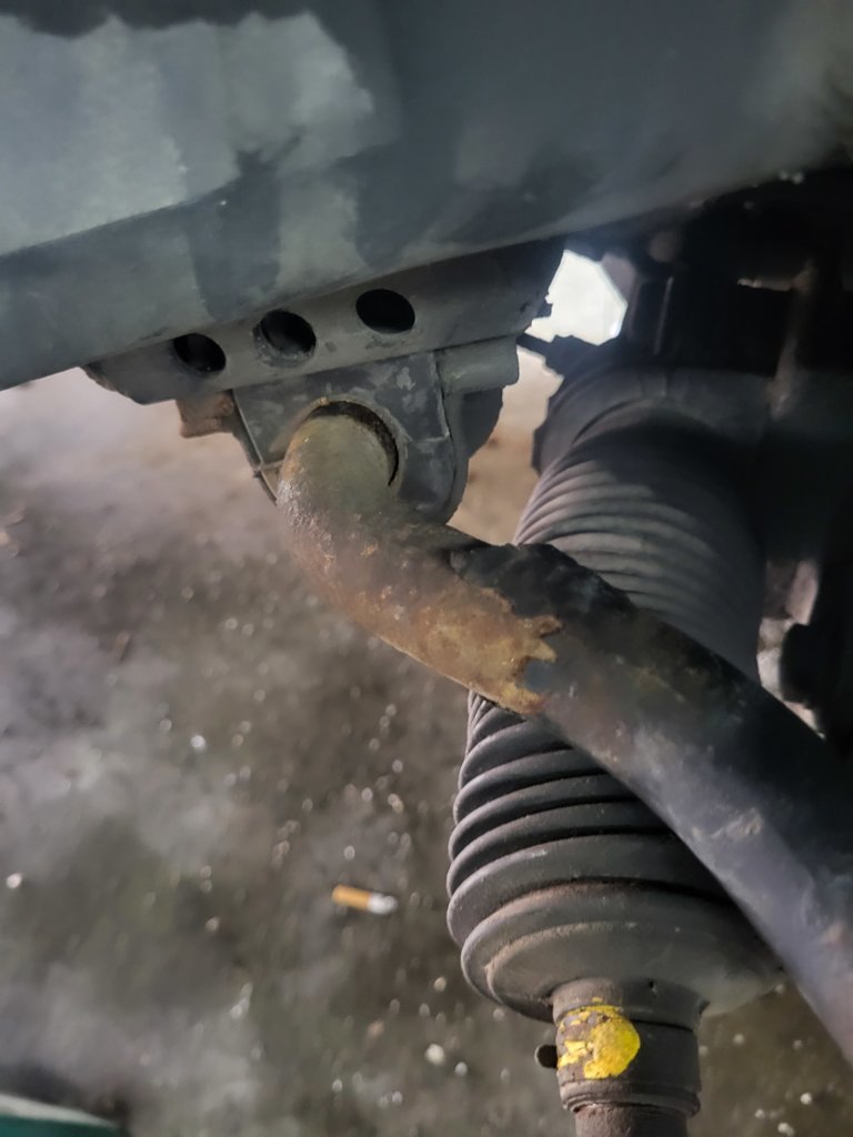

    Discovered another issue today when reinstalling the spindle. I need new sway arm bushings that hold it in place. Ouch im sure this is contributing to some of my sloppy steering issues.
    Well thats all the updates I have for now the passenger side is done other than getting another new oem LBJ when I can get that sorted. She made it into town and back things are better feeling than before.
    I will tackle the drivers side when I have proper LBJs as I dont want to disturb it until then. I was hoping to have both sides done in a weekend wow this job is very time consuming and you better have alot of tools. Torch recommend it did make life a bit easier on a few things.
    A 1/2 " impact or big cheater bars are a must for some things.
