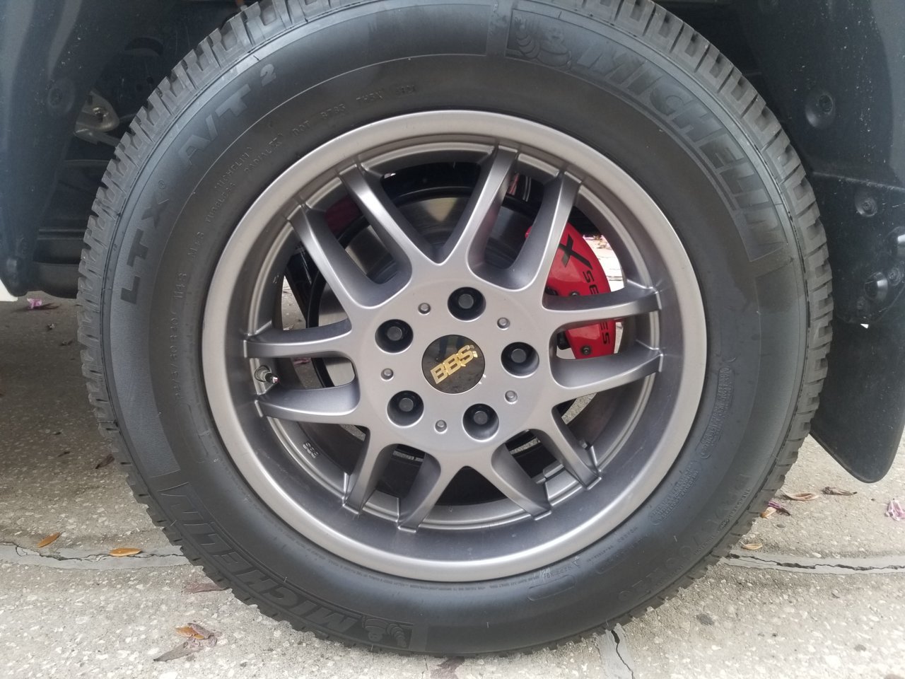

    I did the same but hand painting was a PITA...although I read somewhere that it lasts longer than the spray paint:

    Few comments if you decide to paint with the Duplicolor kit:
    - I learned the hard way not to remove the calipers to paint as recommended on the box. This paint takes FOREVER to dry. Tough to handle wet calipers to re-install and drive the truck. Mine still felt tacky after a day.
    - Extra paint brushes are needed and the single one in the kit isn't enough for all (4).
    - Use gloves as this paint is very difficult to wash off your hands.
    - Good lighting is very important.
    Best of Luck.

    I only messed up on one rear caliper, but found a way to reinstall/repaint spots while still wet. I waited until the next morning to drive, so about 12 hours before I was using my truck again. My paint was still tacky, but it wasn't raining and I wasn't too worried about much dust, dirt, etc. sticking to the tacky paint (and I didn't notice anything after the paint dried). I did set-up a portable electric heater blowing on the caliper after I painted each one and was working on the next (for about 1 hour) to accelerate the drying time, but think it was around 2 days before the paint didn't feel tacky anymore. Area temps were running in the 60's when I painted mine.
    YMMV.
