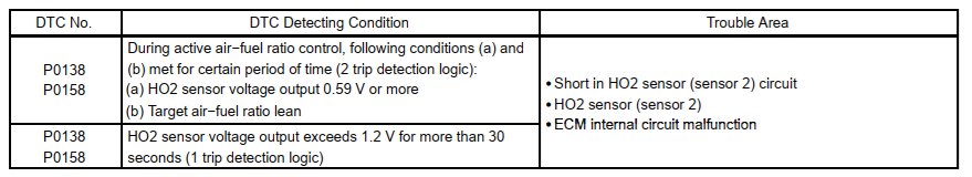

    It seems to be affecting the downstreams, the upstreams are reading a relatively expected ~3.3V most of the time (bc the fuel trims clean up the problem after a few seconds upon detection), but the downstreams never fluctuates between .1 and .9 as expected, just stick around .85V and .95V respectively. When driving under certain conditions I can watch them go down to more expected values for a moment, but on normal driving they aren't acting right.
    I checked the FSM and it has you replacing the heated O2 sensor two separate times before you even are mean to check the resistances between pins. Let alone check for shorts and otherwise. I'm just hoping someone has run into a situation like this before on this platform and might know of any gotchas besides just tossing money at O2 sensors.

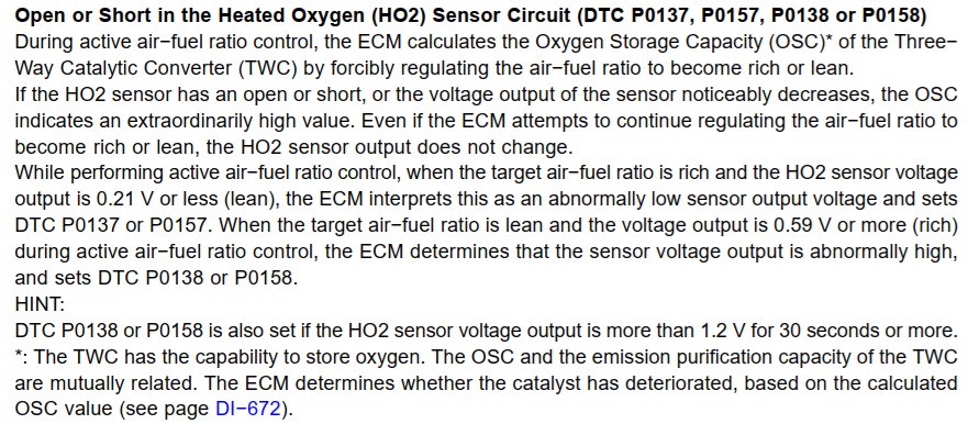

    Updated my reply, had a pre-coffee moment on the codes. But yeah, I see what you're saying about the DTC in FSM, 'Trouble Area' indicated.
    I think the key text is here, maybe not so much the "HINT", but the 2nd paragraph. You just had the "lid" (intake) off the top of the engine. It could suggest leak (if lean) or a fuel dump (if rich), knowing both the fuel lines and the intake manifold gaskets are potentially impacted by a starter job. While you can't easily check the gaskets, "rich" would be your issue here, so i'd be checking: Fuel rail connections, every fuel line joint is tight, all vacuum hoses attached to the fuel pressure regulator(s) are attached.
