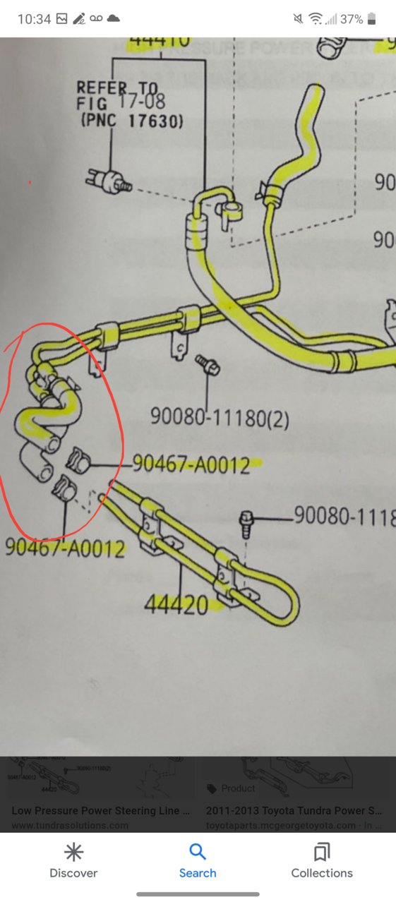

    Is this a hose i can buy anywhere? It looks like its attatch my a couple clamps. Easy to replace. Just not sure if its high pressure or special type. Thank you

    The Toyota parts catalog will have the part number, likely in one of the 'more images' for the parts section.
    If you want me to track down the part number so you can just order online or pick up at the local dealership and keep it OEM while removing all questions of whether it'll work, let me know the engine (V6/V8) and the cab type (RC/AC/DC).

    It’s 10 mm hose but you can’t even get it from Toyota since the sell it all as a $400+ assembly. Since it’s the return line you can use 3/8” hose and stretch it over the hardline and use quality hose clamps to keep it in place. That’s what I did for the entire return line down to the hard line that ties into the rack.

    Thank you. Its my girlfriends rig. I will replace these hoses and see if it stops the slow leak.

    I forget what company sells one, but I think it’s on RockAuto and is much cheaper than the OEM, but I think one of the lines is reversed and you have to swap it.
    I have a few slight leaks in my hose, but I’m going to wait till it gets really bad, as it looks like a PITA to replace.
