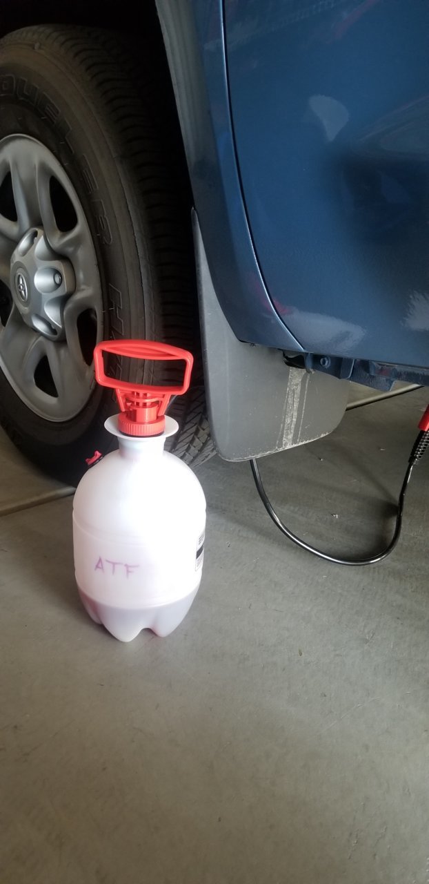

    For anyone interested, I spent a lot of time on Tacoma World and learned a few tricks. A modded garden sprayer from walmart beats a hand pump when filling the transmission.

    That sprayer looks awesome , I like it .
    About how much fluid are you adding when doing the drain and fill ?

    I added 1 gallon. After comparing the amount drained vs amount filled, I determined I was 1/2 qt low from the factory.
