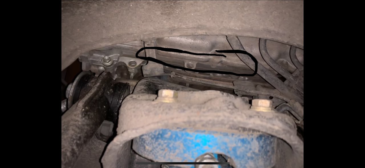

    Peek through your front wheel well openings and look here
    (I circled the area in black - if that area is wet - then that’s your cam seal tower leak). Toyota fixes the issue without any cost to you.
