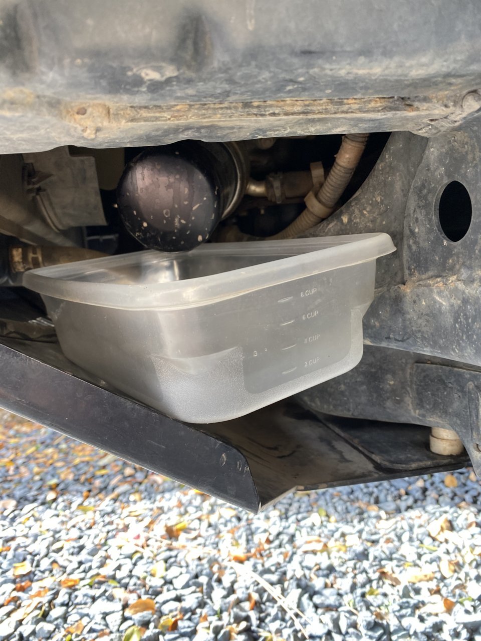

    Agreed. I just put this on and will never take my skid plates off for an oil change again. What a PITA it was. For filter, I cut out a bin to fit above the skid plate to capture most of the dropping oil from the filter when I change it - again, not removing skid plate.

    Very happy and pretty quick, especially when warm. I am able to put a medium Tupperware under the filter. Only use one blue towel per oil change just to wipe excess oil from the tube and Tupperware.

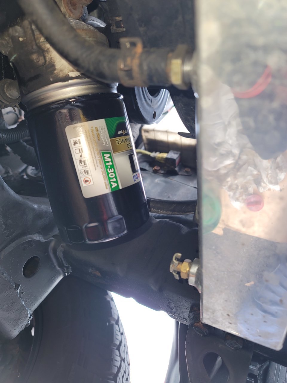

    Speaking of oil filters I started using Mobil 1 M1-301A it fits perfectly same size gasket just triple in size. Always fill filter with oil before installing just good practice.

    Yeah, seems considerably larger than stock, seems like a good candidate for my climate. I'll have to keep an eye out for when they get more in stock.
