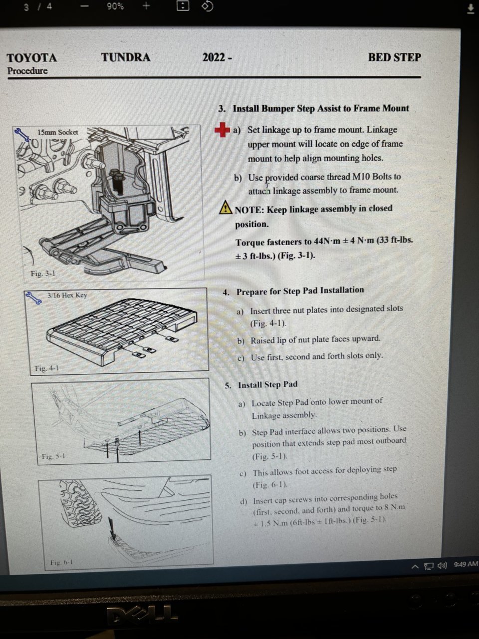

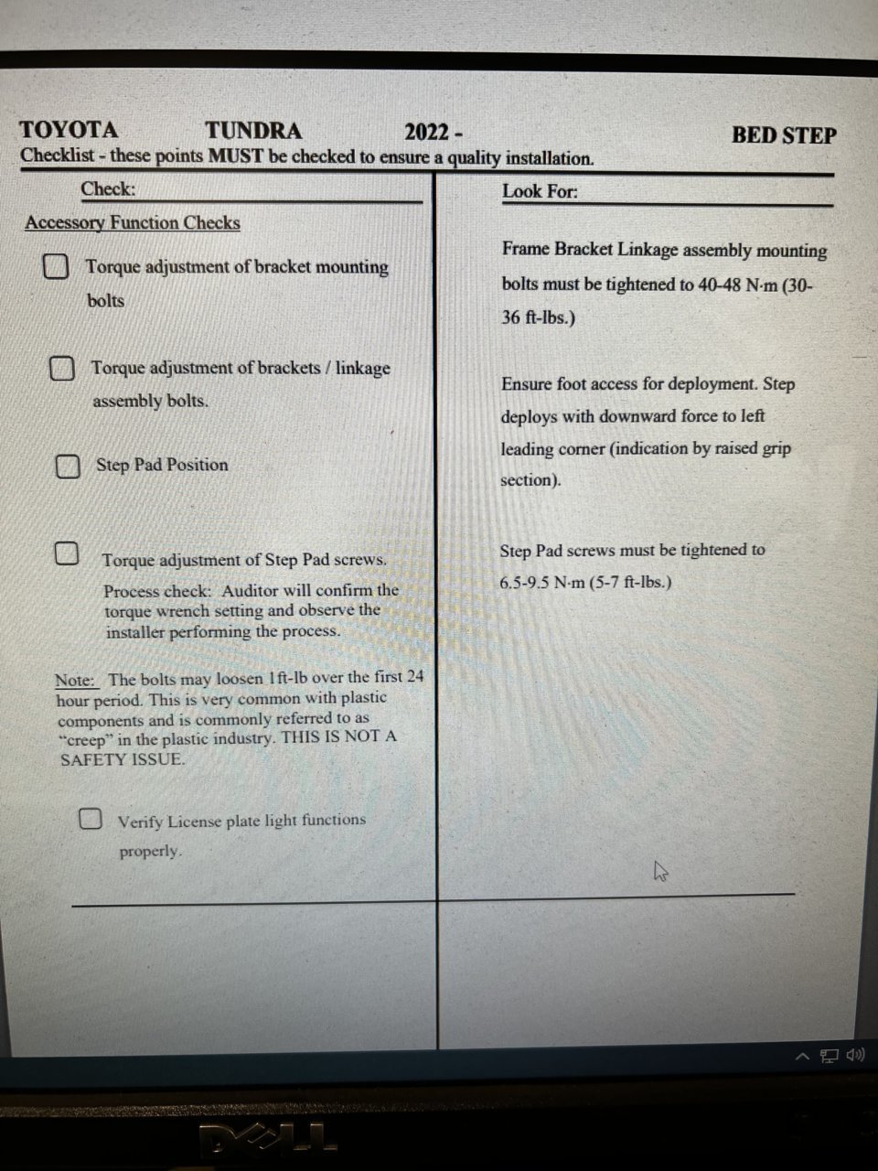

    Anybody got the pdf installation instructions for installing the OEM bed step?
  18. Jun 9, 2022 at 11:37 AM
    ByeF150HelloTundra
    ByeF150HelloTundra New Member
    Jan 18, 2022
    #73299
    272
    DFW
    2022 Tundra SR5
    https://youtu.be/3sv9VckzWQY
  19. Jun 9, 2022 at 11:46 AM
    TSS Army Green
    TSS Army Green New Member
    Mar 14, 2022
    #75838
    148
  20. Jun 9, 2022 at 11:46 AM
    chiefbob
    chiefbob New Member
    Mar 18, 2022
    #75980
    22
    Here ya go

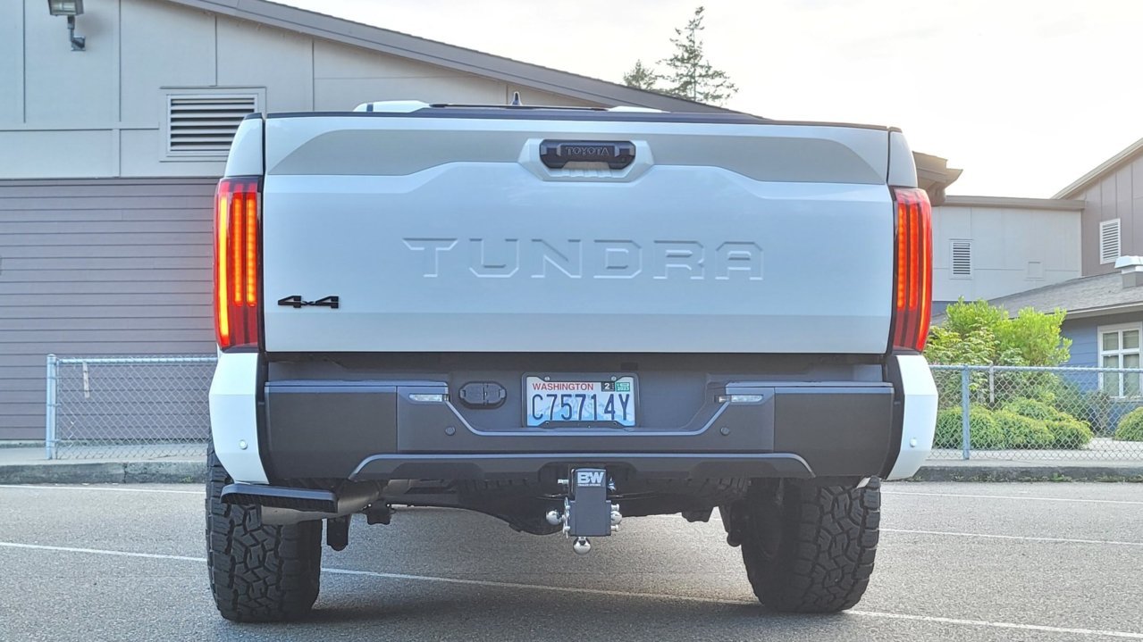

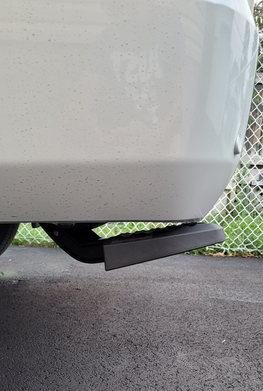

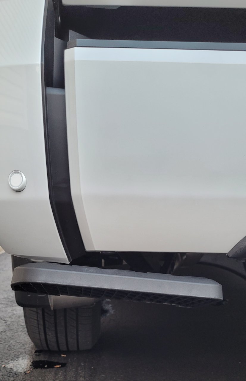

    Are y'alls bed step at an angle once completely installed?
  22. Jul 21, 2022 at 6:07 PM
    ToyoTundra89
    ToyoTundra89 Member
    Feb 11, 2022
    #74475
    342
    Seattle, WA
    2022 Tundra SR5 TRD OR CM 6.5
    Same. Comes like that from Toyota. Took some time getting used to for me as well.
    jproy12[QUOTED] likes this.
  23. Jul 21, 2022 at 6:10 PM
    jproy12
    jproy12 ¯\_ (ツ) _/¯
    Feb 10, 2022
    #74396
    271
    JP
    Ottawa, Canada
    2023 Supersonic Red Platinum Hybrid
    Thanks, checked and double checked my install and wasn't sure if I had done something not correctly.
    murtro likes this.
  24. Jul 22, 2022 at 5:51 AM
    #24
    chiefbob
    chiefbob New Member
    Mar 18, 2022
    #75980
    22
    It’s the way it was designed so when it’s extended it will be a flat surface.
    Still doesn’t look right when it’s stowed.
  25. Jul 22, 2022 at 5:54 AM
    #25
    jproy12
    jproy12 ¯\_ (ツ) _/¯
    Feb 10, 2022
    #74396
    271
    JP
    Ottawa, Canada
    Thanks, and agree, just doesn't look right when stowed, but again, everyone is in the same situation

    Also note the manual bed step is lower to the ground than the power (electric) bed step... That's a bummer too. Not even midway on stock truck, will need to lift truck a couple inches to equal out.
