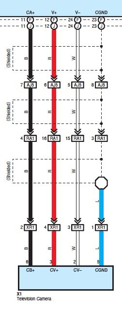

    EDIT - This diagram is for 3rd Gen trucks. See the next post for 2013 camera wiring...
    First of all... EMI sucks! and it's hard to troubleshoot. But based on your description of the problem, I would start by looking at the XR1 connector. Its a connector that serves as the disconnect should you wish to remove your tailgate. It's located under the bed just forward of the rear bumper.
    The 4 pins of interest are Power (CB+), Video +, Video -, and Ground. The shielding on the harness run is connected to the ground pin (pin 5). See diagram.
    You said the camera works fine when the tailgate is down (i.e. less "stress" on the harness) so I would first check the harness slack with the tailgate open and closed. There should be no tension on the harness in either position. Then check to see that the pins are properly seated in the XR1 connector; especially the ground pin. Then finally, check the shielding continuity to XR1 Pin 5.
    That's where I would start based on your description. Good luck!

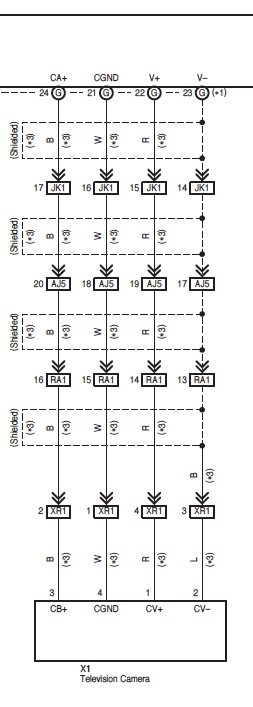

    Aghh.. Just realized you have a 2013 truck. The troubleshooting approach above will work but there are 3 different 2013 camera configurations; No Nav, Nav with internal amp, and Nav with External amp. They all have different connections at the HU/Mirror Display but the camera end of the Video harness is pinned the same in all three configs. This pic is for a Nav system with external amp. The shield is tied to V- (XR1 - Pin 3 or camera pin 2) in the 2013 trucks.

    Thanks for the diagram. I don't have NAV or JBL. I will check continuity on from the connector to pin 2 for my truck. I can tell you with the camera unbolted from the tailgate but still connected to the XR1 I see no change when I move or or flex the wire harness.

    OK. So that means your camera display is in the mirror? If so, your diagram is below. You might also try checking the continuity or resistance between CGND and CV-. And check the continuity from the cam to the mirror for the ground and CV- lines.

    Thank you TundraTex. The wire schematic was helpful to understand the breaks in the harness. I am seeing the same issue on my 2013 Tundra. When I put in reverse, I get the blue screen, a flash of camera, then disappears. If I put the truck in reverse and move the tailgate up and down, I get some response but it doesn't stay on. I figured it was the harness that ran through the tailgate to the connector just ahead of the back bumper so I ordered one from Toyota, no luck. I found an aftermarket camera on ebay for $100, cleaned all the connections in the back of the truck, installed, same result. Truly sounds like a grounding issue or perhaps a broken wire/interference. Since this problems is repetitive with several other postings, I'm wondering if anyone found the smoking gun? Any insight on where to go next is appreciated.
  19. Apr 29, 2021 at 10:24 AM

    Follow up to my earlier post regarding the backup camera. I took the truck to a Toyota dealer and they were able to track the issue down to a ground wire in the harness. Replacing the full harness would be thousands of dollars so I ran a jumper wire from the tailgate to the wire cluster under the hood. Basically the blue wire in the tailgate, along the frame, up the engine compartment, into the plastic box on the passenger side and clipped a black wire to patch the new connection. Camera works great again. Took about an hour and half to tie everything up properly but way cheaper than an aftermarked setup.
