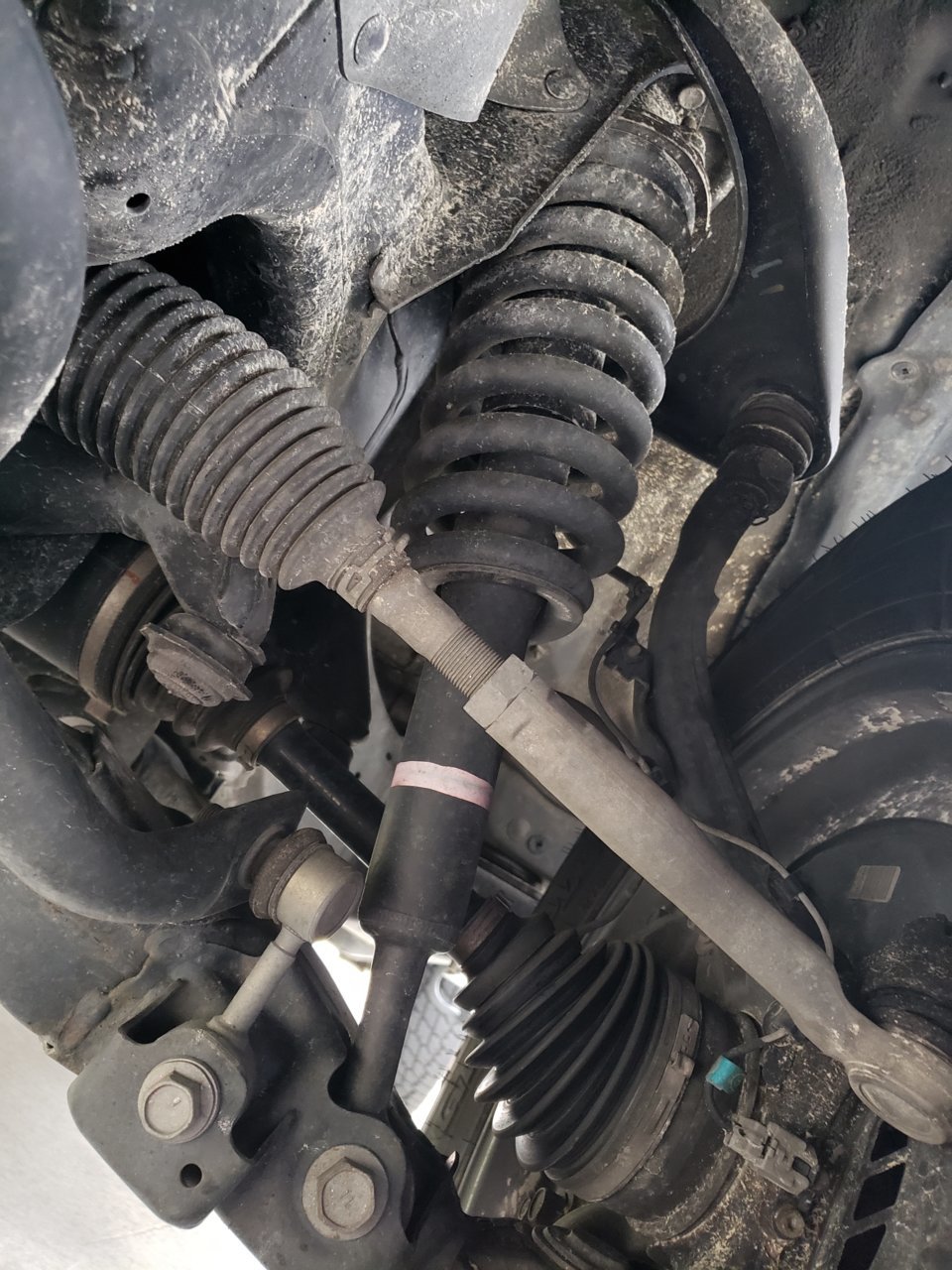

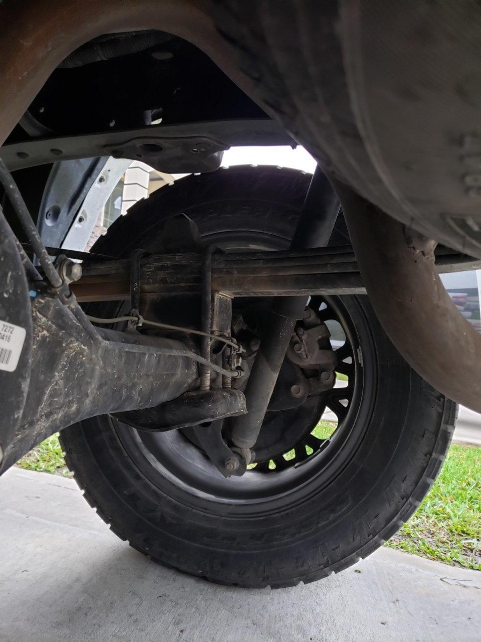

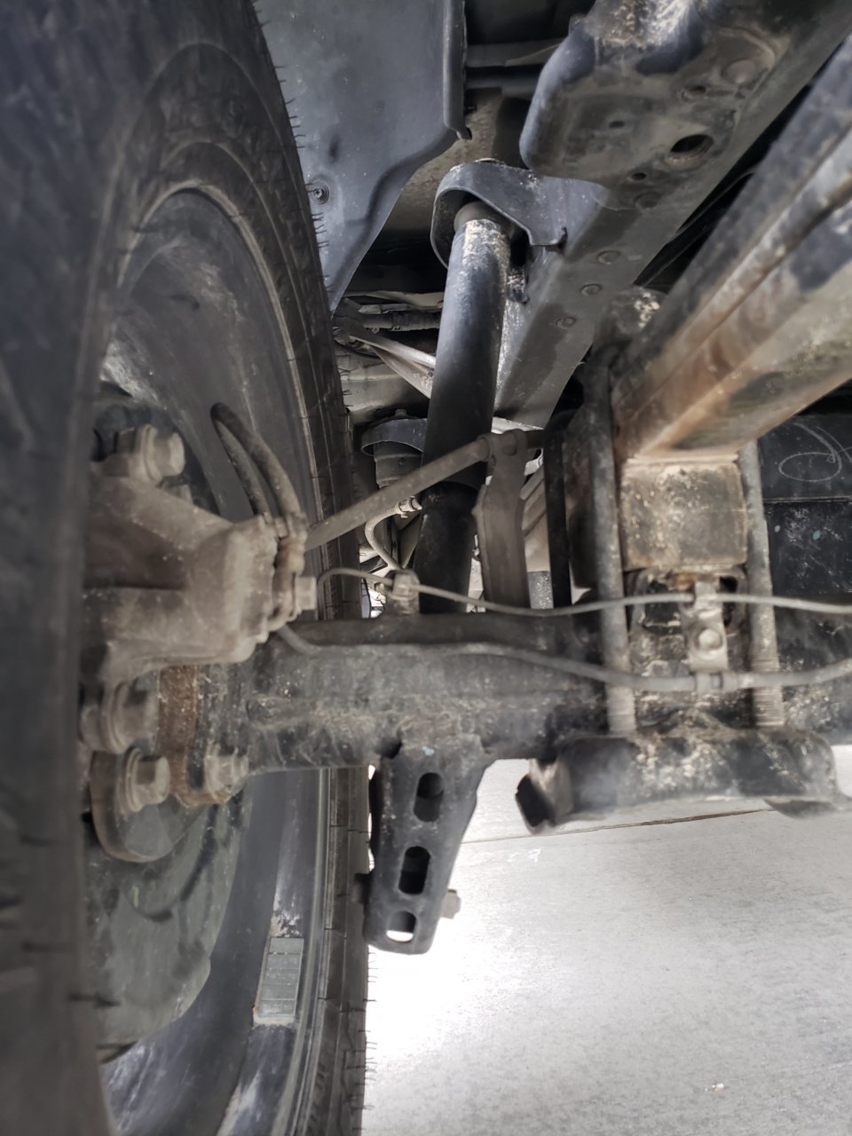

  8. Apr 6, 2019 at 5:56 AM
    LoneStarTundy
    LoneStarTundy [OP] New Member
    Apr 5, 2019
    #28688
    10
    Richard
    League City, TX
    2016 Whited Out
    unclear at this time

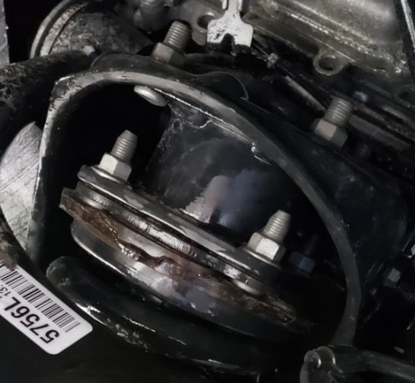

    UCA still has factory sticker. it's a stamped steel part.
    And i see spacers on the rear. please let me know what else i have under there, if you can tell.

    Block in Back is correct. Prolly a 3 in.
    Many call this a "Block & Spacer" lift or Lift/level if truck sits level. This type is a more affordable lift, not really ideal for ride or off road but generally ok for pavement.
    This guy here is the front spacer.
    JH5370 and LoneStarTundy[OP] like this.

    Trooper2 and LoneStarTundy[OP] like this.

    '17 SR5 CM TSS 4WD MGM 5.7 FF
    Lost track after #1.
    Looks like someone threw spacers on a stock suspension.
    LoneStarTundy[OP] likes this.

    Great...thanks for the post.

    Thanks. I didn't recognize that as a spacer, but i see it now.

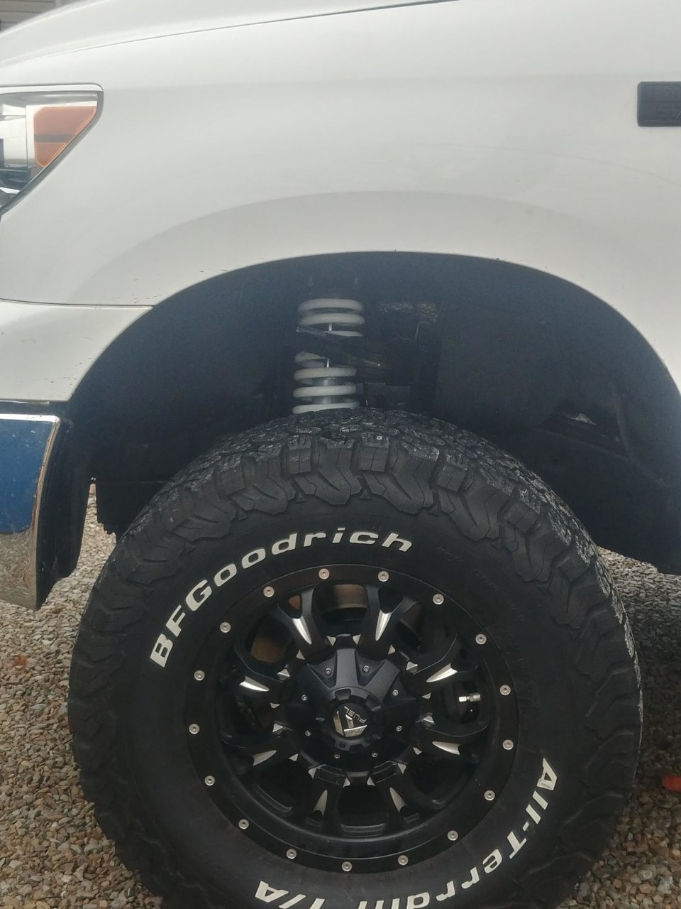

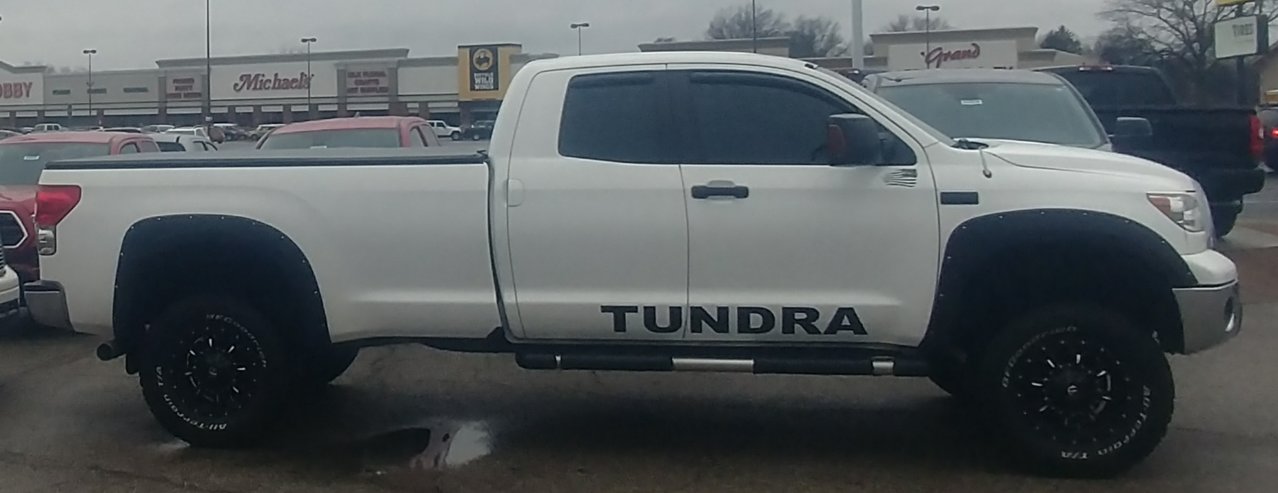

    Truck is looking good I'm on the same kick with the black and white scheme . Screenshot_2018-12-27-15-28-51-1.jpg
    Also I just did some white coil springs on mine. Sets it off a little.20190206_152551_HDR.jpg
