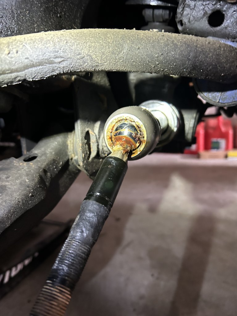

    -ECGS front diff bushing and diff seal. Bearing looked fine, but I was getting the whirr noise at low speeds that would go away in 4HI. Replaced and the noise is gone.

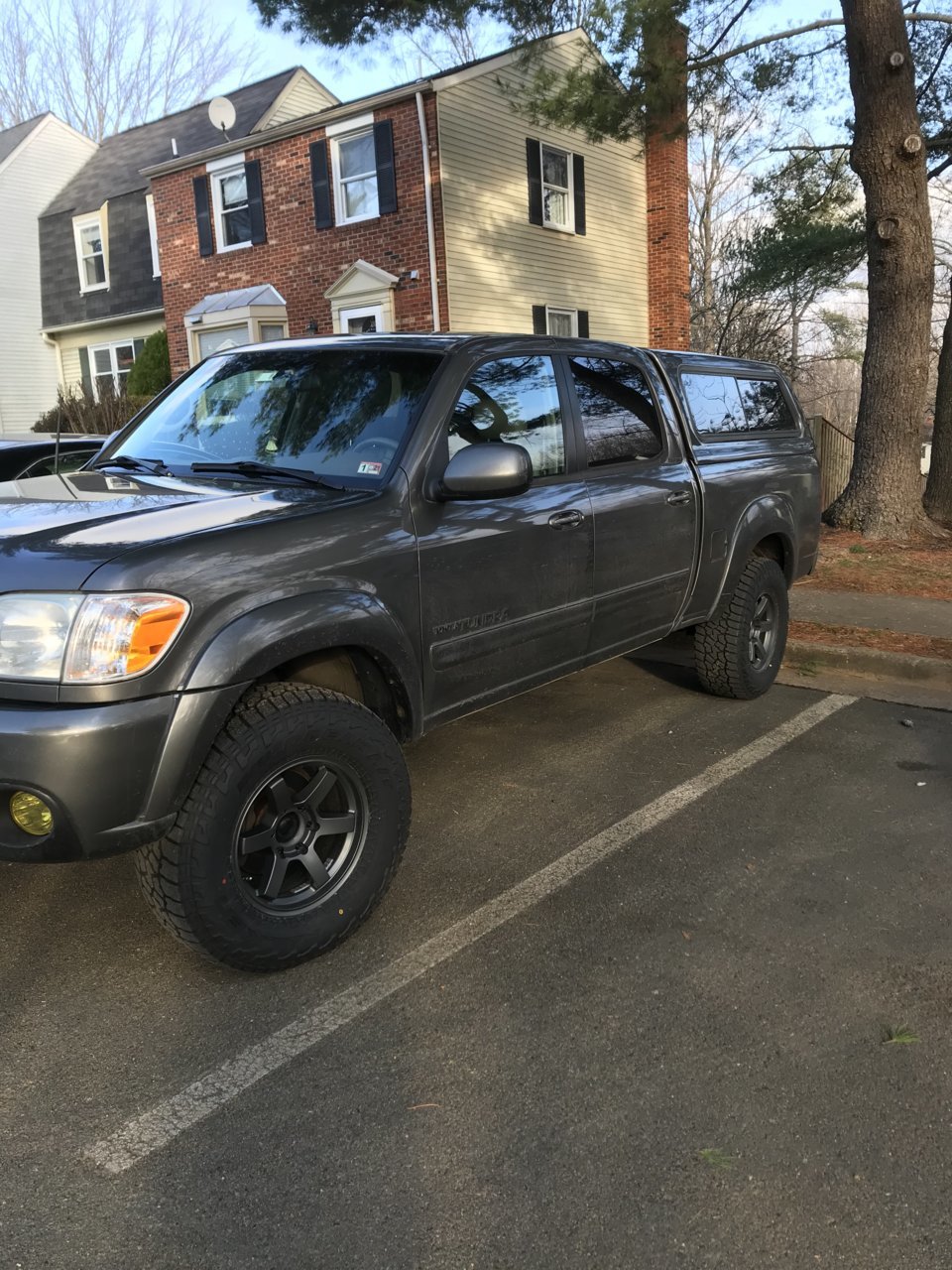

    As she is now:
    Day I got her next to what she replaced. Never realized how narrow the Frontier was.
    Scored a color matched Leer shell on FB from a guy with same truck as me for $400. Not the best deal, but it had keys, third brake light, sliding windows with screens, and had the skirt overhang I was looking for.

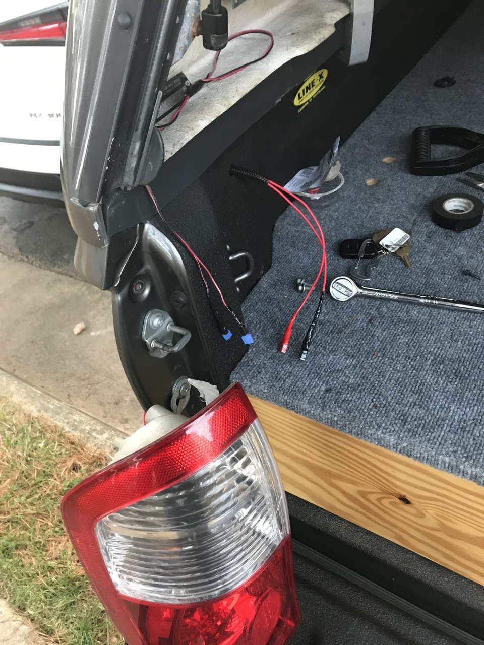

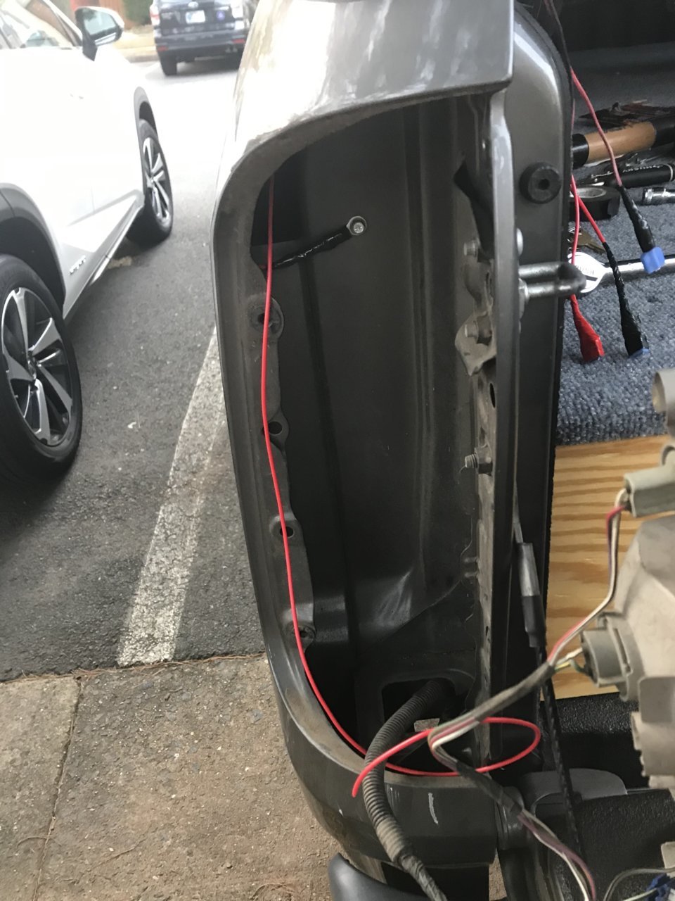

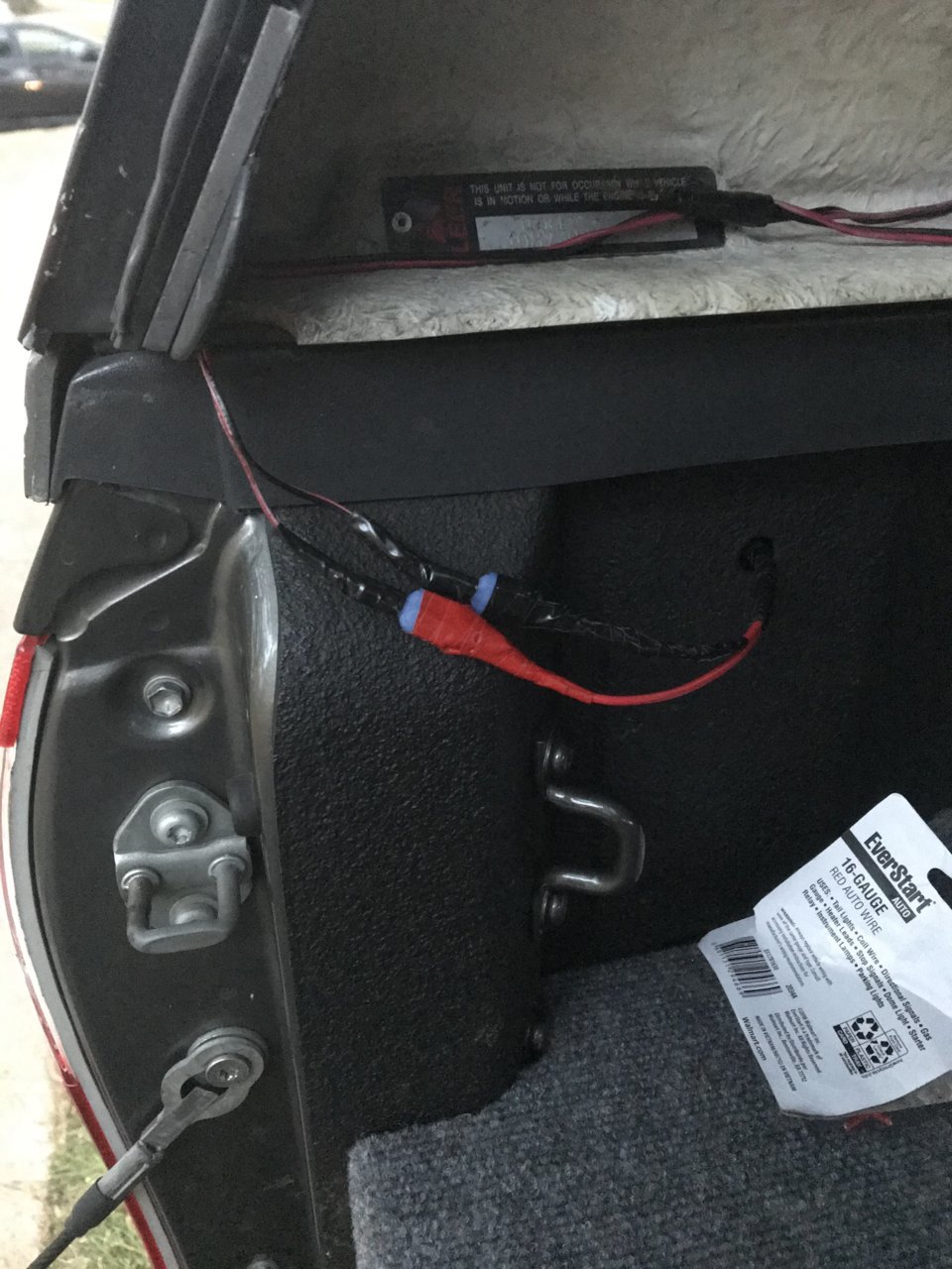

    Wired the third brake light. It has a few LEDs dead, but it works and I'll replace it soon enough. Was also my first ever attempt at wiring and electrical. Not professional, but it works.
    Before Lift/wheels/tires. 100% grandpa truck, pappy cap and skateboard wheels.upload_2020-12-30_15-47-3.jpg

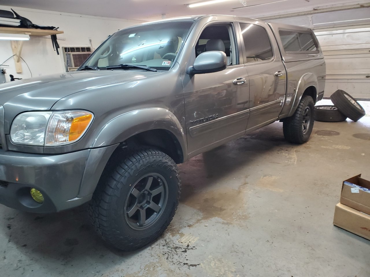

    After OME Lift, SPC UCAs, Wheelers 3 AAL, 17x8 MK6 and 285/70r17 Wildpeaks.
    Squatting in the back from the old tires and suspension parts in there. The front has settled since first installed, and it looks much more level now. But the rear definitely will need new packs in the future.

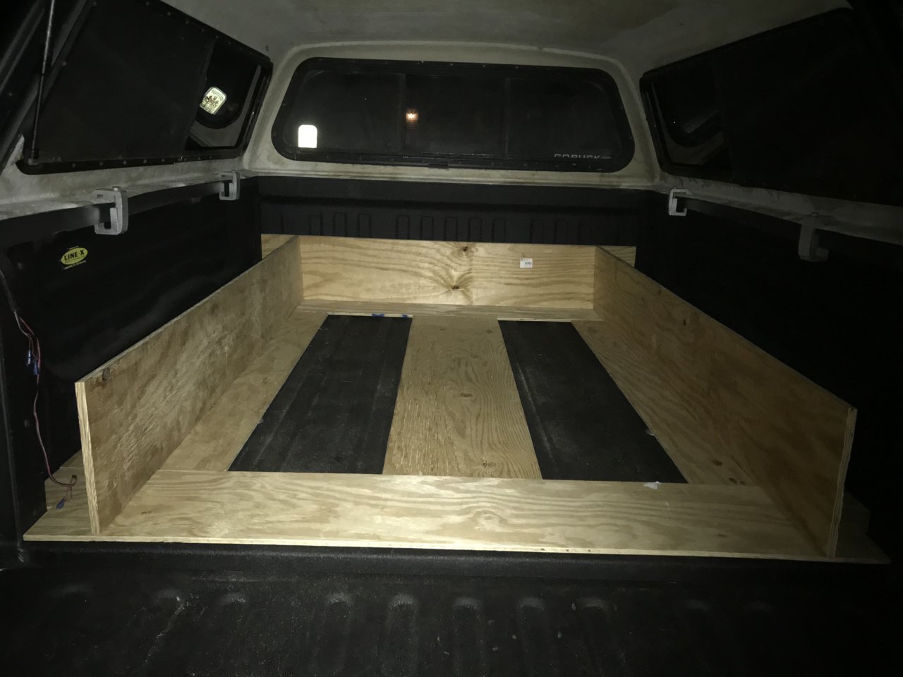

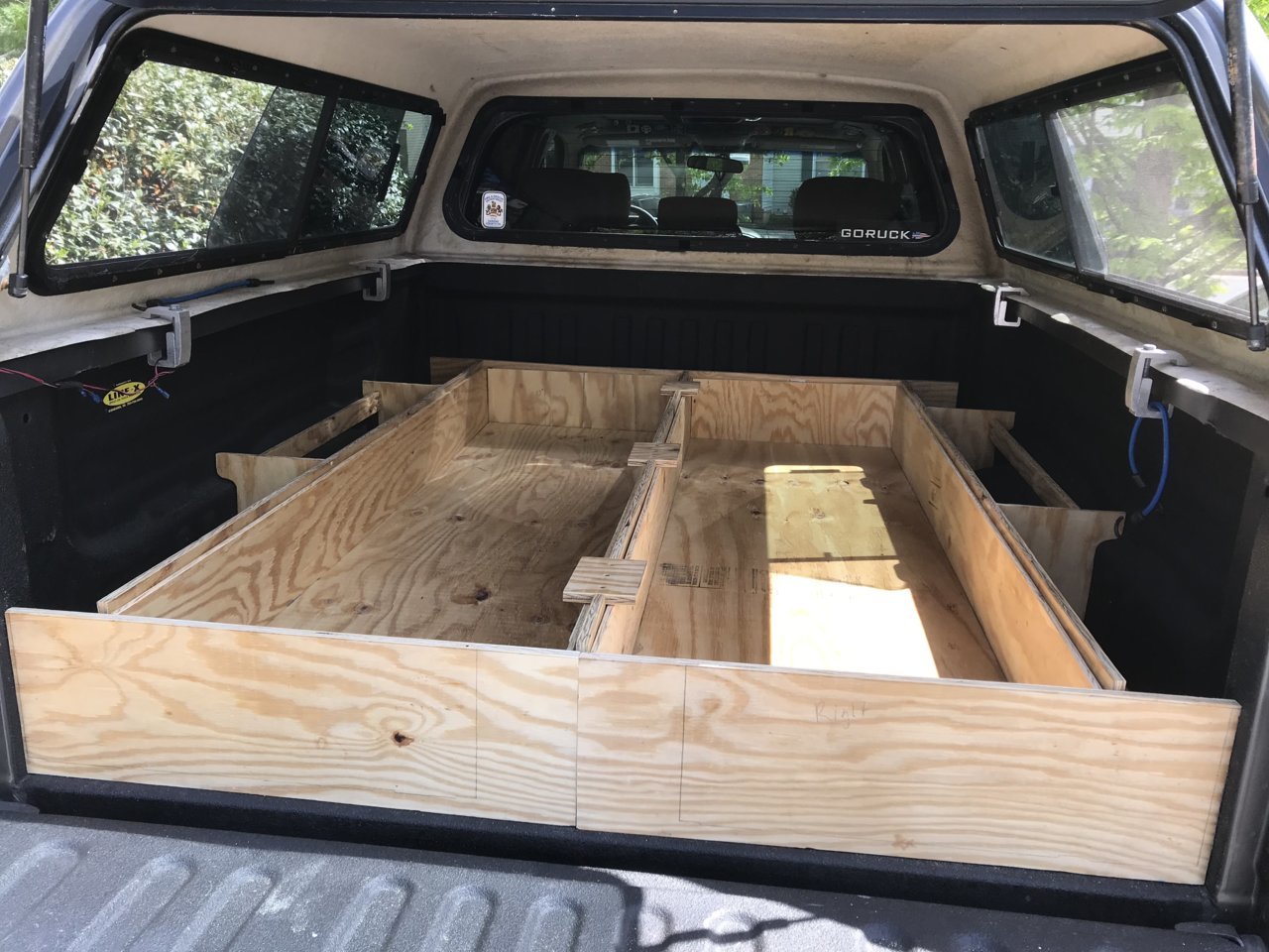

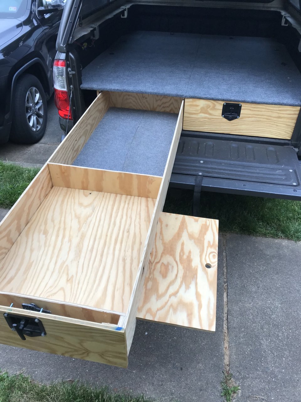

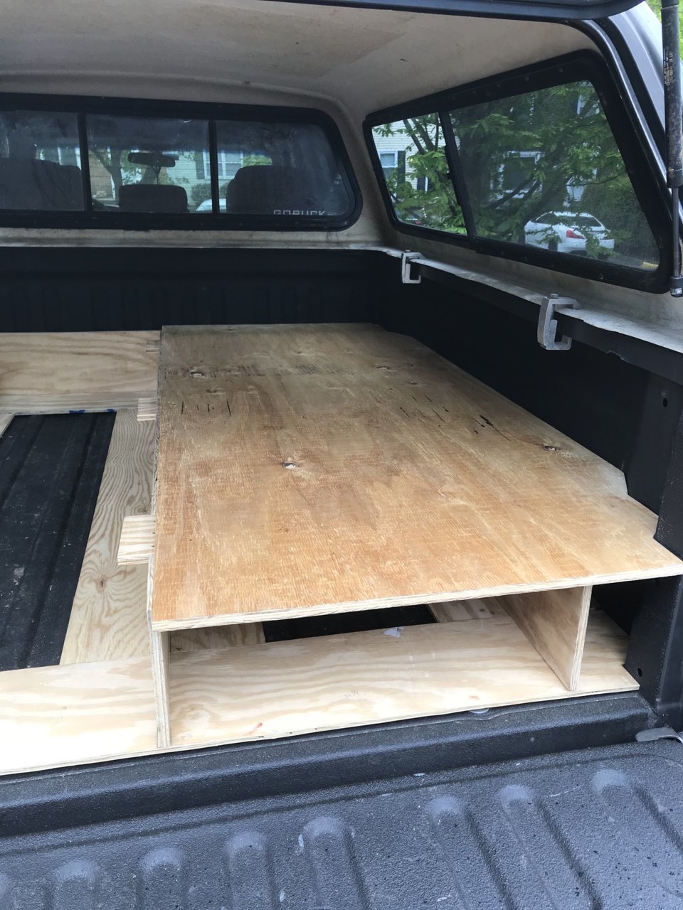

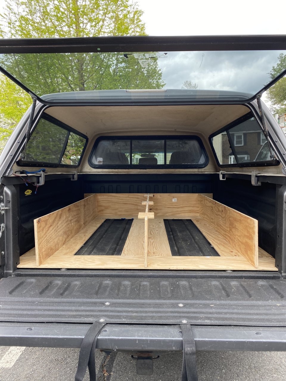

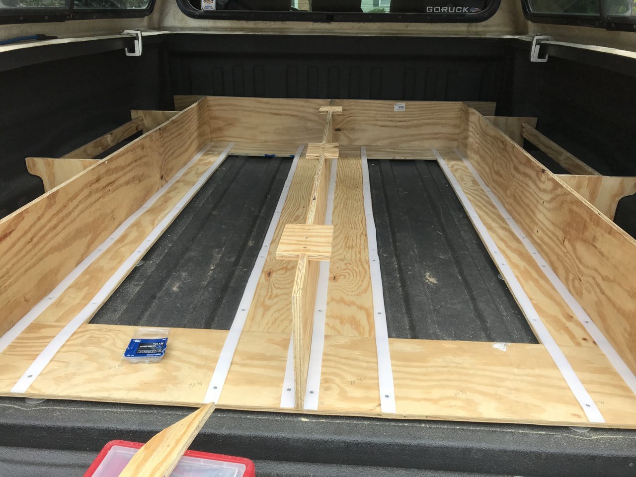

    Camping Platform

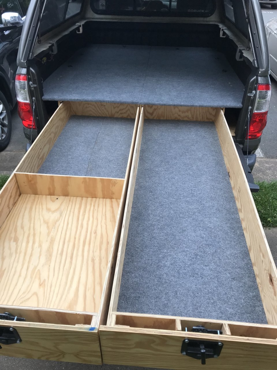

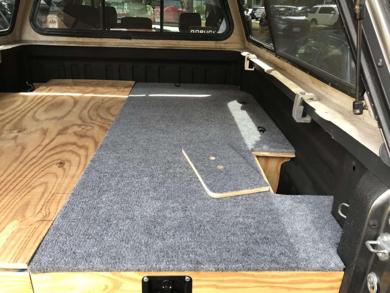

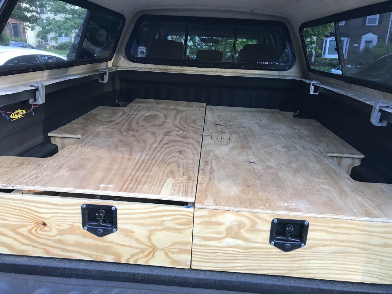

    Wanted this to be my family getaway rig, built a simple platform for my Frontier, but wanted something more substantial. When COVID hit, and my job went remote, I used it as an opportunity to build it out exactly as I wanted. I wanted it to be as light as possible, being a fixed platform because I didn't have any space to store it otherwise (townhouse living). It took me the better part of a month to do it, not having a garage really made it difficult to do, having to bring tools in and out each day, storing lumber outside under a tarp etc. But I got it done and love it.
    Materials:
    3 sheets 3/4" and 2 sheets 1/2" plywood
    Kreg Pocket hole jig
    1" kreg pocket hole screws
    1" and 1 1/2" wood screws
    Wood glue
    Indoor outdoor carpet from HD
    Box cutter
    3M 90 spray adhesive
    HD staple gun
    Locking drawer handles with matching keys
    (6) D rings
    hex bolts and washers
    wood sealant
    HDHP sheeting cut to 1" strips
    Power tools: Circular saw, table saw, jig saw, power drill, orbital sander, belt sander
    Here is the finished product.
    Progression of the build:
    Wallygator, omgboost, 912 and 2 others like this.

    Love the platform, I'm planning to do basically the exact same when I find a shell.....how easily do the drawers slide on the HDPE strips? How spacious is it back there? Do you think it would feel too cramped if you made the platform 6-8" taller for more storage?
  4. Jan 4, 2021 at 7:30 PM
    notlikejohnny
    notlikejohnny [OP] New Member
    Dec 6, 2019
    #39587
    48
    Shenandoah Valley, VA
    2005 4WD DC Limited
    @gcholmes1 Its not bad at all, I have to balance the heavy items inside the best I can, otherwise it requires a little more oomf to get them open or shut. So far it hasn't degraded at all, as grit and dirt work themselves in I'm sure it'll start to get harder. At that point I'll just try and clean them off the best I can. It was a tradeoff I chose, because I know slides would be much easier, but they are heavier, more expensive, and would eat up a lot of drawer space.
    As for space, I would like a higher cap for head room, but I can sit up inside without my head touching, but maybe only by an inch. Width is plenty for me, my wife, our toddler, and our two small dogs. So yea, higher drawers would definitely eat into it, unless you can get an above cab height topper. FWIW, the drawers are about 6'x24" and 8" deep.

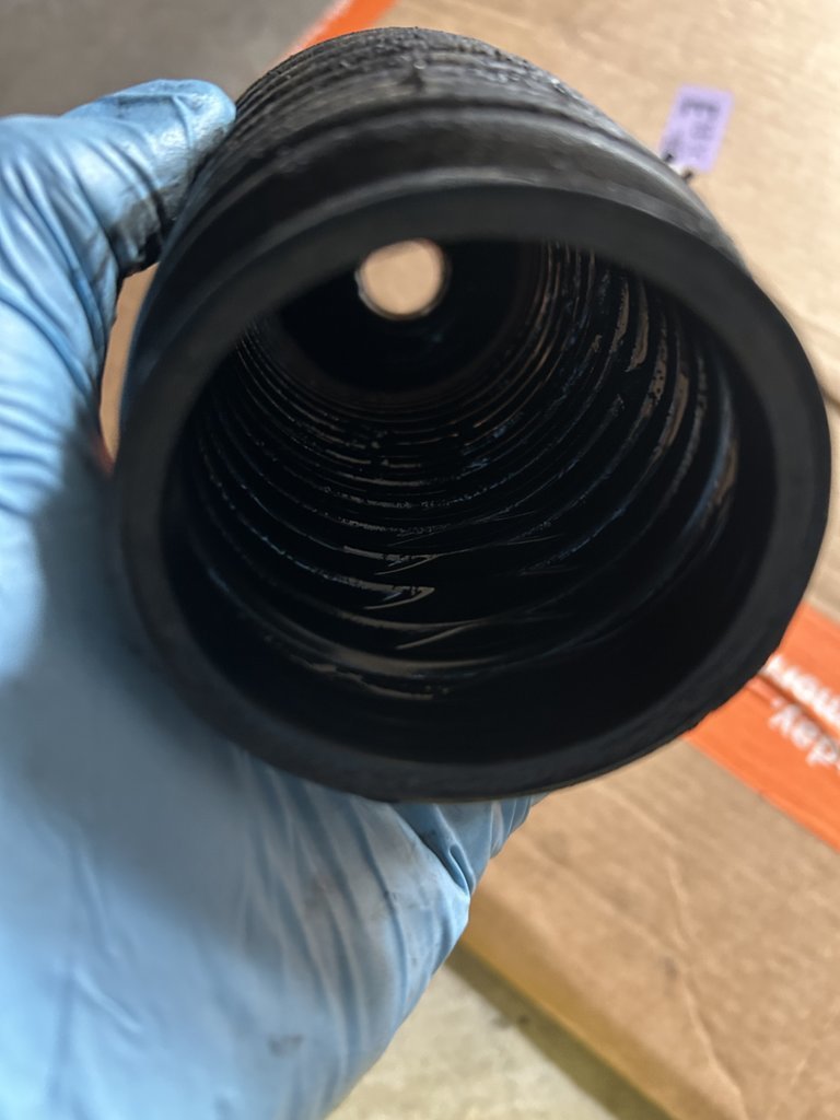

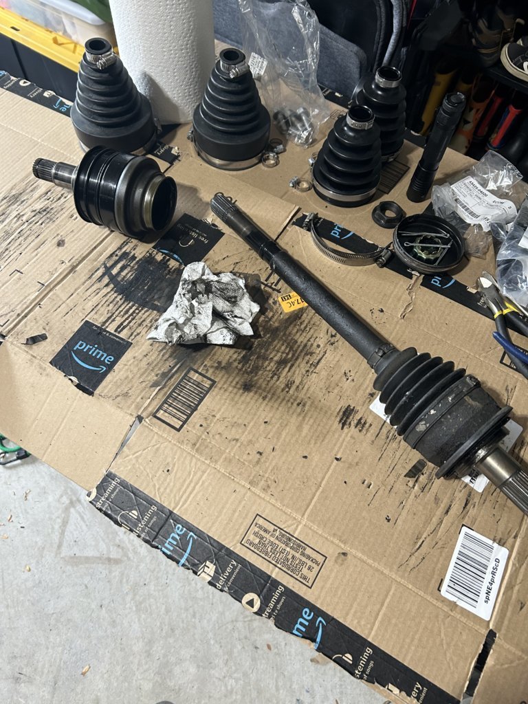

    Installed PIAA wipers since I've only used Rain-X for as long as I can remember on all my cars and they really just seem to work terribly on the Tundra.
    Lubed all 8 zerks on the driveshaft
    Lubed the SPC UCAs
    (Finally) installed the Trail Gear LSPV brake bias extension ~3 years after lift
    Repurposed the rear diff breather extension I had left over from my Frontier. Perfect fit. If I recall correctly, the union was a Toyota part when I installed it on the Frontier so makes sense. The Club Frontier guys recommended using an in-line fuel filter to prevent any dust/debris from being sucked back into the line. The i/d of the tube was too small to fit the OEM breather on this one, so I think it'll work fine this way.
