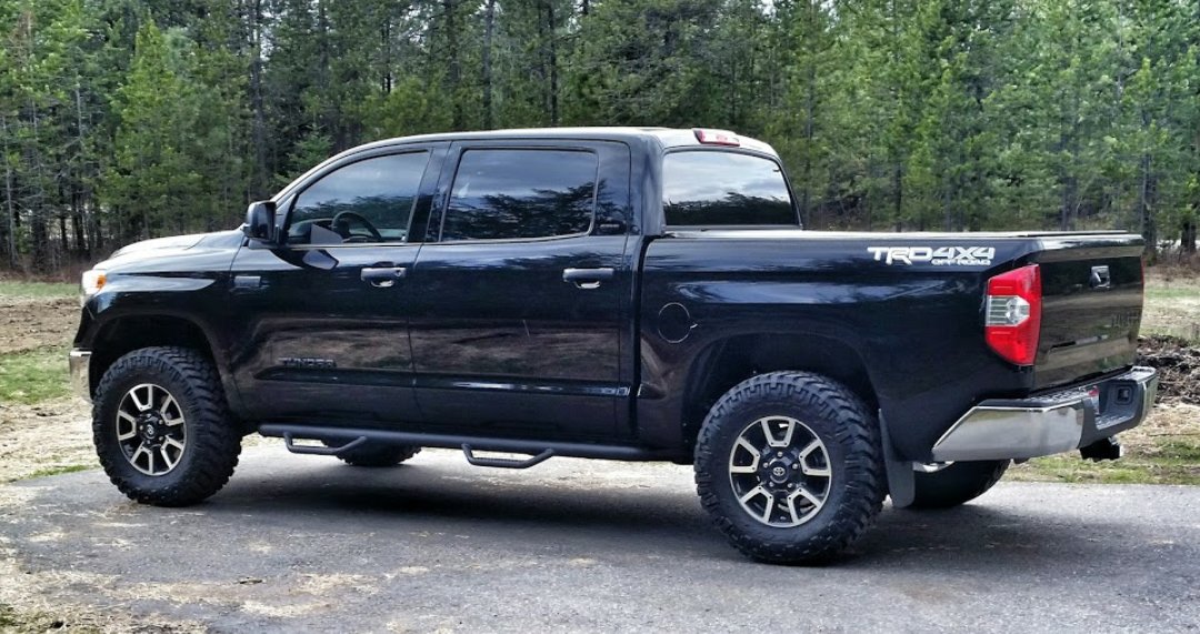

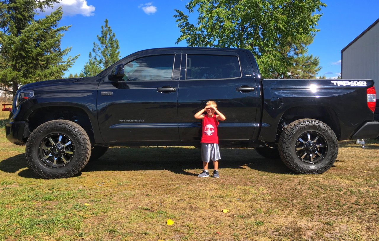

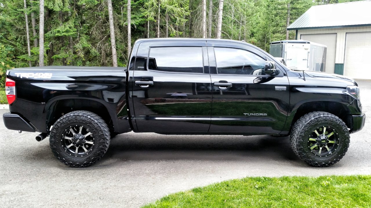

    Mid travel fox 2.5 coilovers 2.0 real shocks shims 295 70 18 trail grapplers pro accessories 32in light bar blacked out bed cover sway bar Moto metal 970 18x9
    If you are loading the bed frequently I’d suggest 1.5 to 2in in the rear if you are going 3in up front. Or possibly airbags if you don’t want to lift that much. If you want to just level the front 2in up front will give you some slight rake leaving the rear a little higher. 2.5 up front nothing in the rear is dead level.
    Check out my build before I went to coilovers I have 2.5 leveling kit then later added a 1in block then finally coilovers 3/1.
    2.5 level up front nothing in the rear
    2.5 level up front 1in rear
    3/1 coilovers shackle
