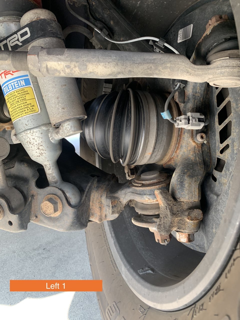

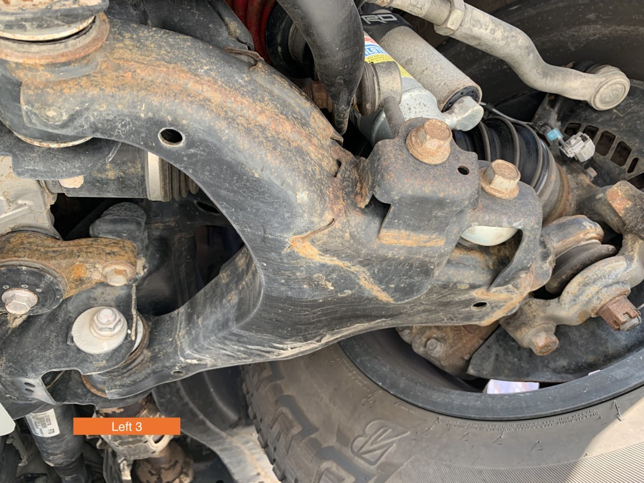

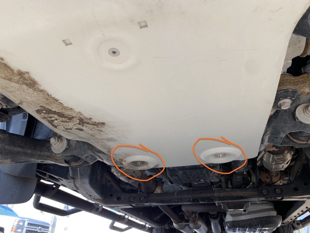

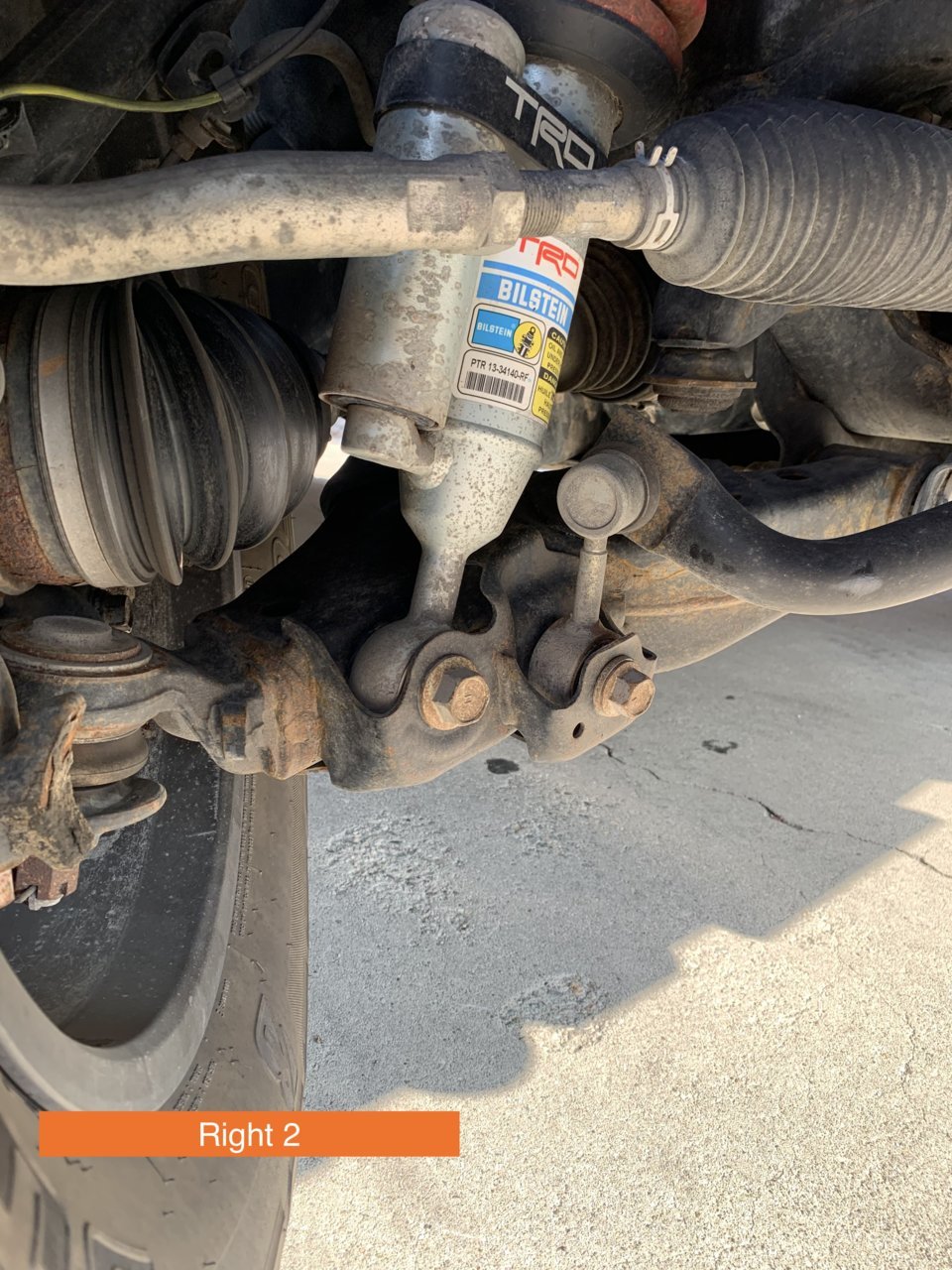

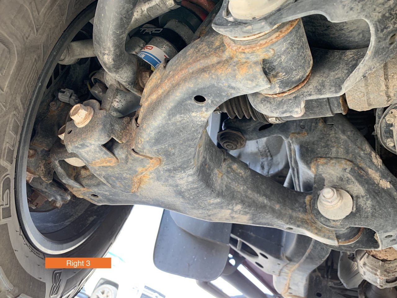

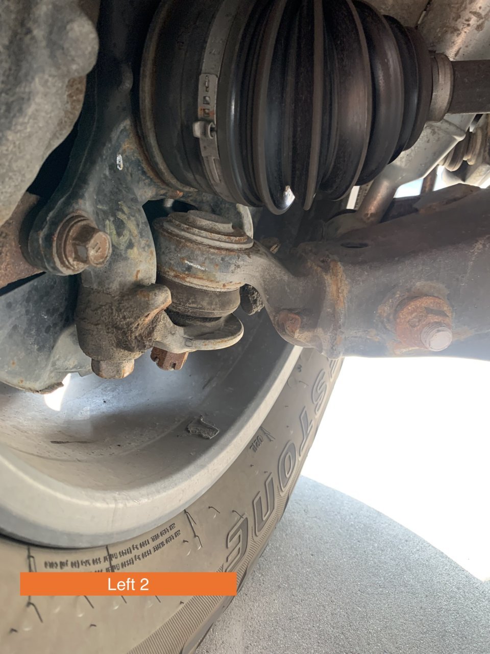

    Here are some photos of both LCAs and skid plate
    Are these the bolts everyone is talking about ^^ ??
    Let me know what you think..
    I also noticed/heard when turning steering wheel to take pictures when turning to the right at 99% it made a creaking sound and towards the left at around 85% slight sound too..
    TRDFerguson[QUOTED] likes this.

    Those lower ball joints and control arms look just fine to me. And yes, those are the bolts that you’ll need to pull and add a rubber washer/spacer between the skid plate and frame.

    Those are the offending bolts through the crossmember. Take a look at this thread - https://www.tundras.com/threads/annoying-sound.88582/#post-2227650
    That thread tells you which rubber washers to buy and provides an Amazon link and Home Depot. This is a $5 fix. Make certain that the rubber wedges go back in the proper position. I attach the Toyota Tech Tip sheet and this is a link to the installation instructions: - https://spad.external.toyota.com/Ar...dra Sequoia TRD Pro Skid Plate (DIO) IssB.pdf
