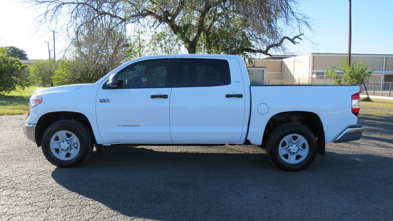

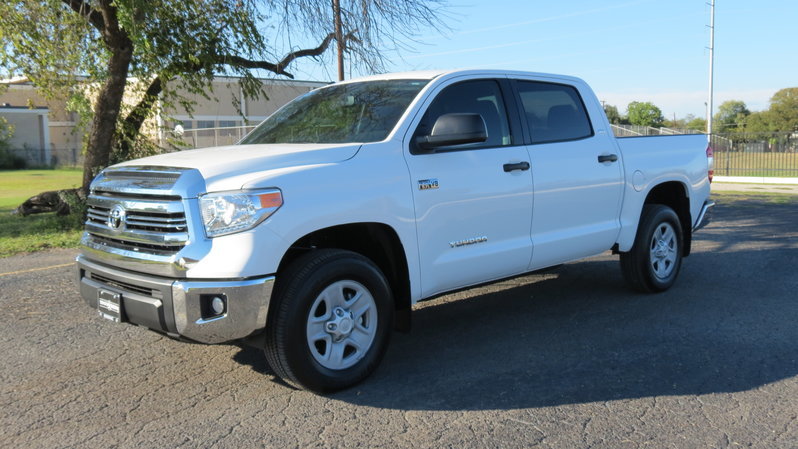

    You all here and on Tundratalk have been so helpful and awesome with recommendations on a Platinum or SR5 4X4, in the end with my daughter finishing up grad school and living with us, well family had to come first in regards to budget! I figured I could get the best for my money by modding as it permits!
    Thanks all of you class acts here!
    I would like to know if this is a good deal, the shop quoted
    OK the 6112 bilstein kit has A 1.9'' setting that will allow you to make the front all most level with the rear with out touching the back. you still may be a 1/2'' low but that would be about it.
    6112 732.43
    5160 ea 221.25 ea
    labor 175.00
    alignment 95.00
    1450.00 + tax
    on a 2017 Tundra SR5 4X4 CM,
    I want to level up the front with the stock rear, kinda like the PRO sit level! I want an aggressive stance and look, the tires I want are either Methods or Fuels with BFG KO2 or TOYO AT's.
    With the above suspension and level, what would be the biggest tire with minimal poke, I'm torn between the 18 and 20" rims but do like a bit more tire then rim look!
    Any help or opinions, thanks
