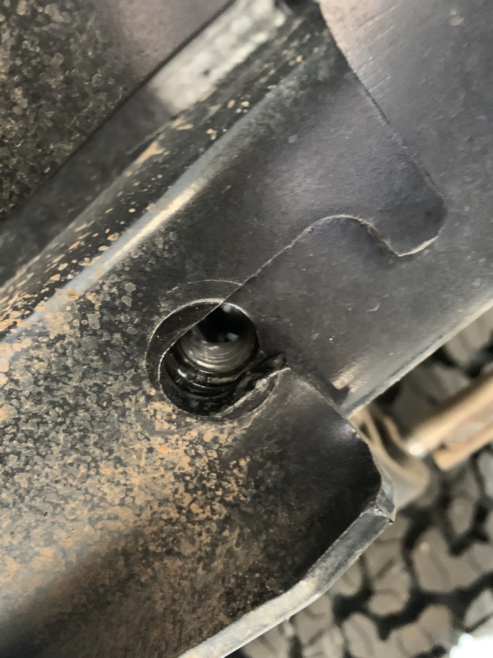

    Hello everyone I’m new to this forum just buying my tundra last weekend and noticed there was a bolt missing, same bolt on both sides can someone help with part numbers.

    Not sure of the part number but it looks like one of the two bolts that connects the hitch to the frame. Did you buy it used? My guess is that someone had a rear sway bar installed and took it off before trading it in. Definitely don’t tow anything until you get it fixed.

    Looks like previous owner removed the sway bars and kept the bolts.

    @Roman has an “ultimate Parts thread” that you can post in and he’ll be able to give you the exact part number. Your local parts guy at the dealer should be able to help you as well.
    Or just buy the rear sway bar as it comes with all the hardware :)

    what they say ;) previous owner removed sway bar. 5 min fix once you get the replacement bolts. Don't tow anything til you get them.

    Aha, that explains my missing bolts!
    I replaced them, wondered why they weren’t there... but the sway bar removal explains it.

    Yup that’s what it was sway bar link was removed

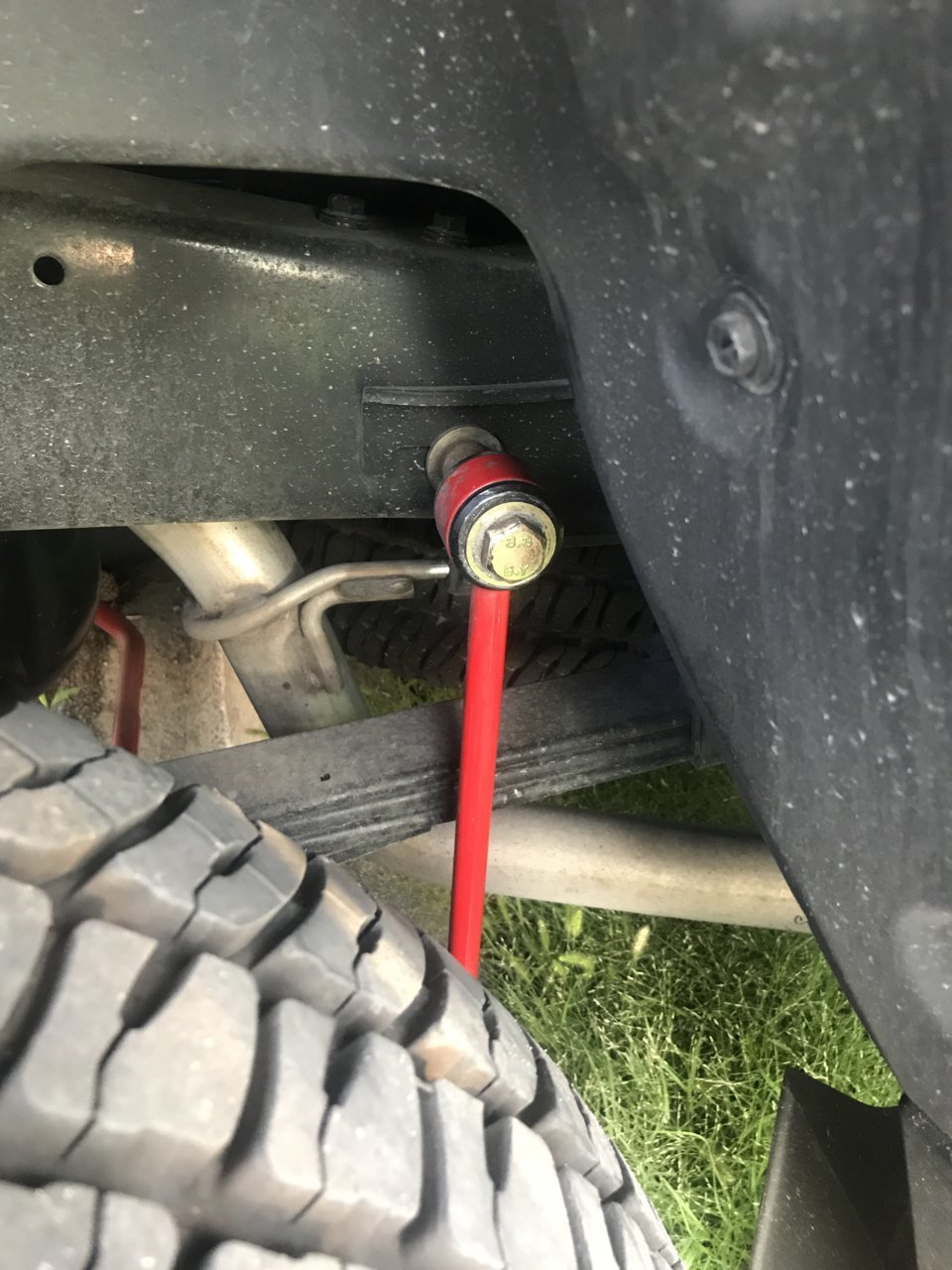

    I removed mine with Icon Stage 9 - it limits travel - but I kept it. Once I install Vagabond camper and get things fully outfitted I may go back to it, but will need to build custom links to fit it.
