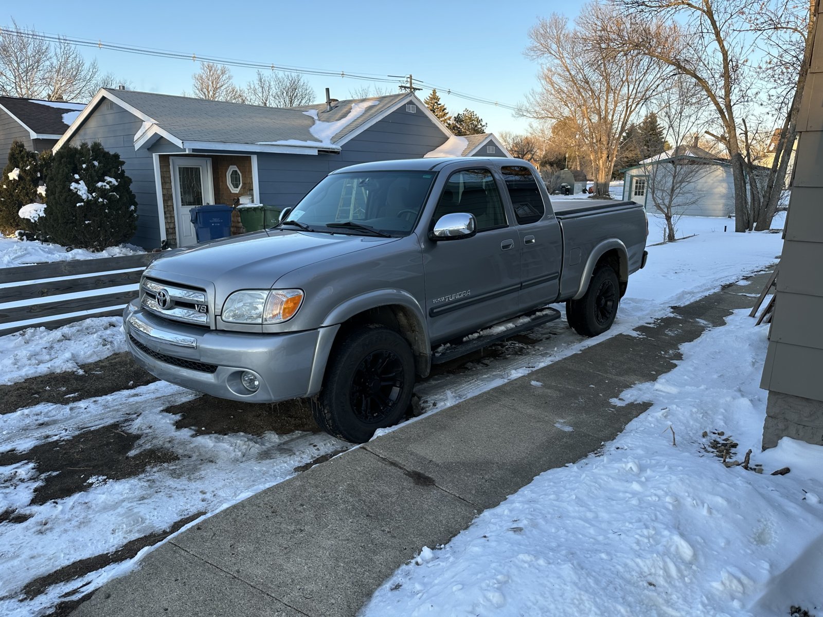

    Oh and here’s the new rig:

    But before you invest any money, I see snow in your picture, you need to go over that frame with a fine tooth comb to make sure you're not dumping money into a truck with a rotten frame. The thread I linked in your other post about coolant should help identify the areas to really carefully check. Be sure to treat the frame at least annually with woolwax or similar if it'll be used on salty roads.

    I checked the frame out before buying it and it looked to be in good shape. Barely any surface rust as the guy before took very good care of it. But I’ll take your advice and look it over inch by inch just to be sure. Thank you!
