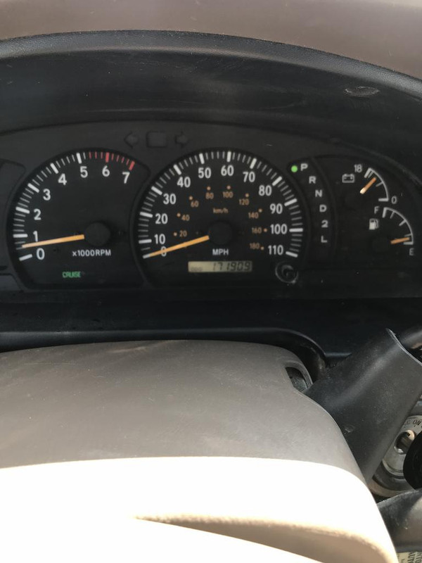

    I recently scored (or at least I think I did) on a 2000 Tundra Limited 4x4 4.7L. It popped up on FB Marketplace and I jumped on it. It has a 171K on it, brand new all terrain tires, bed liner, all stock. Motor runs quiet, runs healthy and it passed emissions with flying colors. Trans shifts smooth and has no weird issues. 4x4 works great but the tcase sometimes makes a little clunk going in/out. The AC is ice cold, hot heater and the under carriage was bone dry with no visible leaks from anywhere. The interior is in great shape aside from a few stains that I will try and get out and the front seats appear to have had covers on their entire life. I picked it up for $2900.
    It has a couple of issues but I am starting with the basics. I am doing an oil change, fuel filter, air filter, front pads/rotors since they are warped, fuel injection cleaner, might clean the MAF sensor, full detail inside/out and whatever else I can think of while I am working on it. I think one of the front CV axles needs to replaced as I can hear some clicking when making a right turn. The door switch on the drivers side seems to be wonky because when I am driving it, the flickers off/on unless I put pressure on it? I remember my '95.5 Tacoma doing the same thing.
    Anyways, what else would you guys suggest going through? No idea when the timing belt was replaced last or any other maintenance. The previous owner said he just changed the oil but for piece of mind, I am going to change it again. I will add some pictures later today.

    Sounds like you got a great deal! Timing belt/ water pump service using the Aisin kit (big job for a DIYer), and OEM lower ball joints (easy job with some basic tools, but first check to see if the recall was done for your truck...you might get them for free). Other than that, standard age-related baseline (trans fluid, diffs, t-case, etc).

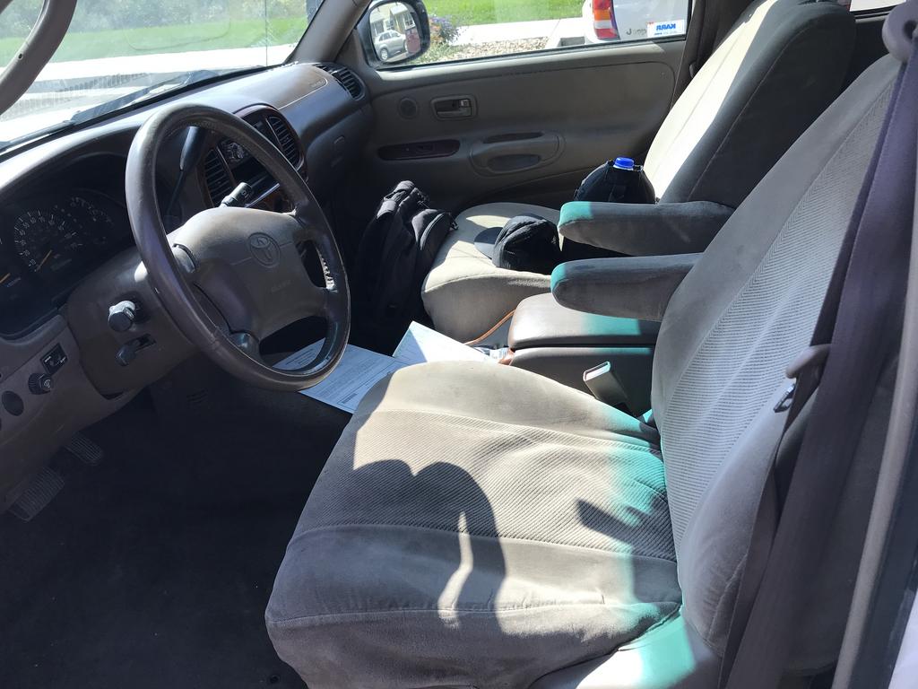

    I did get the detail done tonight and it cleaned up well! I took the seat covers off and was shocked. I believe these seat covers have been on since day one. Once I peeled them off, the original leather was in amazing shape! I only snapped one pic but for being almost twenty years old, they are in great shape.
