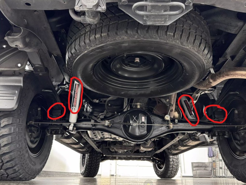

    The only thing that concerns me, right off the bat is this garbage I've circled in red :puke:OP, look at the front struts and see if there is a spacer between the strut and the mount. I bet there is.

    @The Black Mamba first of all, THANK YOU. That is the knowledge I am here for.
    you are 100% correct on all observations. The dealer had everything installed prior to listing it and from my understanding, this truck came to him bone stock. I bought it for the overall condition of the truck, not the aesthetic lift. I will absolutely follow your guidance here.

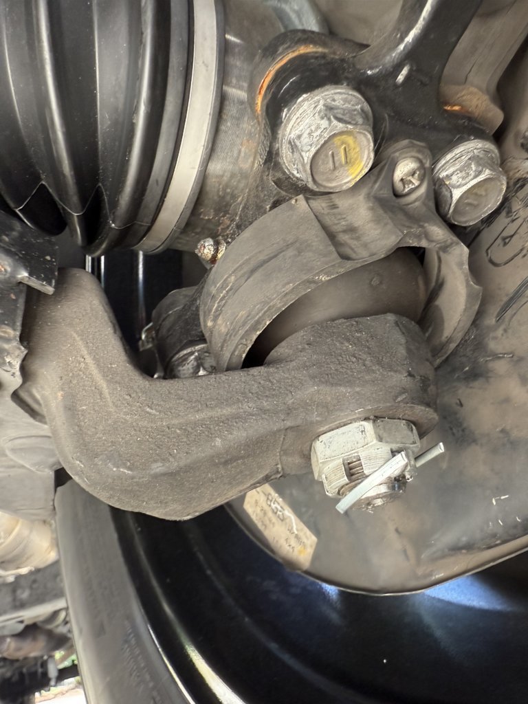

    Can we see pics of said ball joints? I doubt they are OEM and I would not recommend driving on non-OEM for any distance. Please see this thread. Not as a scare tactic, but for knowledge. Also, unless you're planning to go LT, the TC lowers and uniballs are nice, but over kill. I run the OEM LBJs TC uppers, SPC lowers and 4600s on OME 2885s up front (but that's me) with 5100s rear. Others will give you plenty of other options, opinions and advise.

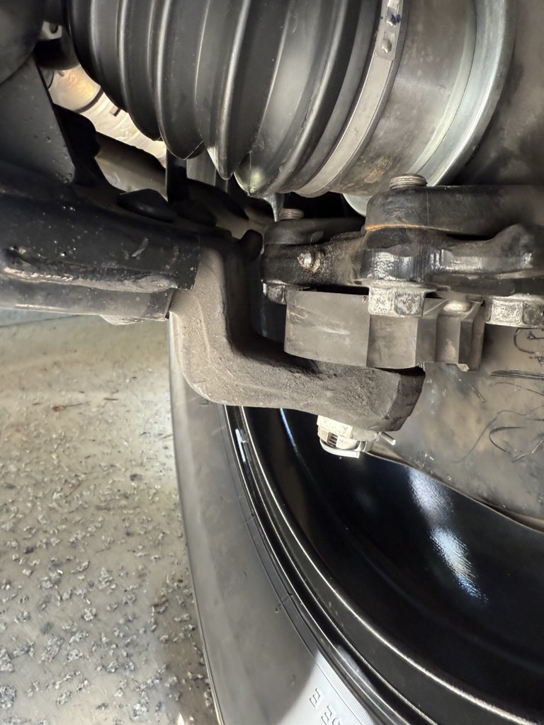

    sorry for the funky angle, its hot as hell today and my driveway is a bit toasty.
    If the quality of the lift is any indication, these probably arent quality ball joints.
    I'm learning as much as I can about the ball joint/uniball topic and so far, the uniball design seems to be the choice if cost wasnt a factor.
    The truck will not see anything but the streets of the South Carolina midlands for probably the next year as I save for a proper suspension setup so hopefully the stress will be minimal. I have a VW MK6 Golf TDI as a commuter (also a project as the DPF is clogged so thats getting removed in 2 weeks) so the truck will see light use until it gets better parts installed.

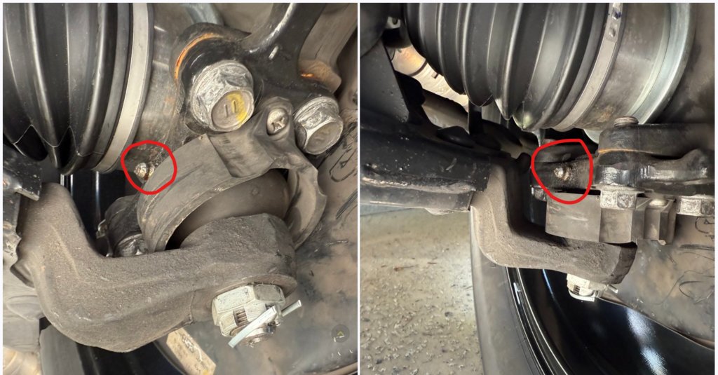

    @StatlerTundra4x4 Ok, can confirm these are not OEM. I don't know what they are, just the zerks (circled red) are the dead give away. I you're not planning on those TC components soon, please replace with OEM as soon as possible.

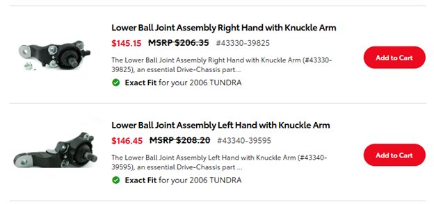

    Below is what you'll need to order. Prices are reflected from Serra Toyota Birmingham. Use whatever dealer you like (they are our current favorite)
    Left Lower Ball Joint Assembly: 43340-39595 x1
    Right Lower Ball Joint Assembly: 43340-39825 x1
    Flange Bolts: 90105-12316 x8
