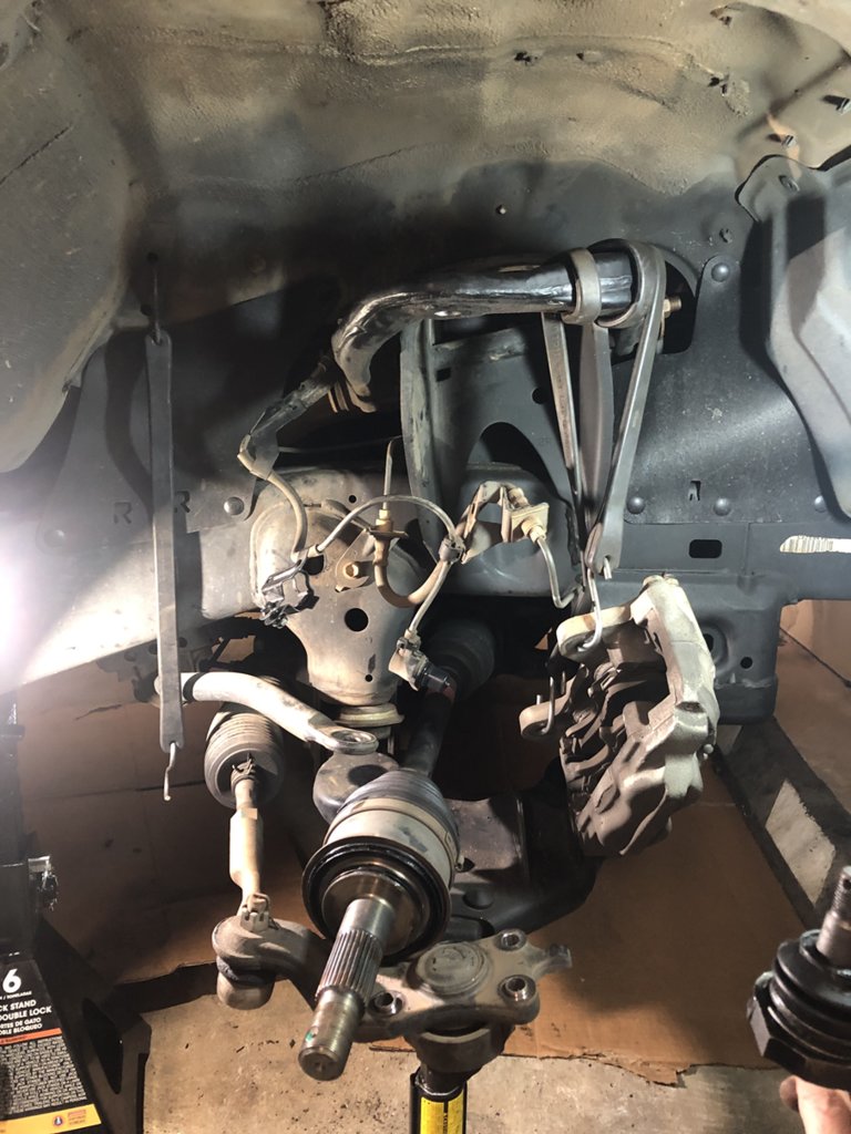

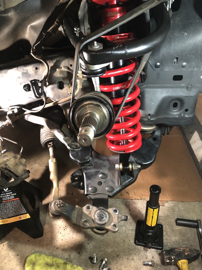

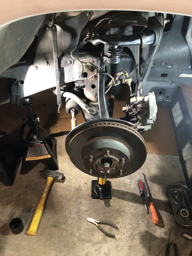

    Here's some pics from my coilover install.
    I used a bungee to hang my caliper because I couldn't find my damn S-hooks. Note swaybar is disco'd, caliper is off so the rotor can come free with a tap or two, the UBJ is already popped free, and I safely have the ABS sensor ($$$) tucked aaway; I'm using the stock jack to support the LCA while I'm doing my work - it's a great tool to have on-hand. Note the two screwdrivers, should be clear why those are there :D
    And here, knuckle is out, CV axle is temporarily resting on the LBJ, this is EXACTLY why I removed the knuckle before the LBJ, so I could use the LBJ as a platform to hold the CV axle, then bungee that CV up, then pop the LBJ.

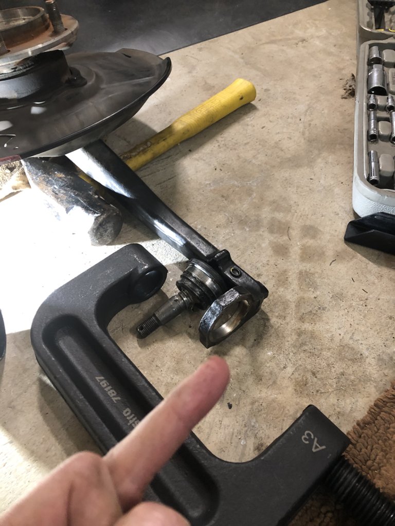

    It's so much easier to press out the UBJ with the knuckle on the floor...
    Because if you try to press out the UBJ with the knuckle still in the truck with 4WD, this is what you're fighting against: Trying to find the space to get that big ass press on top of the knuckle, without yanking the CV axle out, with the knuckle bungeed, it fucking sucks.

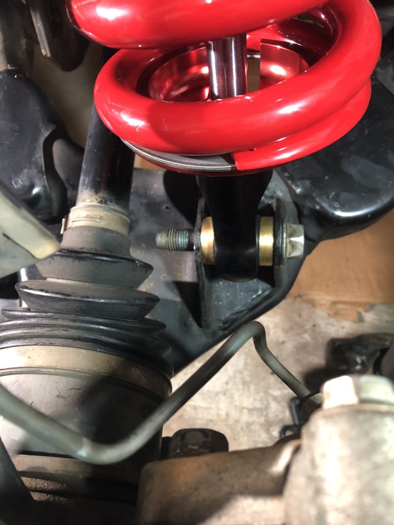

    This is why the direction of the lower strut bolt is important - this picture shows it installed backwards, with the tip pointed toward the boot. While it may not make contact with the boot in "normal" situations, I wouldn't trust it to not make contact in all situations. Although I do know a few on here have it installed backwards and it hasn't happened, I wouldn't personally do it, stick with OEM.

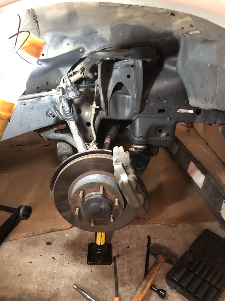

    Lastly, here's a pic of bungee'ing the CV axle to keep it safe. I think all of thse shots were from the same side, but ... hopefully pics help.
