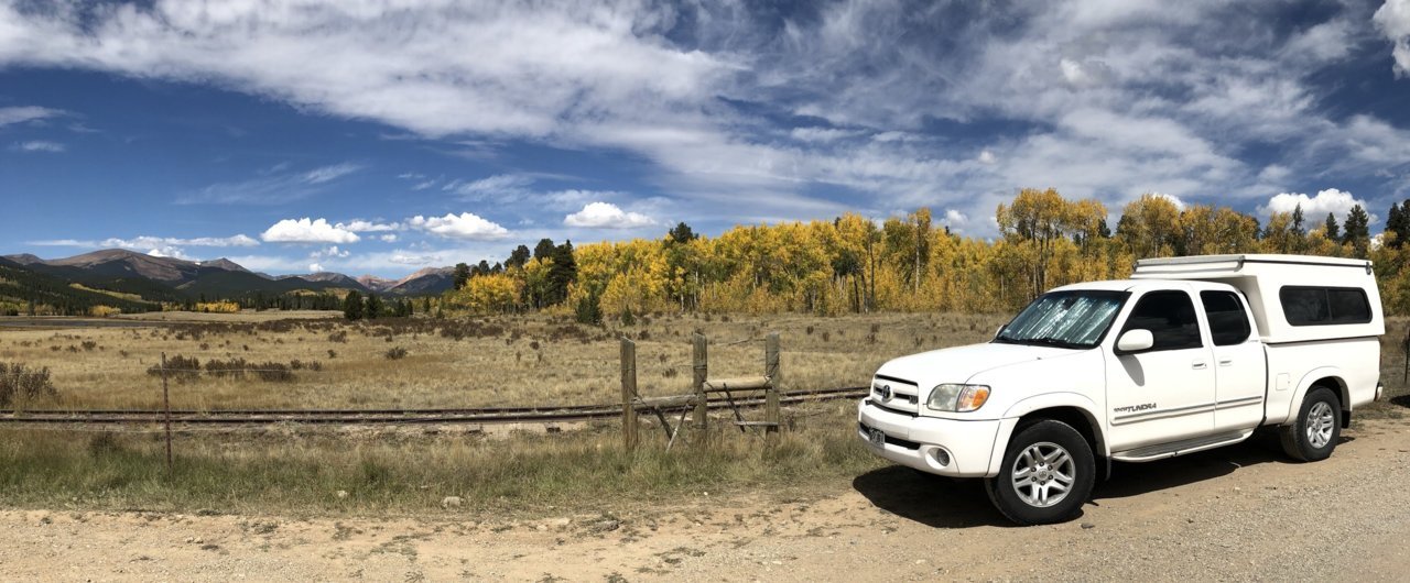

    Hey all, I'm looking to turn my 03 Tundra Access Cab 4x4 into a road trip/dirt limo to get me, mountain bikes, and the dog to all the cool places in the Rockies. Not really looking to do a ton of technical trails, but would like the truck to be capable offroad and well-mannered for highways.
    I need to replace the stock suspension ASAP (blown, Icon Stage 2?), new tires ASAP (AT K02 Pizza Cutters? and wheels?) and to do a build out of the Flippac (water, drawers, kitchen)
    I have so many questions and need to balance the build against my travel budget, so thanks in advance for any advice!
    Specific challenges to the build are:
    • make it good at offroad travel, mostly washboard roads and some high clearance trails without sacrificing highway comfort and mileage
    • carry bikes, camping gear, and dog in comfort
    • do the above things while saving cash for trips
    Here's what I've done so far:
    • Dual battery (Odysseys with Blue Seas charging relay, power steering res relocation)
    • Dometic CFX50 fridge
    • Heated Seats
    • Kenwood Head Unit
    • Rhino liner
    • swapped in my old Flippac
    I definitely need help with my plans going forward:
    • Good suspension (maybe a small lift?)
    • Good AT tires, balance between highway and offroad capability
    • Build out the camper with some organization, drawers?
    • Armor (basic sliders/skid plates, nothing fancy)
    • Self-recovery gear
