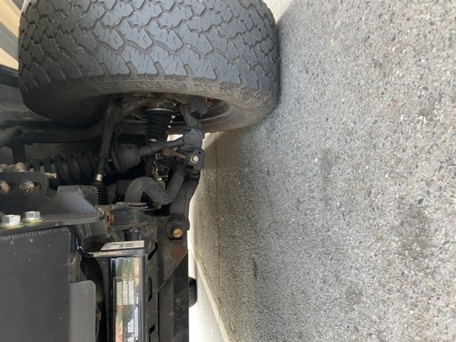

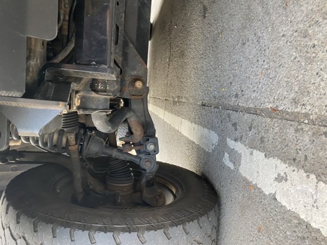

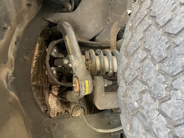

    Here are some images

    Tie rods look maxed

    Everything is maxed out
