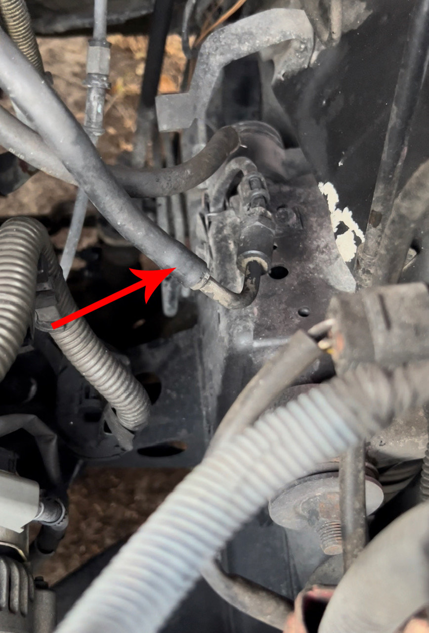

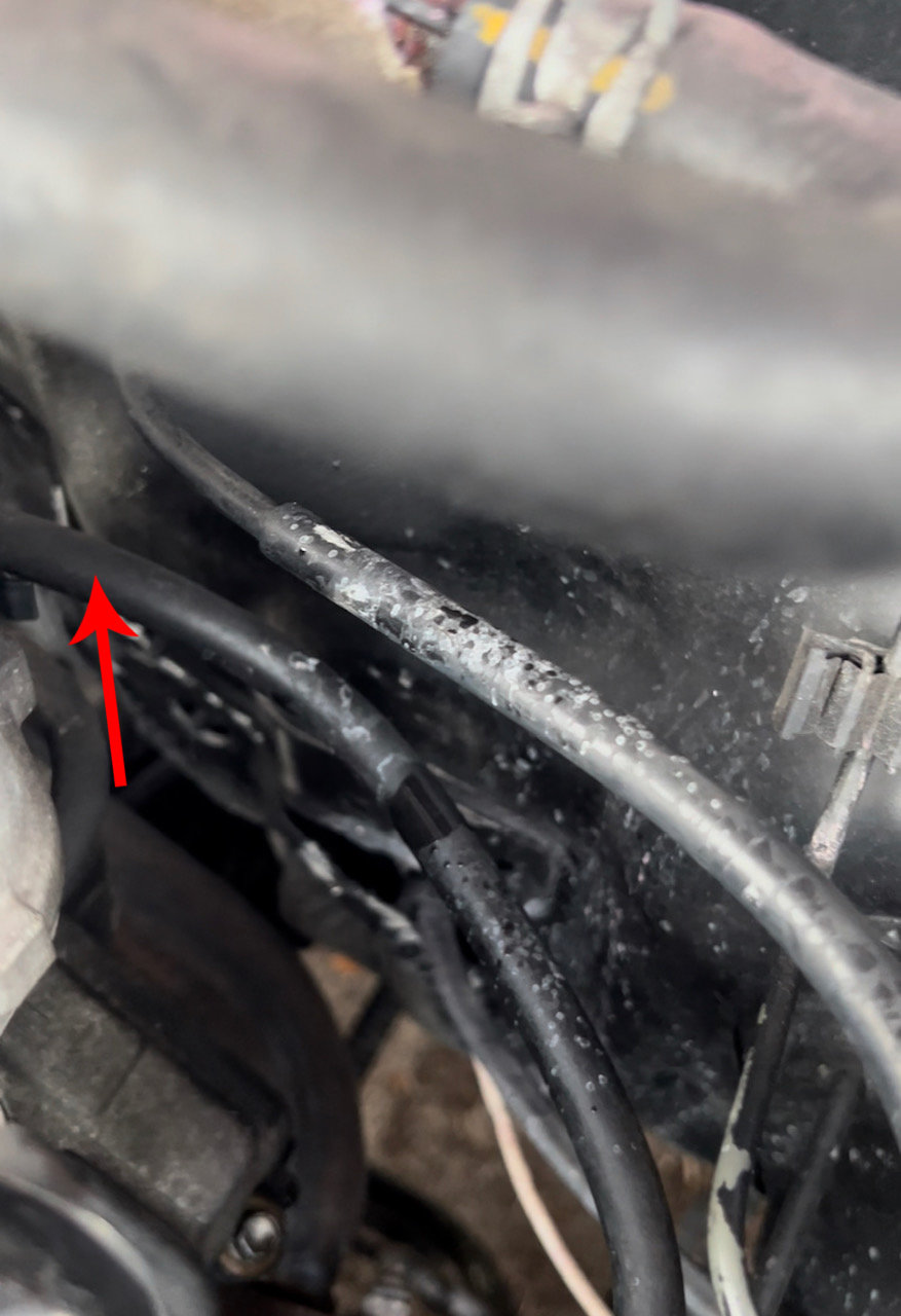

    2002 v6 2wd. This line runs from underneath the truck up through the driver side of engine bay and then back behind the engine. There's a vibration in the line that coincides with a ticking sound coming from the back of the engine. It sounds like air escaping from small hole at like 500 bpm. No visible fluid leaks. It's loud and really annoying.

    Fuel line from fuel filter and gas tank.

    Yeah, you'd know it if that line had a leak lol.
    You probably have a crack in your exhaust manifold (common) and a worn out steering wheel firewall seal, that allows the sound into your cab.

    The injectors on these trucks can supposedly be notoriously "clicky" sometimes.
