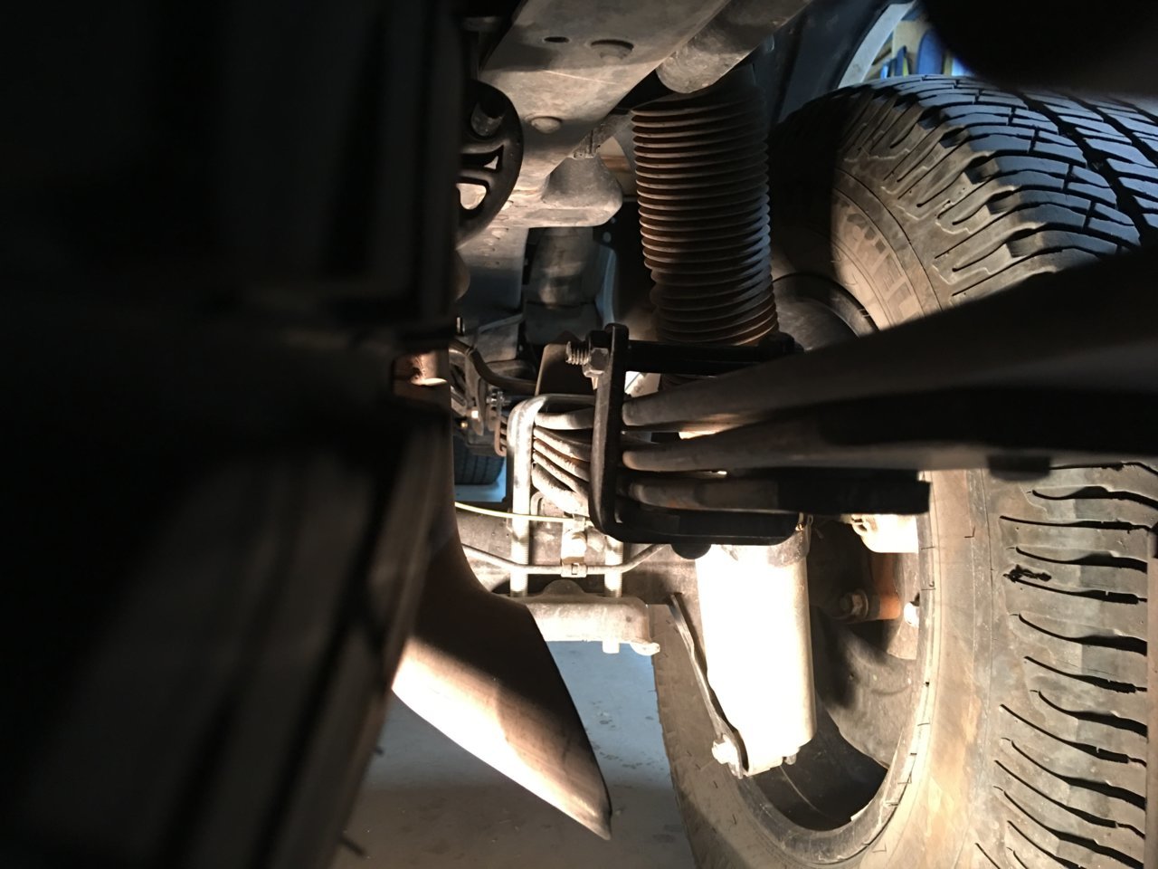

    Here’s a picture of the current “recurve” aspect of the springs.
