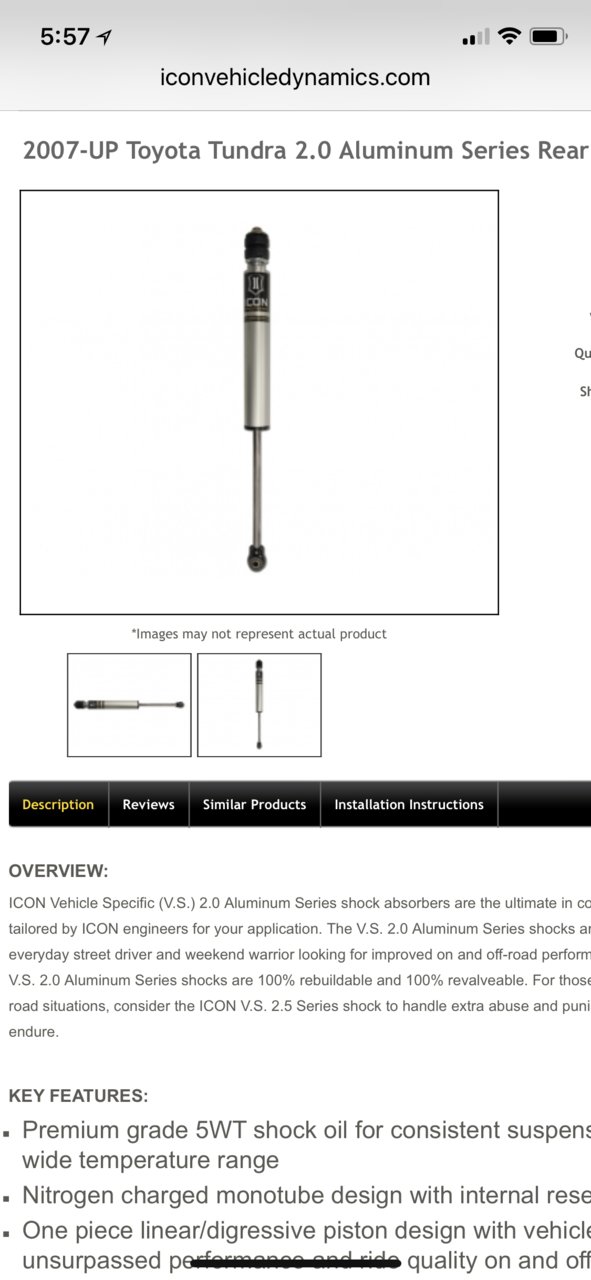

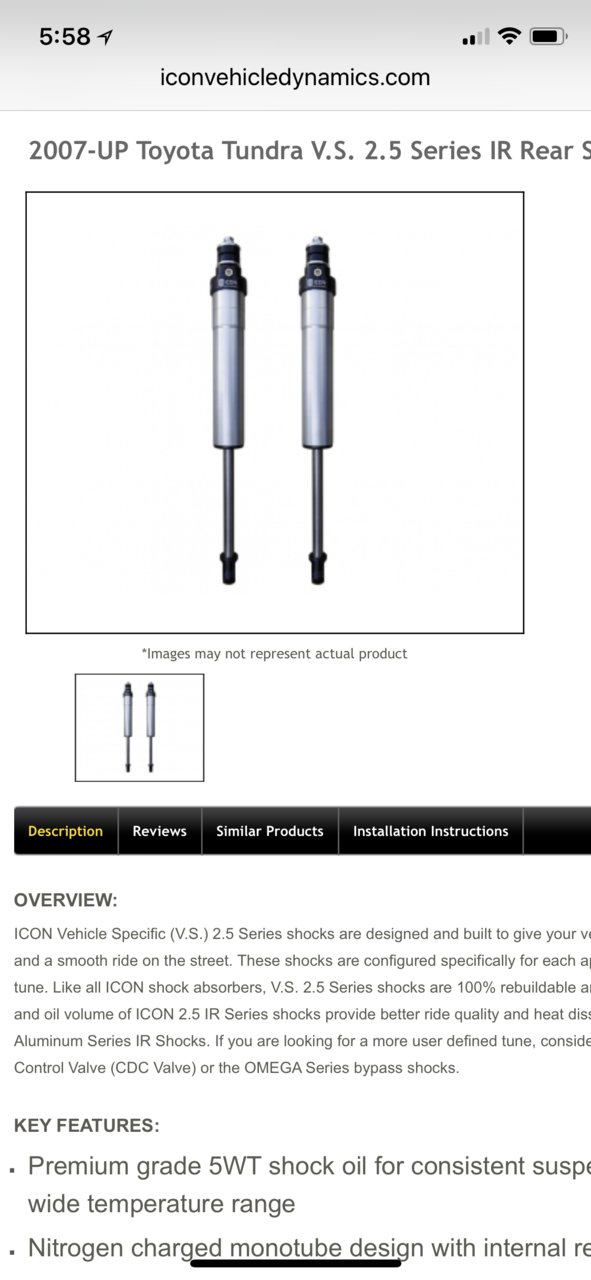

    A39CD647-C965-4424-8EBB-1EF9C43CD63D.jpg FD5C4A76-5D45-492C-B4C3-4860F810905D.jpg Currently running Bilstein 5100 in the rear of my 2016. A vast improvement over stock, but I’m hoping a further upgrade will soften things up even more. I’m 100% mall crawler so don’t want to over buy.
    Considering Icon 2.0 or V.S. 2.5. How much of an improvement will the 2.0 be (if any) over the Bilstein? Is it worth it to spend a little more for 2.5s? The last thing I want to do is upgrade incrementally year after year. I want to make a final investment now. Why Icon? Good reviews, positive comments here, and price point is just right. But I’m open to suggestions. Thanks!

    Do you have Icon or Bilstein in the front? Icon and Bilstein have digressive valving. Most others are progressive. Personally, I wouldn't mix progressive and digressive but that's just me.
  4. Mar 9, 2018 at 7:45 PM
    AKJ78
    AKJ78 [OP] New Member
    Feb 19, 2017
    #6442
    157
    Aaron
    San Diego
    2016 Silver Platinum 4X4
    3/1.5 lift. TRD sway bar. Bakflip V1 cover. Fuel wheels w/BFG A/T.
    6112 up front
