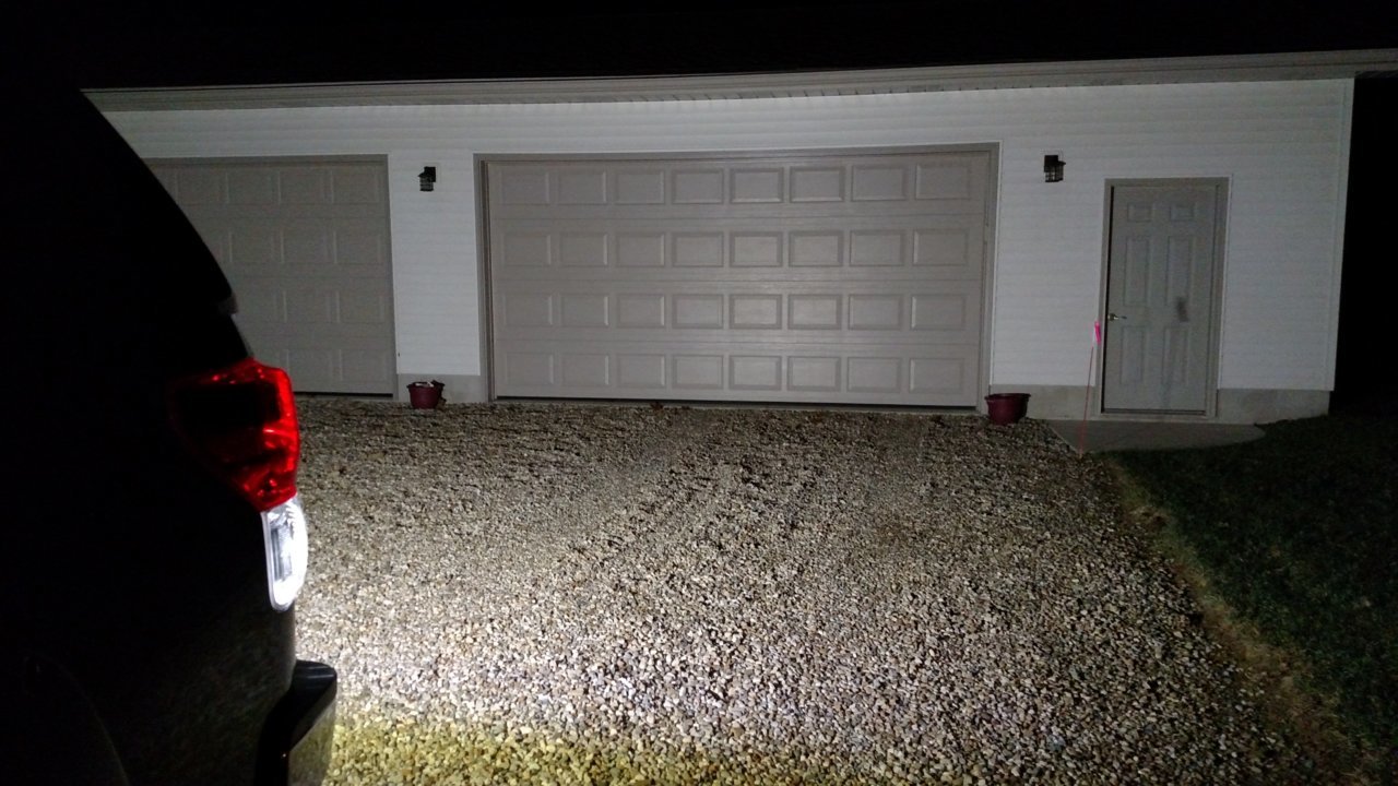

    Yes the VLED LPR is really nice I also have one and Sylvania Zevo bulbs in my reverse lights.

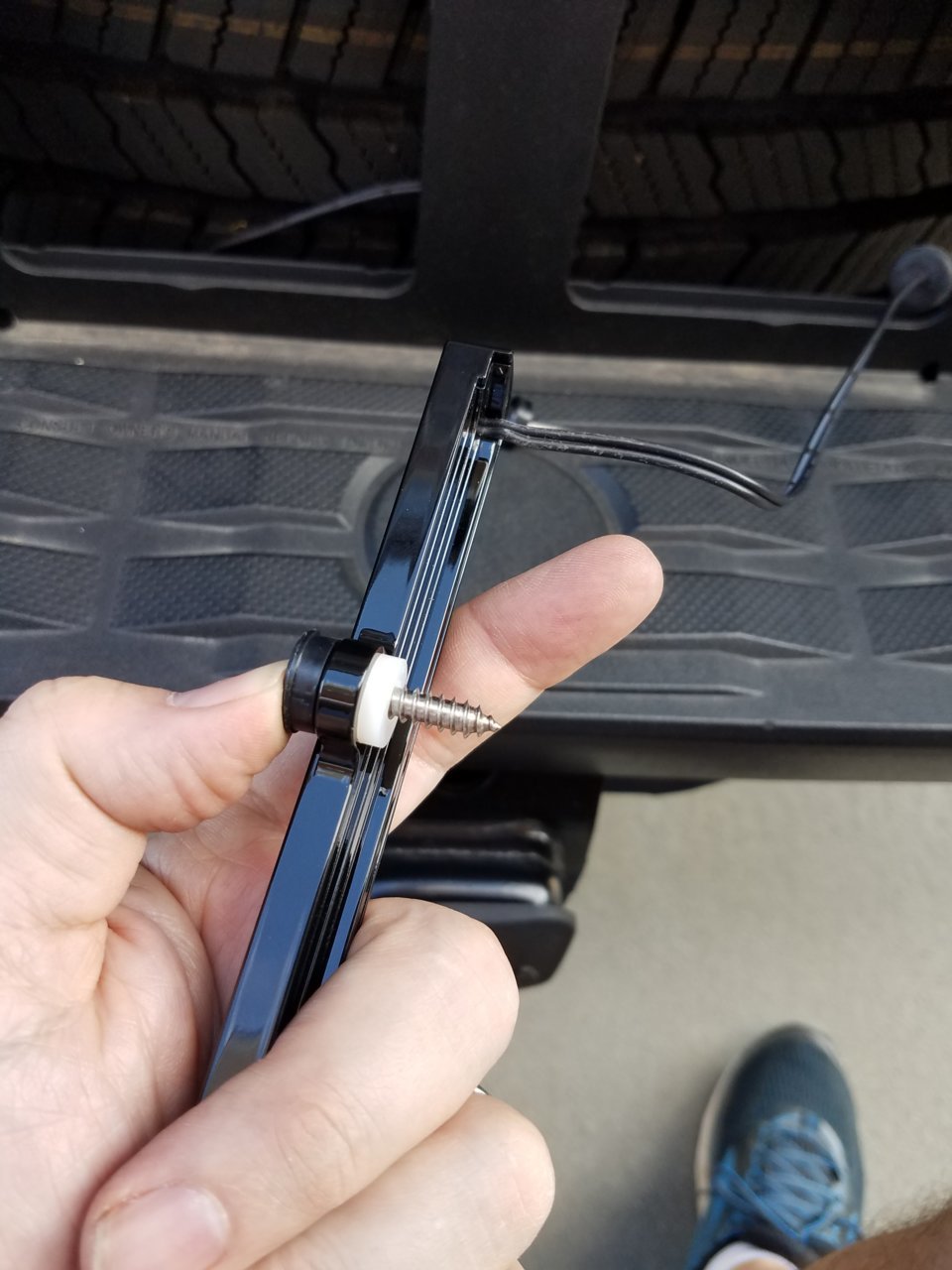

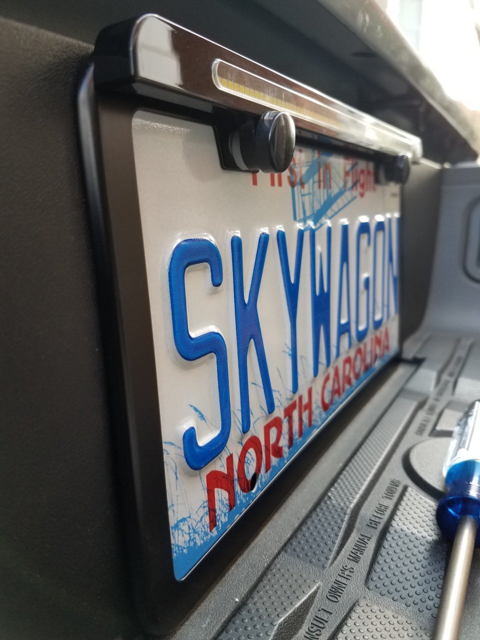

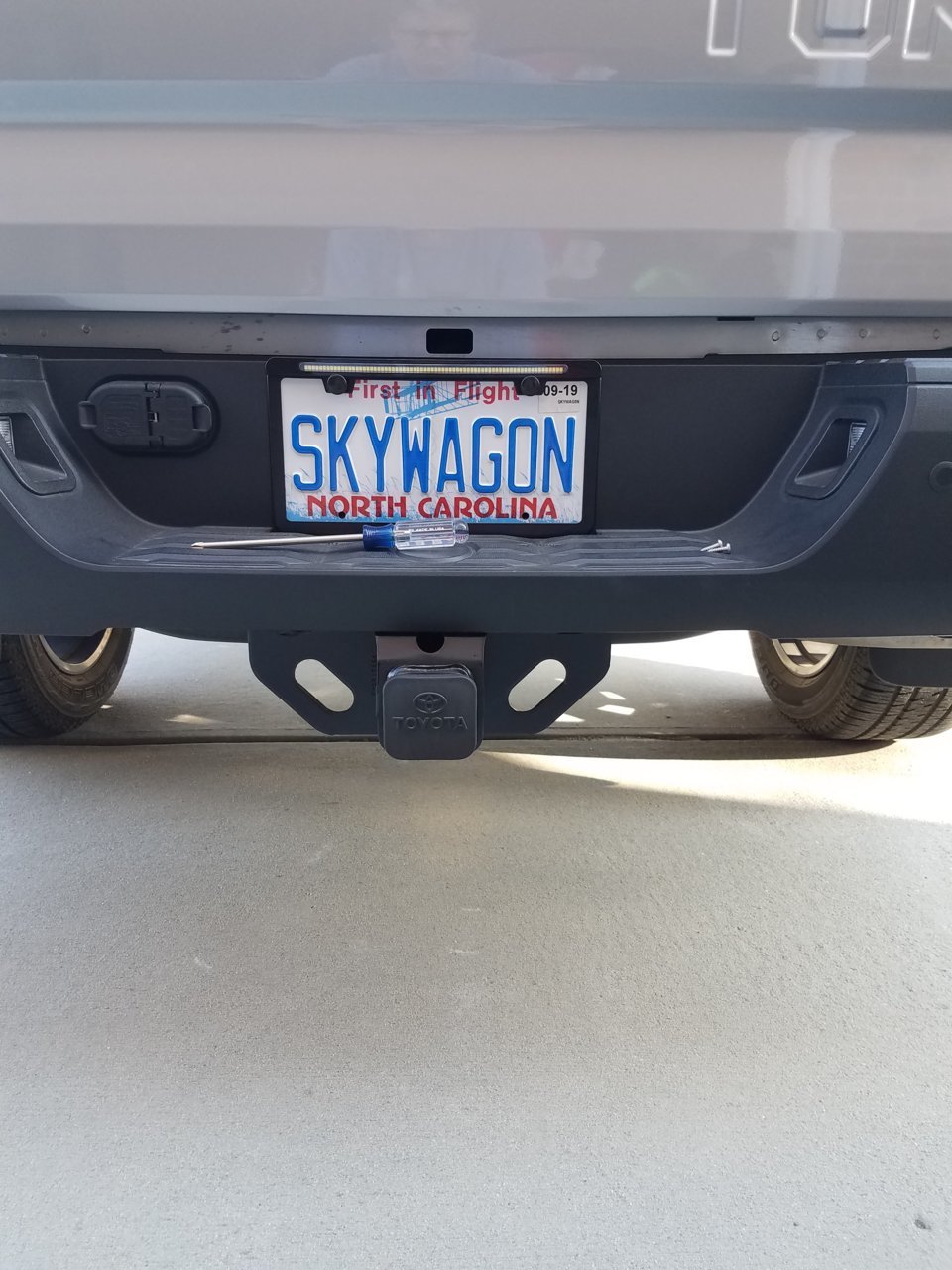

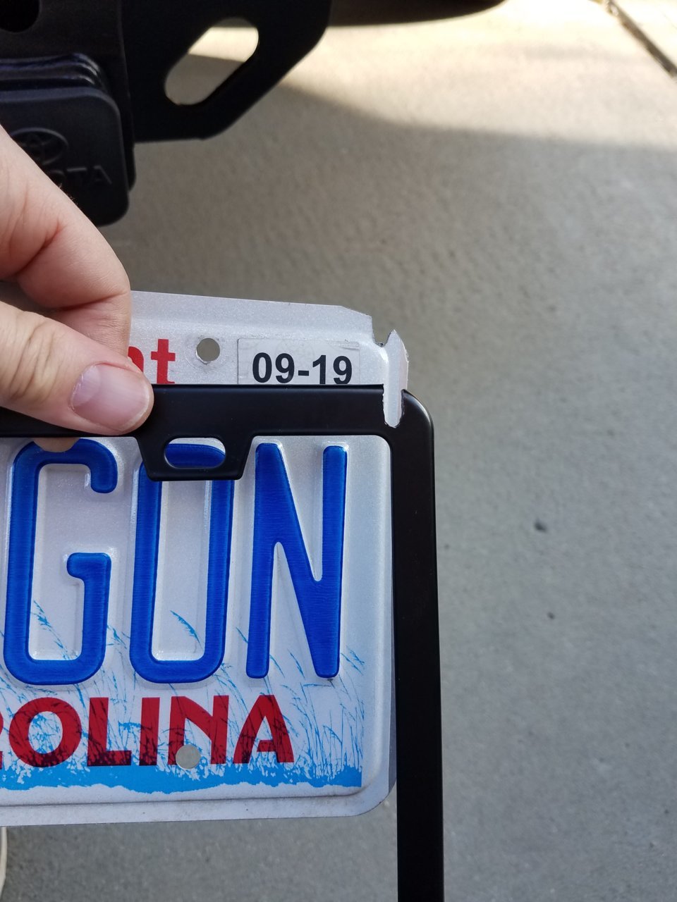

    Installed mine today. Have yet to try it out. I didn't like the look of the exposed license plate edges so I hacked up my cheap Amazon cover. (came with 2) Added a small nylon washer to help keep the light horizontal. Due to the way it is milled in the back to accept the plate it wants to tilt down without a small spacer of some sort. I wish they made the light as a complete frame. Not a perfect solution but as far as looks goes I guess it's a 5 footer.....
