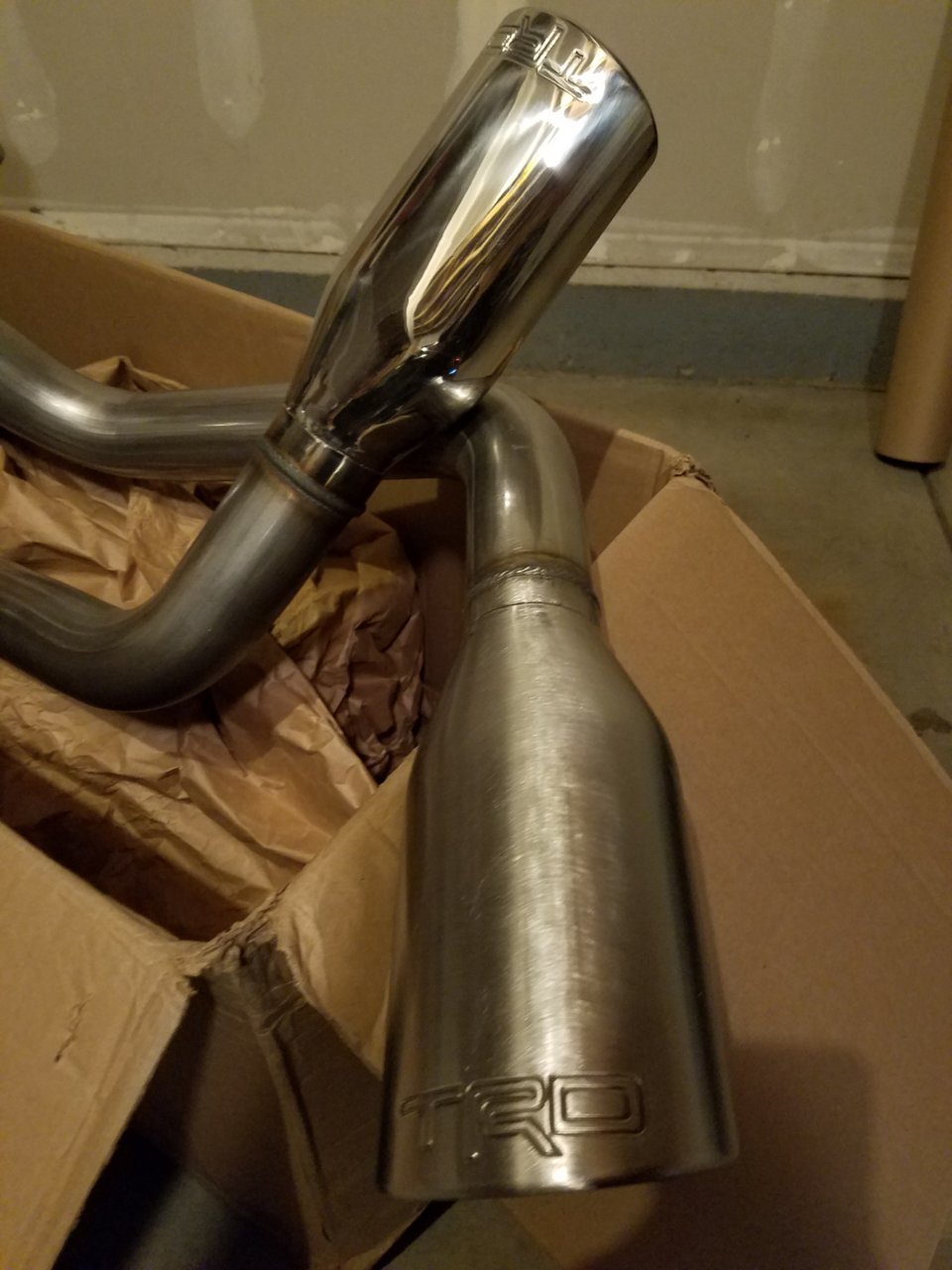

    I really wanna paint my tips black.. I want to hide that chrome.. What spray should I get?

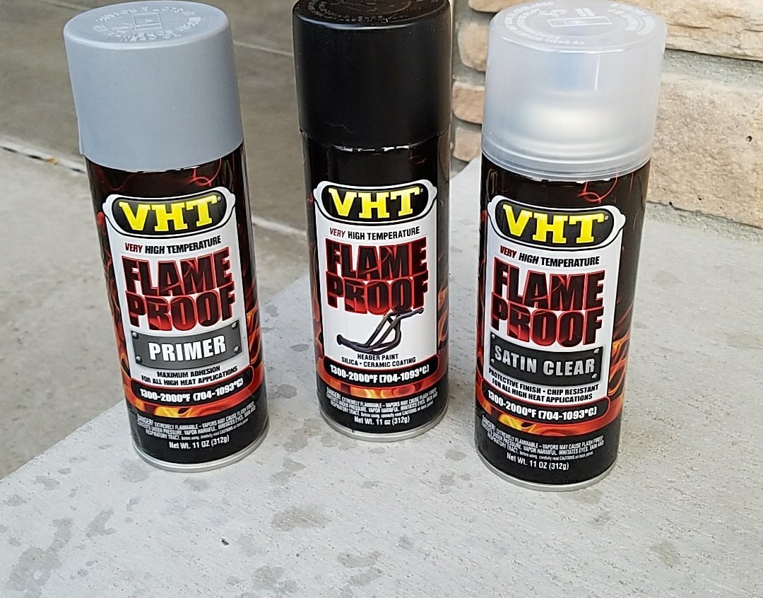

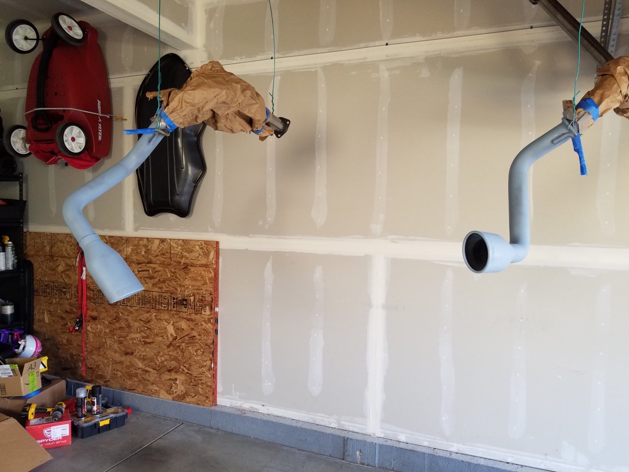

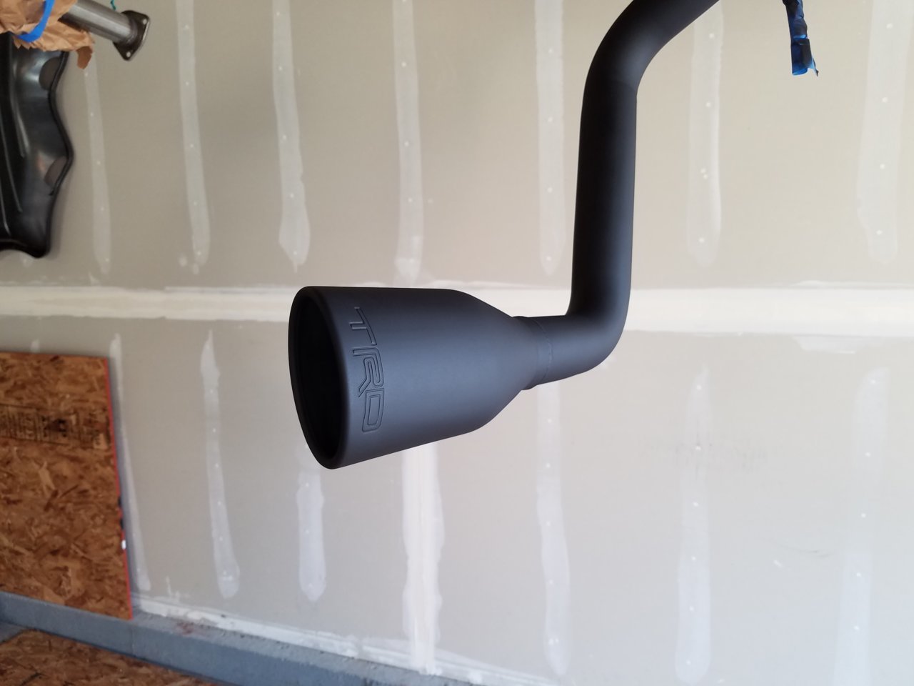

    I did mine using VHT paint. Had to scuff up the chrome quite a bit. Still holding up good after 8 months.
