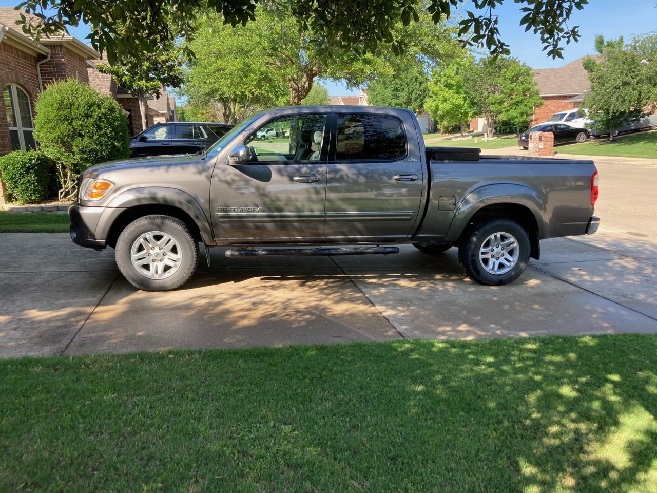

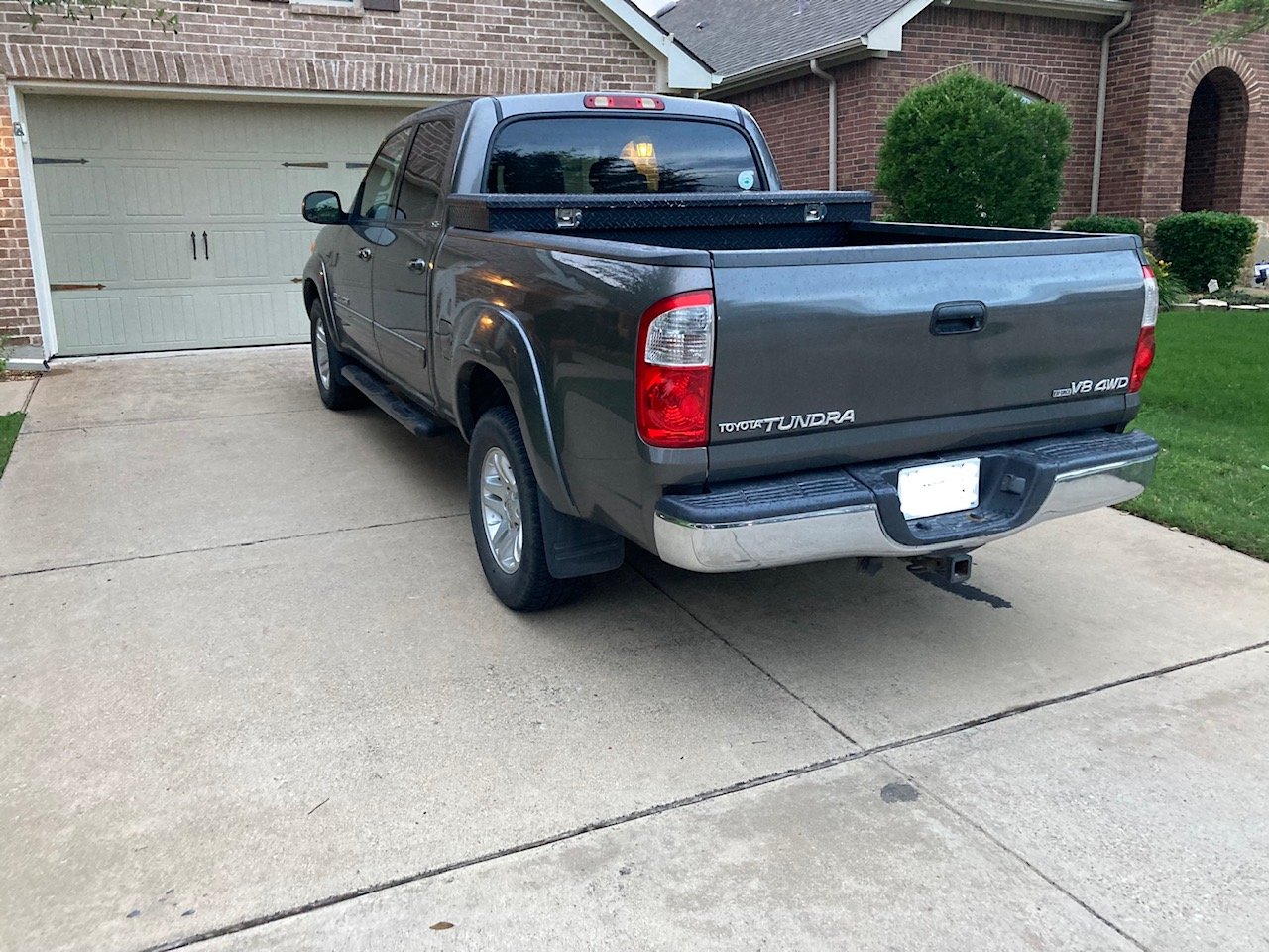

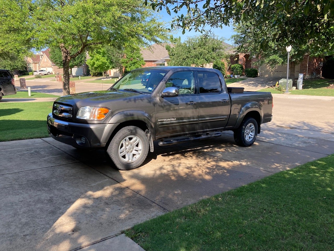

    Hey everyone,
    The quest for the 1st Gen has ended!
    Short Version - She's a 2004 DC 4.7L 4WD SR5 Phantom Gray Pearl. Pictures below
    Longer Version with details
    Been on the hunt for about 2-3 months. I'm in Dallas. There were some things popping up here and there, but really the options were relatively sparse considering I wanted a truck in decent shape and was being pretty picky about a lot of options. I figured I'd end up having to drive up to 6 hours or so to get what I wanted. When these trucks pop up in DFW they are gone in a heartbeat. So I was scanning Texas, Oklahoma, Arkansas, Louisiana craigslist and FB marketplace. Saw this one last week near San Antonio, so I drove down over the weekend and loved it. Brought it back home on Monday. Props to my wife who took care of our 3 kids solo on mother's day weekend while I was buying a truck. Yikes.
    Some extras that came with it as a bonus:
    • 17" OE Alloy wheels - previous owner has always stuck with the 265/65R17 that came on it. Love these wheels and probably won't ever change them.
    • color-keyed overfenders
    • keyless entry
    • privacy glass with the rear window defrost
    • tow package
    • daytime running lights and fog lamps
    • Line-x bedliner
    It has 180k miles. It's one owner and he was meticulous about maintenance. I have all the repair and maintenance papers since he bought it new in 04. He greased the zerks himself and did his own oil changes every 5k with mobil 1. I read enough threads over the last couple months to know to look at the frame, timing belt, LBJs. Frame is in good shape as the truck has lived in south Texas its whole life - photo evidence below. Timing belt and water pump were done at 165k. Interior is in 8/10 shape and exterior is probably the same. Paint looks great (I think it had to have been garaged) just has some minor dents and dings with some barely noticeable hail damage on the roof. The LBJs were replaced at 40k due to recall #70B. Looks like that is the last time they were done. It has a few little quirks, like the radio volume knob not working perfectly and some of the seatbelt buttons and door handles sticking, but really that's about it. He did use it for some boat towing, he estimated about 10k miles.
    Some things I am considering doing here in the near future:
    • Head unit with backup camera
    • Softopper (mostly will stay off but want to use it for longer road trips)
    • Maybe a minor lift/level (1" or maybe 2") , but I'm gonna drive these tires for another 5k or 10k then decide. I really don't want to kill my mileage or geometry and I really like how this looks stock more than I thought I would.
    I think I'm really lucky to have found a truck that checked so many boxes. To find a truck with frame, body, and mechanical components all in very good shape is tough. I'm gonna keep this thing forever. Attached are some pictures.... hopefully. This is the first time I've posted photos on here.image6 (1).jpg image5 (1).jpg image6 (1).jpg image5 (1).jpg image4 (1).jpg image2 (1).jpg image1 (3).jpg image0 (2).jpg image17.jpg image16.jpg image7 (1).jpg image8 (1).jpg image9 (1).jpg image13 (1).jpg image15 (1).jpg

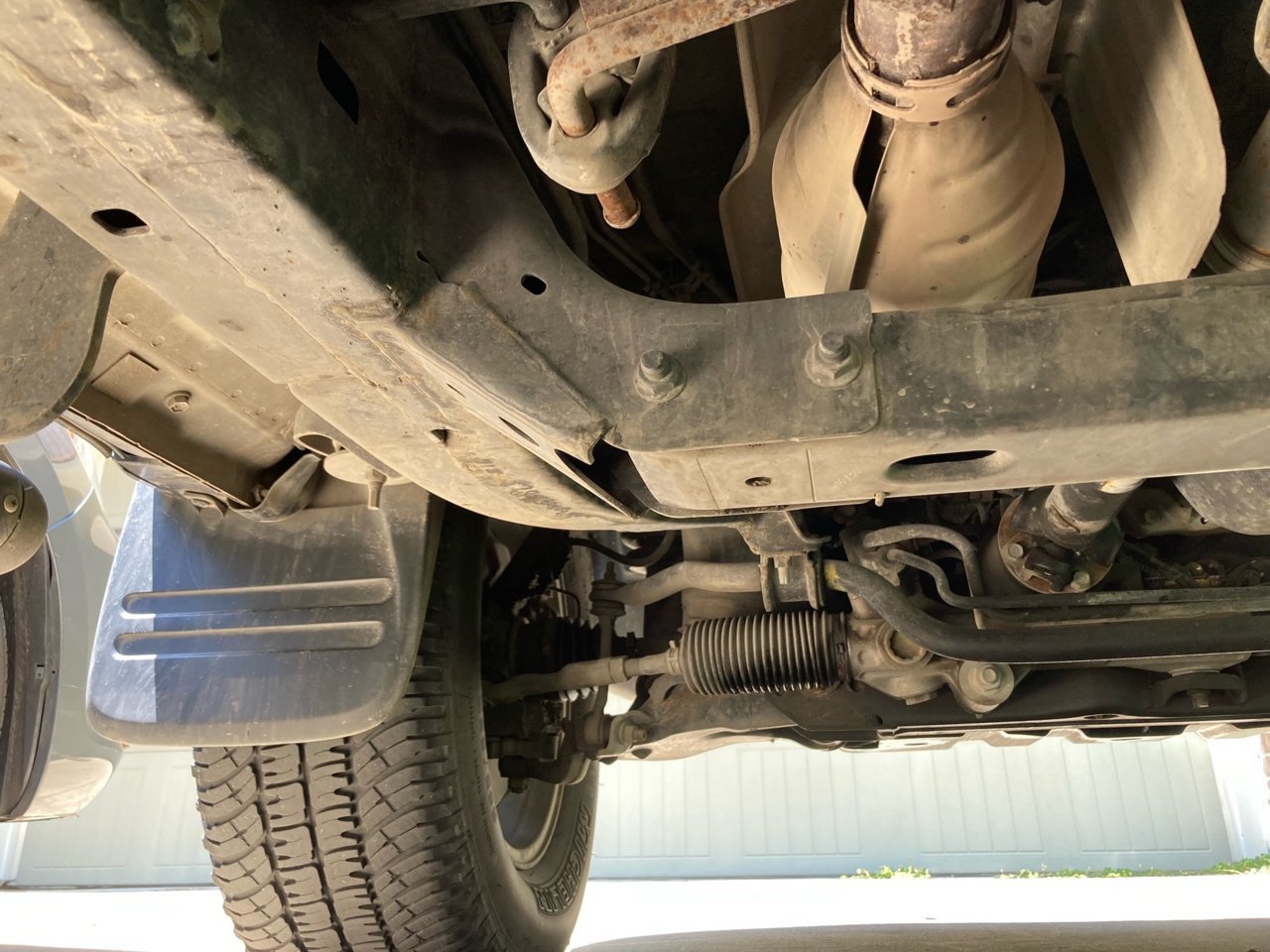

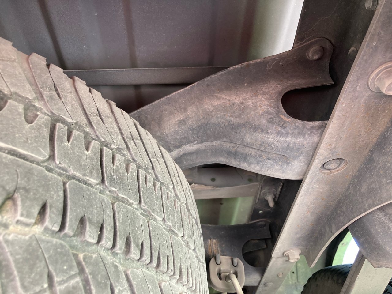

    Frame/Undercarriage looks excellent! Bang on the frame and crossmembers with a ball peen hammer to confirm.
    Rear Shocks appear to be original. Replace them along with the front struts and you will think you're driving a new Truck.
    Check the Hydraulic Power Steering Assist Cylinder. There may be some leakage there at the Boot (dark area). This is typical at your mileage.

    Thanks for the heads up. Good eye, I do see what you're looking at and I'll check it out!

    And re: rack leak showing on bellows that Demented pointed out. My truck has 75k miles, it's always had similar oil staining on the bottom half of the bellows. I plan on adding a little AT-205 to my reservoir in the near future to rejuvenate the seals a little bit. It's not a stop-leak product, it's just used to refresh seals and gaskets without over-plumping. You may find doing the same works for you. Add 1.5oz per quart of fluid in whatever system you're adding to.

    Nice find. Funny how a lot of the trucks I've seen here have a steering rack with some small weeping into the dust boot. Maybe it's just my imagination.

    Nope, I've noticed too, ever since I noticed mine.
