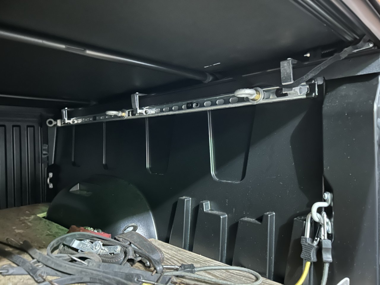

    Black out letters on tailgate, side steps, Ford tailgate liner modified to fit my Tundra : )
    Toyota has the torx head bolts in place. All I had to do was fit my $32 low profile unistrut to the locations, match up holes( had to drill two new ones) and bolt on. I used black oxide fender washers procured from McMaster Carr. Along with the black vinyl unistrut end caps for a nice finished look. Total cost, strut and all other hardware, $60.

    Welcome from LA (Lower Alabama)! Those look hefty enough to handle pretty much anything.
