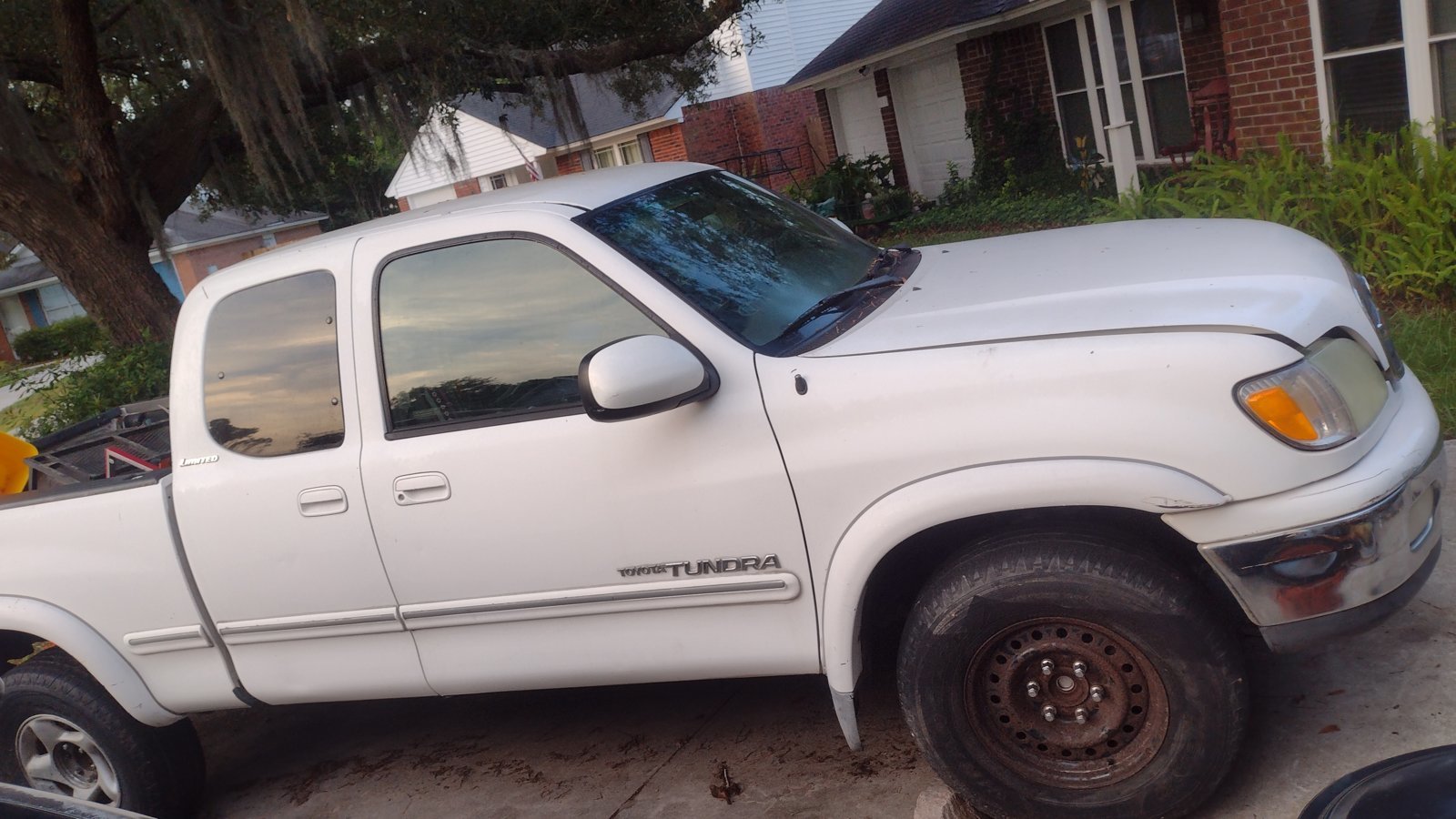

    2002 tundra access cab
    Work in progress lol
    I bought this 2002 tundra for a dynamic deal.... Or so I thought lol. It has a starter problem..... Previous owner handed me a fuse and said if it's not removed the battery will drain. Ok whatever lol.
    The starters bearing broke and the gear was stuck out. Ok new starter ( not denso oops) turns out previous owner while beating a hole in the top of the starter broke both knock sensors and wiring harnesses. Fixed that. I also decided it might be wise to change the timing belt so I did that. The truck started right up but was blowing water out of the exhaust after having both heads rebuilt resurfaced and head gasket. Started to write up and ran perfectly but the damn power steering pump was pouring out! Replaced that!

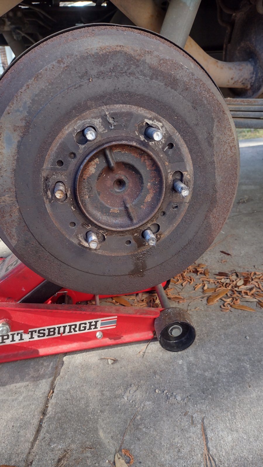

    So then I go to drive it, almost no brakes! So the previous owner let the brake shoes get so low and ride on metal for so long that it elongated the brake drum holes not to mention that 5 out of the six wheel studs where cross thread and barely holding on. I'll replace all those parts. So it turns out that the rotor in the front is so worn that it overextended the caliper Pistons bent the caliber backwards and broke the lower mount bolt!

    Looking at the mechanism doesn't let it adjusts itself when you drive backwards and stop?

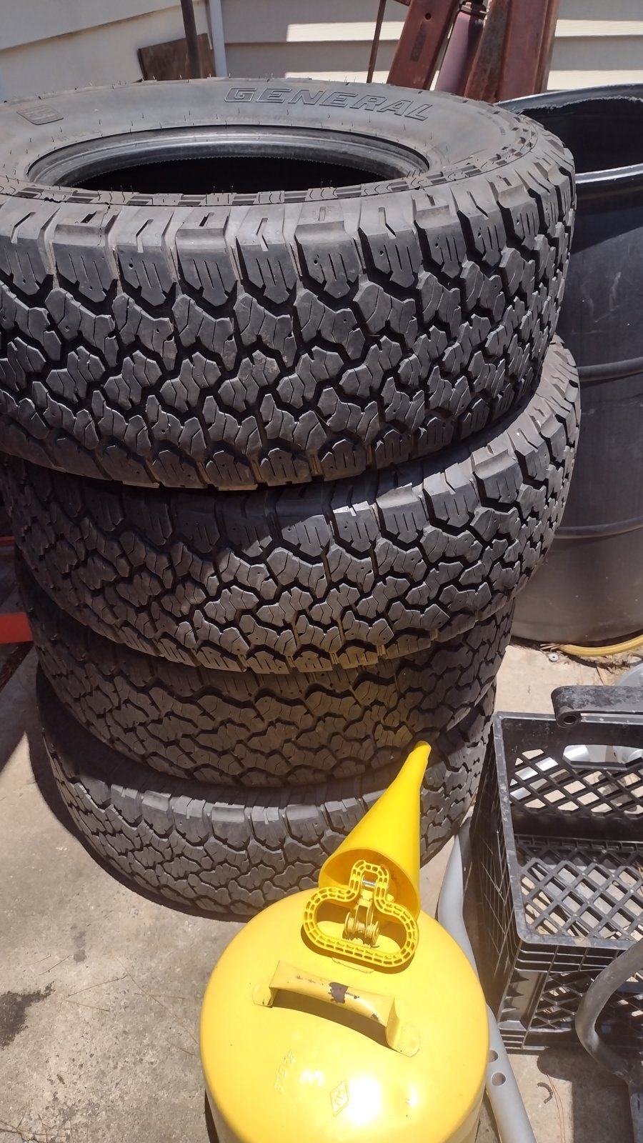

    I got free tires I'm excited!

    Those drum holes look drilled

    Explain yourself. Those look mint

    No it because only two lugs were tight rest cross thread and riding metal to metal long time
  21. Jun 7, 2024 at 10:09 AM
    VWmanwithTundra
    VWmanwithTundra [OP] New Member
    May 17, 2024
    #116995
    52
    Kevin

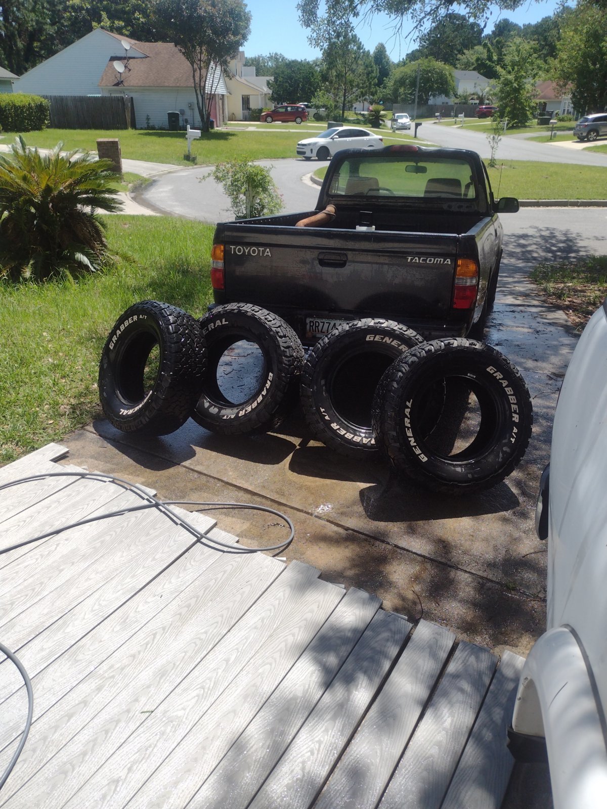

    Found them at the dump they have 90% tread one has a nail in it but whatever

    KNABORES
    KNABORES Sarcasm incoming
    Jan 1, 2020
    #40572
    13,913
    Arkansas
    Date code?
    OldGuy03 likes this.

    My reading on the subject suggests that it adjusts every time the E brake is used. For trucks without a manual trans, this may be a rare occurance!

    Nice score. As mentioned, have you checked the date code on the tires yet?

    Shit. If they mount and balance and hold air. You are fucking winning. Go buy a lottery ticket

    those are actually great tires!
