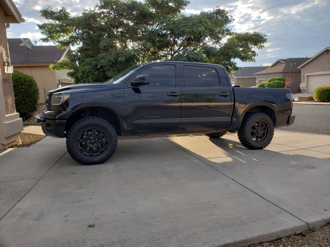

    I am at a loss I purchased my tundra about 6 months ago and have had issues since I bought it. I just took it today to another mechanic and told me I am intermittently throwing misfires on almost all cylinders and no codes are being thrown or pending. If I accelerate heavily over 4500 rpm it feels as though a rev limiter is being hit. I changed out the spark plugs my truck has 85000 miles on it. It is 5.7 flex fuel. Please need help I love this truck just running into a wall at this point in fixing.

    Here she is
