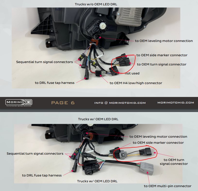

    By chance, do you have these harnesses installed?
