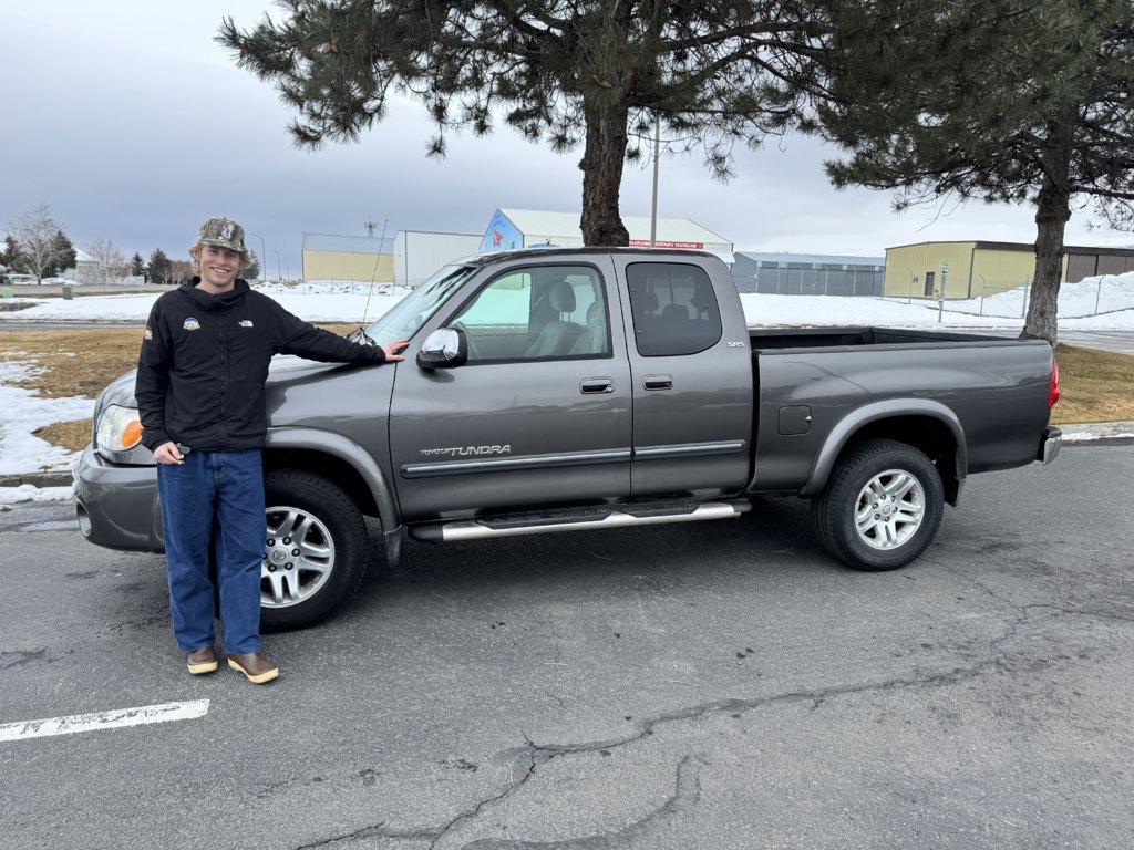

    Hey guys!!
    Drove out to Eastern Washington from Montana to pick up this beauty this past weekend! It's been a long time coming and I could not be more excited!
    All the big ticket stuff have has been done, with paperwork, LBJ, timing belt etc!! She's a beaut with 136xxx on the clock.
    I am planing a very practical build on this truck to be the ultimate daily driver/camper special/ski, surf, mountain bike rig.

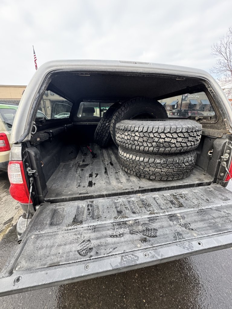

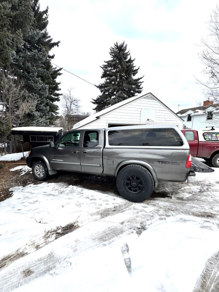

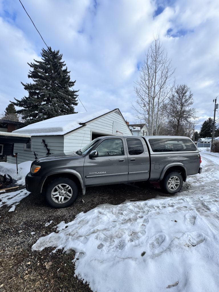

    Some updates from this week. I removed the running boards and found a beater topper for 150 bucks to keep the snow out and to use until I find a better option. My wheels, tires and all suspension parts are here so everything will go on this weekend!IMG_6964.jpg
    One tire lined up albeit heavily raised in comparison by the snow. 255/80 R17 Yokohama Geolander AT4

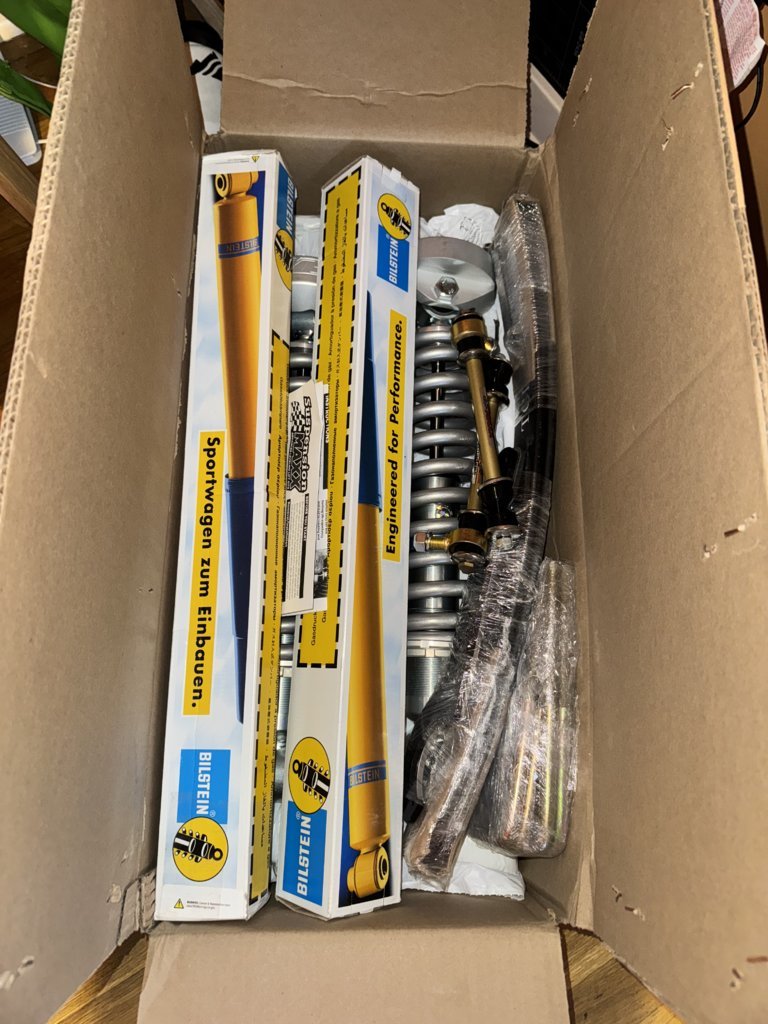

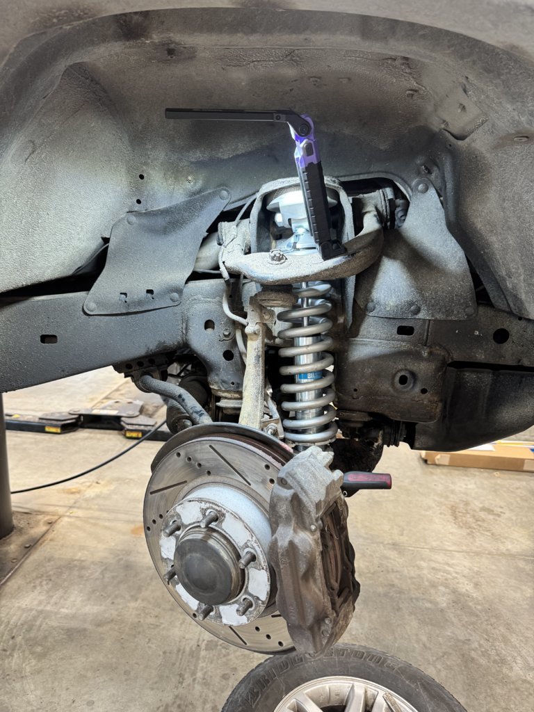

    Toytec 650lb Springs with 5100's on all four corners plus a Toytec AAL. I am also adding some Suspension Maxx sway bar end links (extended). I think my lower control arms are good and both ball joints are good(replaced w/ OEM 25K ago). If there is anything else you guys think I should tackle while m under here let me know.

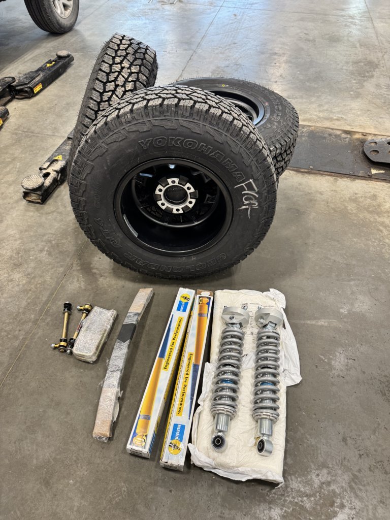

    The Toytec Ultimate kit is in and looks awesome.

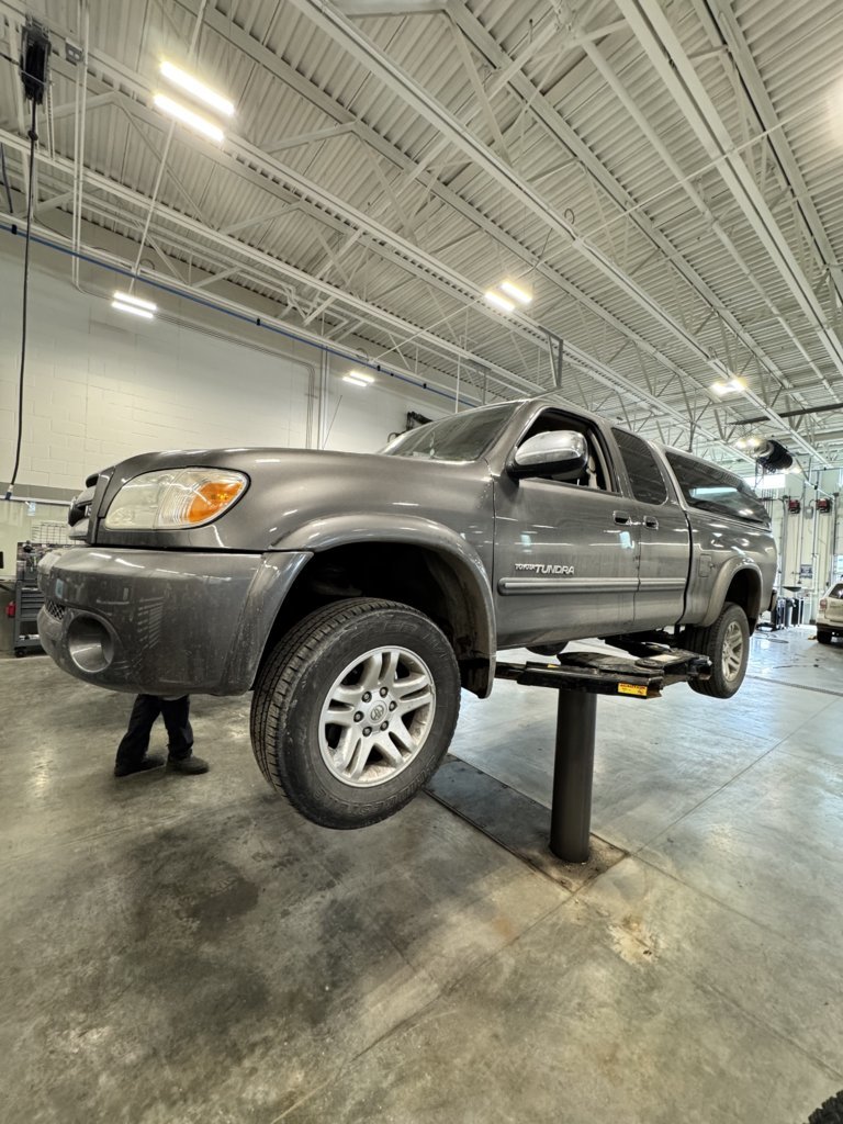

    Pre lift

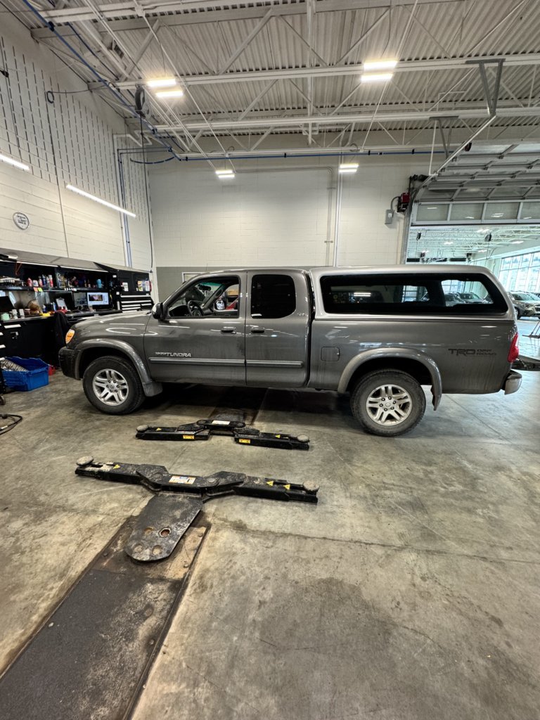

    Luckily a buddy of mine works as a Tech at a Subaru shop so we could use the lift and all his tools
    New parts laid out!

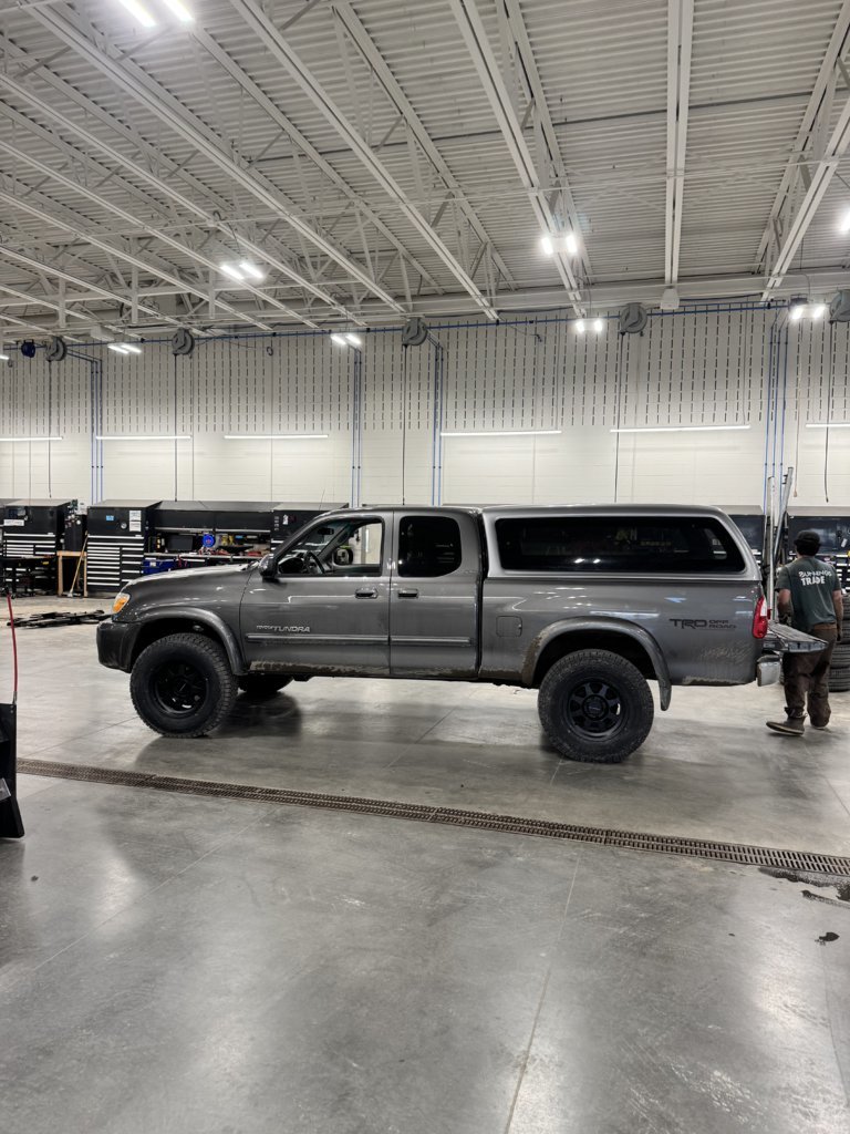

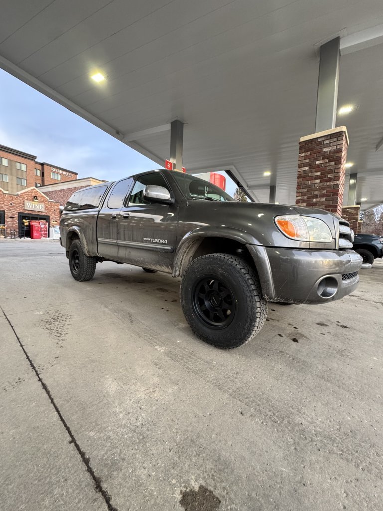

    It was a huge pain getting the front assembly in. If anyone ever installs this kit, putting the springs at the lowest height and using a concerning amount of force with pry bars was the only way to get the bottom eyelet lined up. I also found setting ride height on these shocks is a pain. 24 exposed threads on the bottom gave me just over an inch and half of height.
    Beer helps!!
    How she sits now
    Toytec Ultimate kit with 5100s on all for corners and an add leaf.
    Suspension Maxx extended sway bar end links
    Method 701s 17x8.5 with 0mm of offset and 4.75 inches of backspacing
    I am selling all of the take off parts so if anyone wants some beater stock 17s and some clapped out suspension let me know lol.
