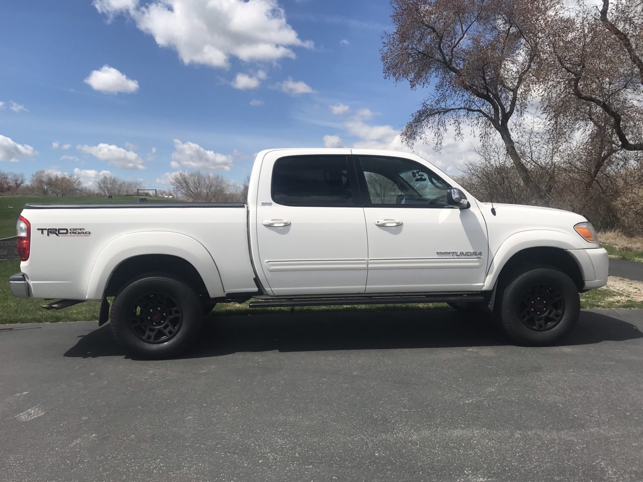

    Tires, wheels and lift is done.
    Problemas- The suspension performance has improved but the OME 2.5” lift is too tall for me. I don’t like it, it’s a no go.
    I had Bilstein 5100 on the front set at 1.3”, rear was stock. I thought the OME 2.5” would give me 1” more height in front. That’d be perfect. Nope, it raised my truck level with 3.5” in the front. I’m not sure how much the OME leaf raised my rear but i think its at least 2.5”.
    I’m starting over. I have the old Bilstein’s from the front and have considered reinstalling them but I would need rear shocks (the stock shock were shot) and the whole point of these upgrades is to improve ride and suspension performance.
    I’m now considering bitting the bullet and replacing the OME lift with Icons coilovers and rear shocks from Toytec. Setting the fronts to 2” but what do I do with the rear? I know the Icon rears shocks are adjustable also but I’m not going to get any lift out of the shock, right!? It’s the added OME leaf raising my rear, right!?
    I don’t want my truck to be level, I like a bit of rake. Optimally I’d like my tundra to have 2” lift in the front and maybe 1.5” lift in the back, over stock.
    Also, in another thread they were recommending oem upper ball joints. Is that something I should also be considering?
    Anybody interested in a used OME 2.5” lift?
    FYI- I’m almost 58 years old and I love my old school tundra. It fits my lifestyle. I’ve had it for 8 years and am planning on at least another 8.
