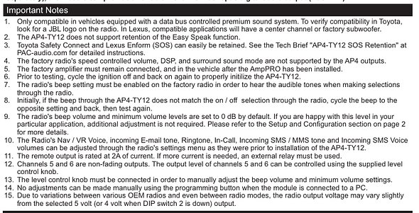

    Here is the manual if you don't have it.
    541AP4TY12
    #5 Did they leave the OEM amp in the truck?
    In all honesty, you're probably better off with the new HU, but it sucks you were pressured into buying it..

    Yes it would be under the passenger's seat..
    I don't know anything about the PAC-AP4TY12 LOC, I was just reading through the manual to see if I could find anything to help...
    Although with your JBL, I believe volume, left/right balance, and front/rear fade are all controlled by the OEM amp and not the HU.
    It is one thing that makes upgrading a JBL Tundra more challenging than a non-JBL Tundra.

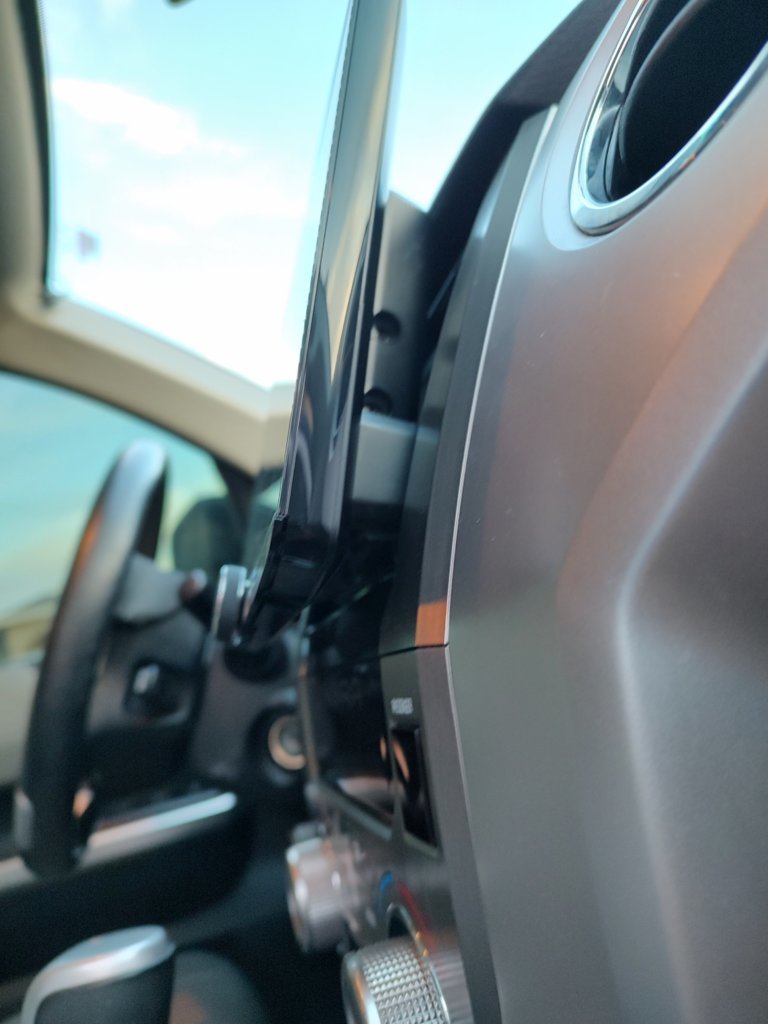

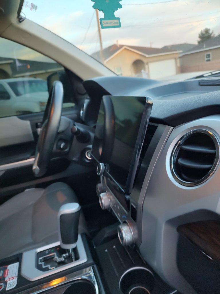

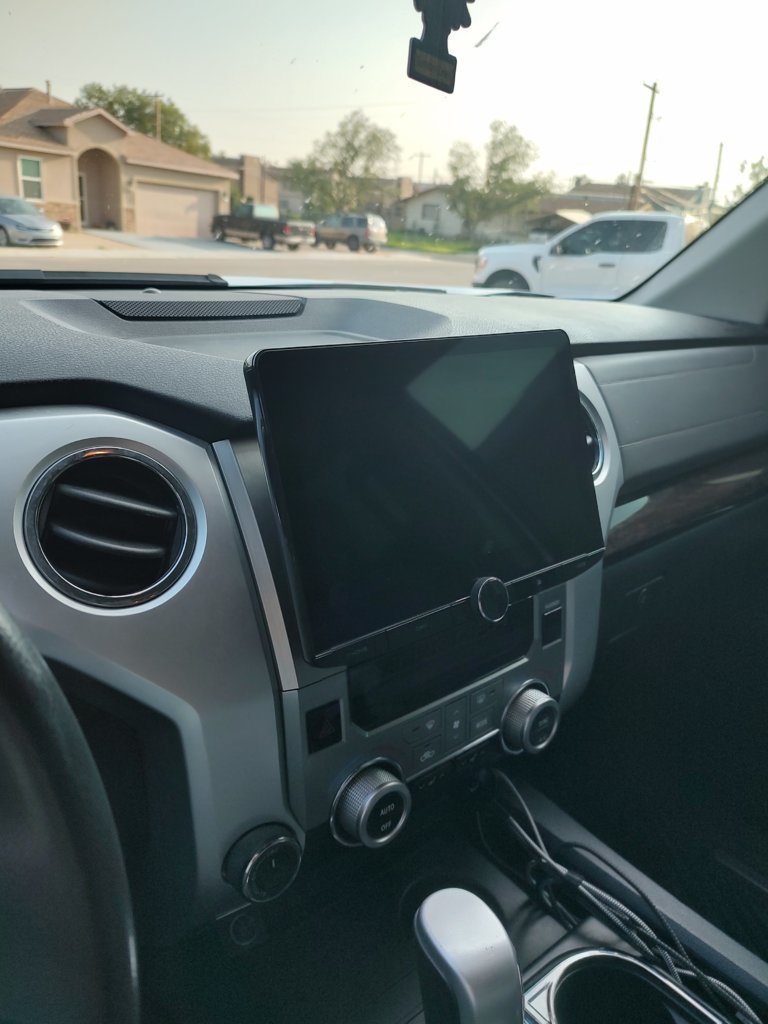

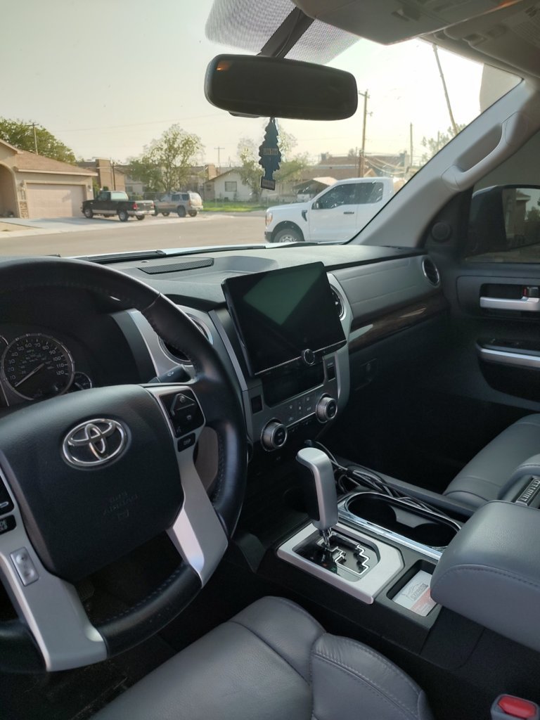

    Here are a couple of my DMX1057XR. Pretty much the same screen. My HU just doesn't come with navigation.
    If you want a different angle I don't mind taking a few more pics :thumbsup:

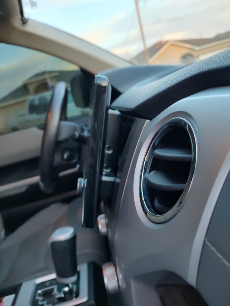

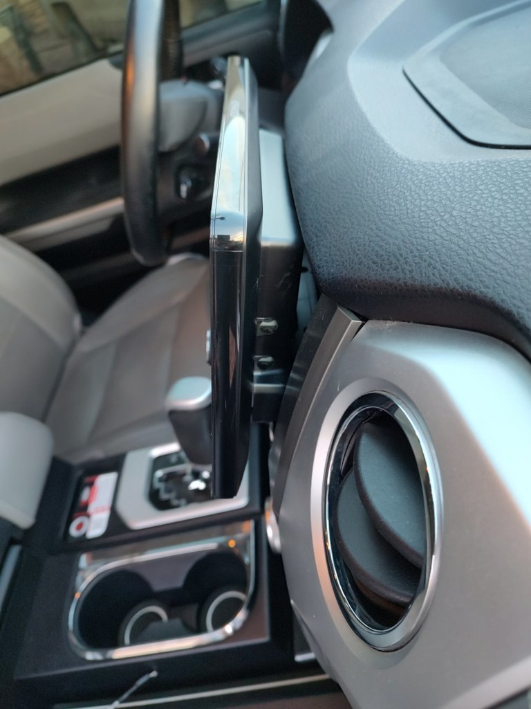

    Thanks! I’d like to see what the gap looks like between the screen and the dash. If you can side shot from 3 o’clock that would be awesome.

    Here you go my man:

    Perfect! Thank you very much. The stinger HU I have in there now is nice and tight to the dash but it covers the climate control panel. I hate it.

    No problem! I opted for this look, but you should be able to adjust it closer to the dash. Enjoy the new head unit!:bananadance:
