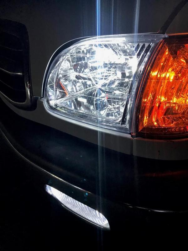

    Those Morimotos look cool and I actually considered doing them. What stopped me from pulling the trigger is all the work to do them plus the huge cost projectors. I added it all up and was over $500 in parts alone and then comes the work and risk of a leaky housing.
    Actually having never seen the Morimotos live in person, I can’t offer any feedback on their performance other than to take peoples word here for it. Their projected light on the wall looks good, but so do the LED Katanas at low beam. High beam is a little streaky with intense light, but who cares as they are for flashing and driving without oncoming traffic.
    LED’s have a bad rap from the early models which is why I waited and carefully reviewed. The tech is there now and if you get the CREE or Philips chip in whatever your LED its a good one. Even Morimoto has gone through changes in various models and working now on version 5?
    Still haven’t been flashed or had anyone turn their rear views down at me as I used the SAE guidelines for aiming. Plenty of youtubes and internet coaching out there and even the SAE site can guide you.
    I’ll never go back to incandescent head light bulbs as the light isn’t sufficient. Its your money. Spend it wisely.

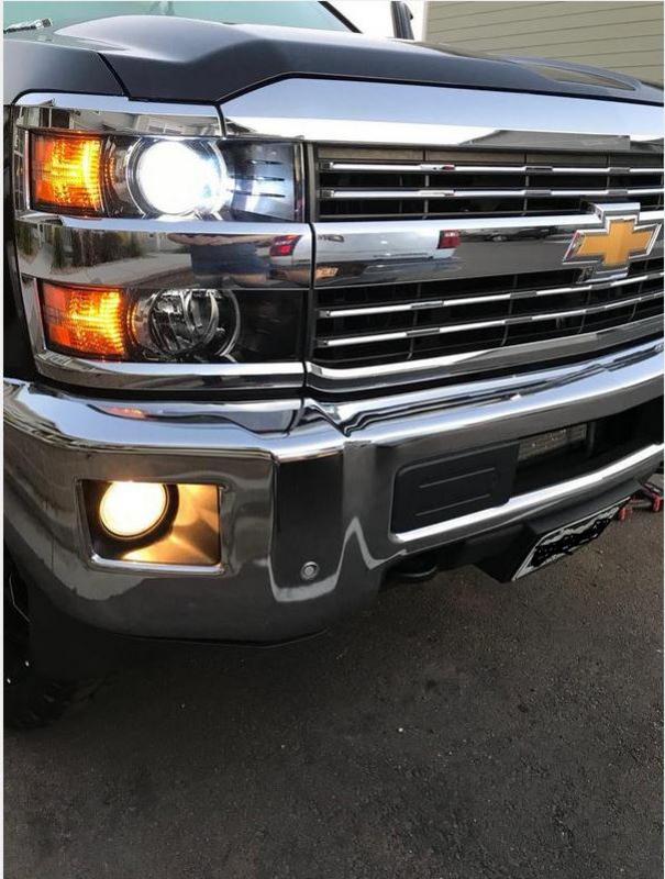

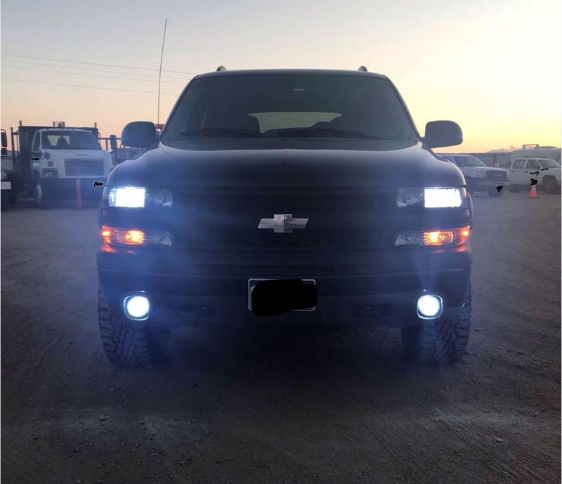

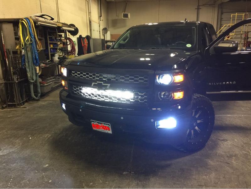

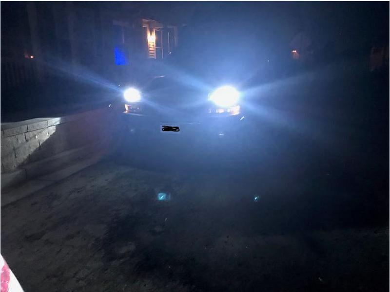

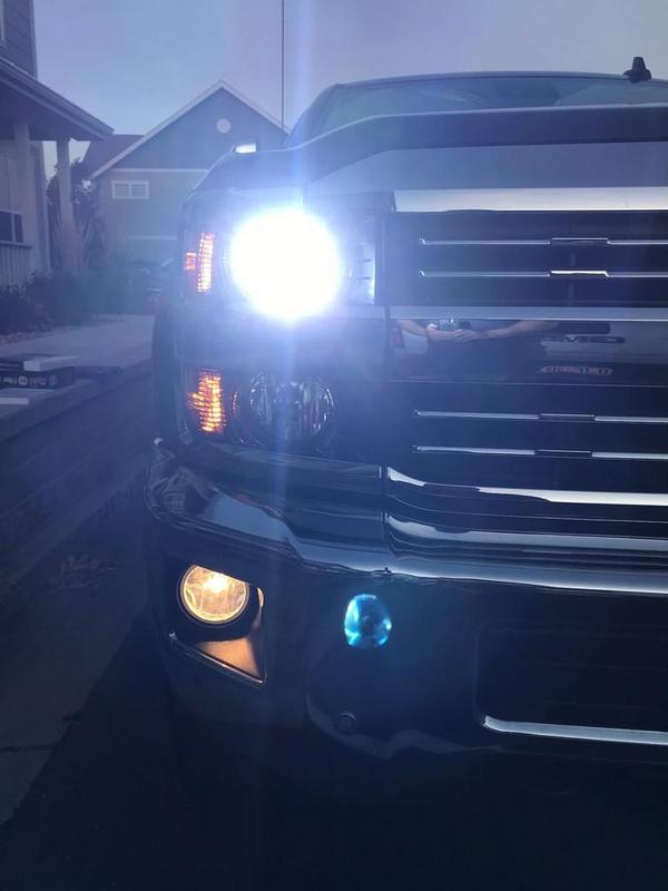

    Here is what I have in my truck:https://www.amazon.com/XtremeVision...9?keywords=9003+hid+kit&qid=1573851246&sr=8-9
    I know people will say that I am wrong, but I have always ran HID's in all my vehicles with standard reflector housings since 2008 with no issues. It comes down to properly aiming and aligning your headlights once they are in. I personally feel that there is no better performing bulb other than HID's on the market. Don't get one of those goofy colored bulbs and stick with 4300k, 6K or 8K color temperature. I usually adjust them a a notch or two down from what is recommended by the OE manufacturer and never have anyone flash me. For $34.99 and plug-n-play, you can't beat it. There is a reason vehicle manufactures are switching to HID/LED technology.
    Here is 6K's installed on my Tundra:
    Here is 6K's installed in my '16 2500HD:
    You can see the major difference between HID and standard halogen bulbs in these two pics:
    A few more from previous vehicles. These were 8K bulbs and a little too blue for my taste thus why I started running 6K's. 10 years ago, the 8K's had the slightest tint of blue to them and the 6K's were pure white. Over the years, that has changed.

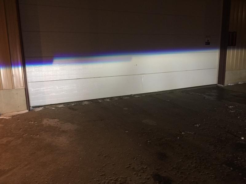

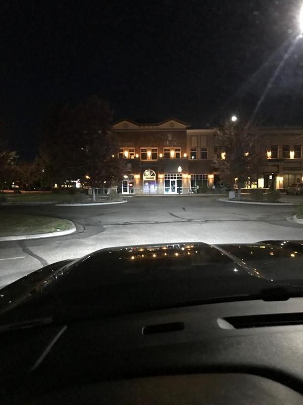

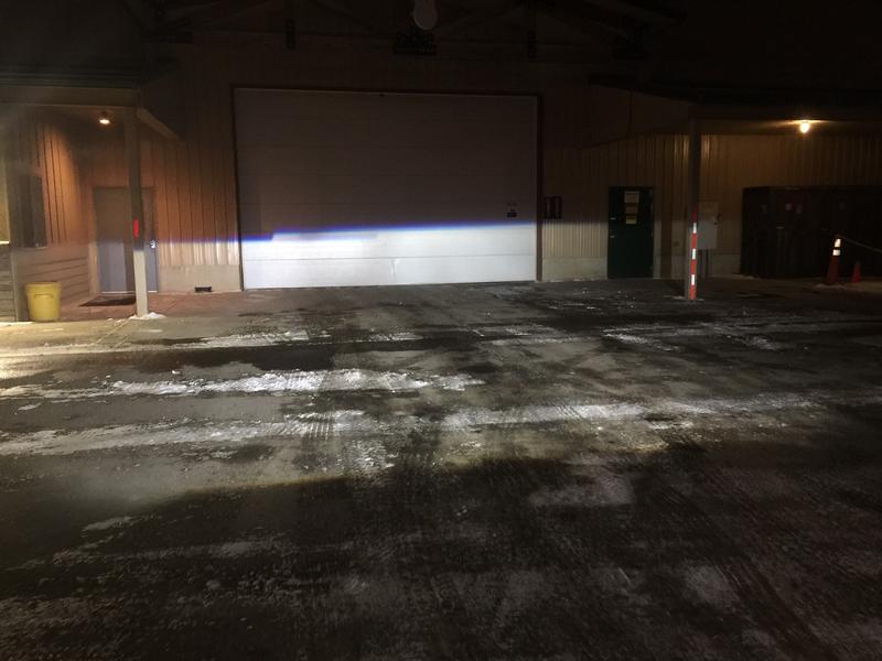

    3” drop from center of light, at 25’ I believe
