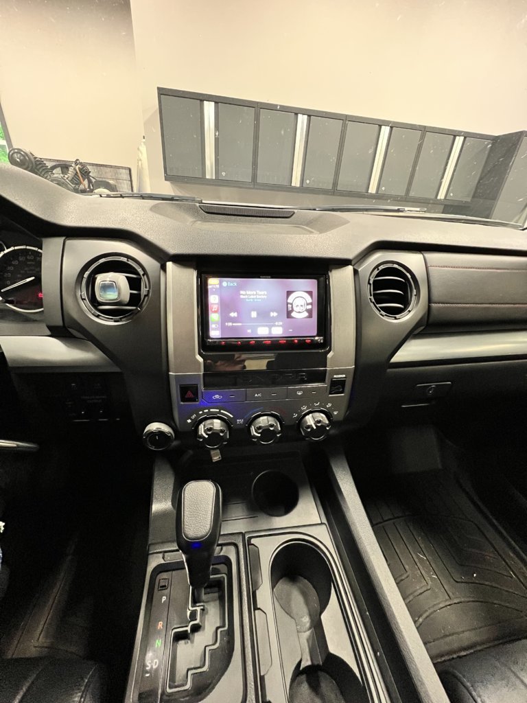

    IMG_1374.jpg First thing I changed when I got my 2017 TRD PRO was rip out that crappy ass head unit and replace it with something that sounds far better. Do you currently have JBL or non JBL setup?

    Can’t remember if my old head unit is JBL or non JBL. Have to look when I get home. Changed the wimpy amp out too with a 5 channel JL Audio DSP amp. Absolutely amazing sound
