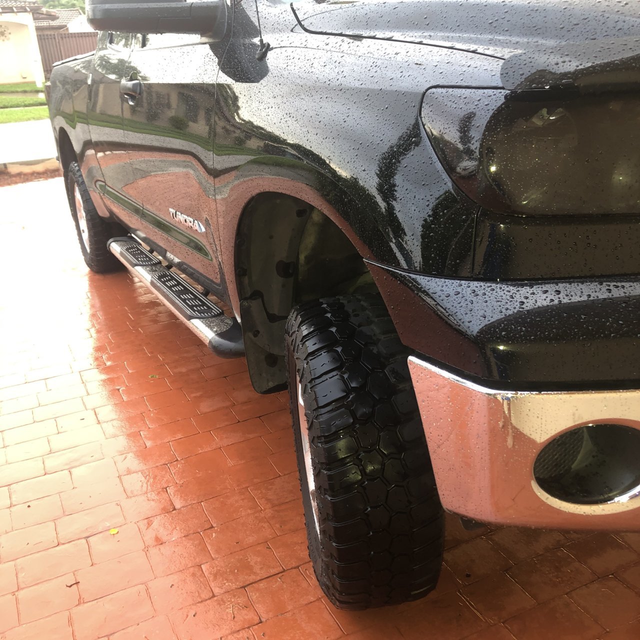

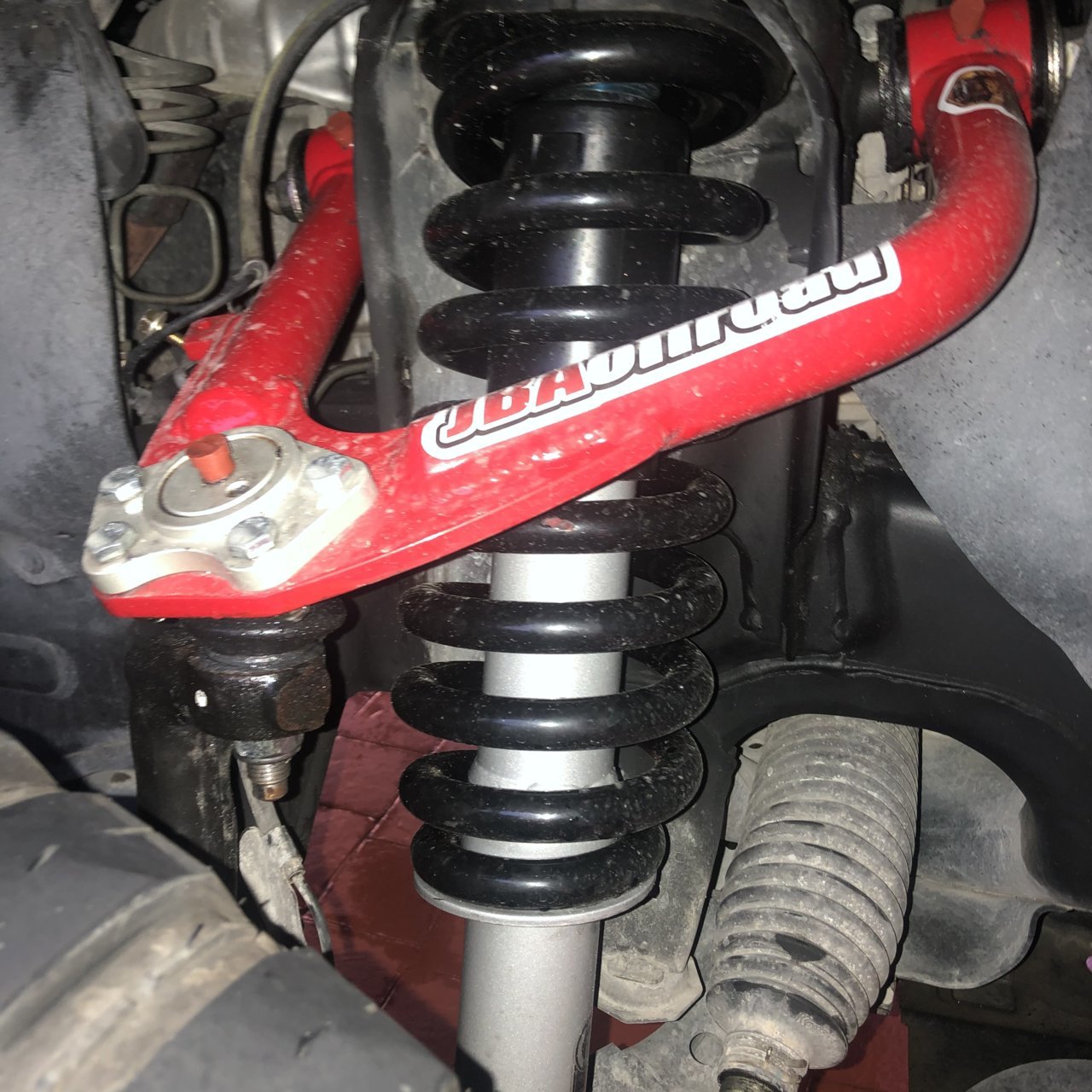

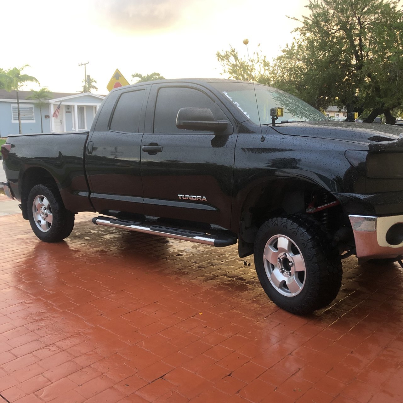

    Just a headsup I have 4" of lift in the front because of a small shim spacer, these pictures are sitting on an incline but there is usually a slight lean I would probably be better off with a 1" block but I don't want to go through the hassle, either way 3.5" will make the front higher than the back. Less noticable with the rollers on the truck because they have a slightly smaller tire but this should give you an idea of how it looks.
