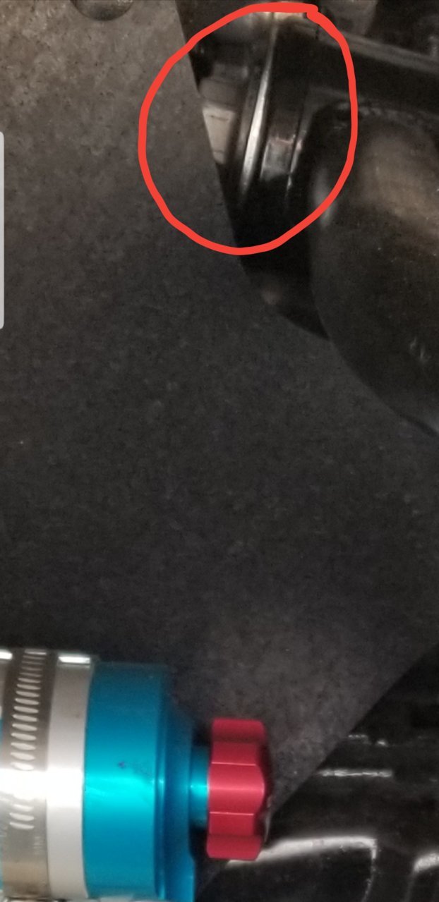

    Are you talking about this?

  11. Nov 4, 2022 at 1:18 PM
    808Tunderer
    808Tunderer New Member
    Aug 29, 2021
    #67384
    77
    2021 DubCab SR5 4x4 TRD Offroad
    Stock
    Were these just installed, or have you had them on for awhile- never mind just re read your post. The metal crunching/grinding noises from passenger side seem alarming. Did a shop do the install?, I would take it back to them if you trust them.

    Okay. Yeah that pic was from the day it was installed.
