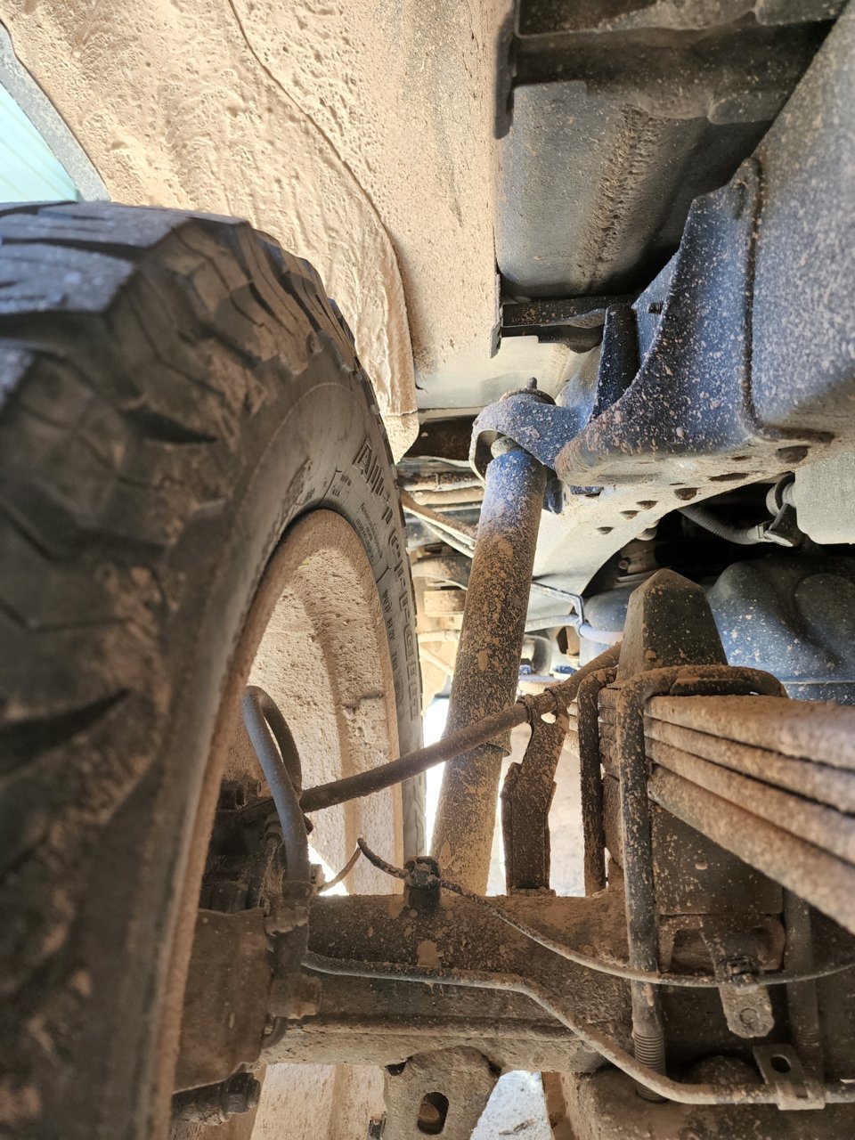

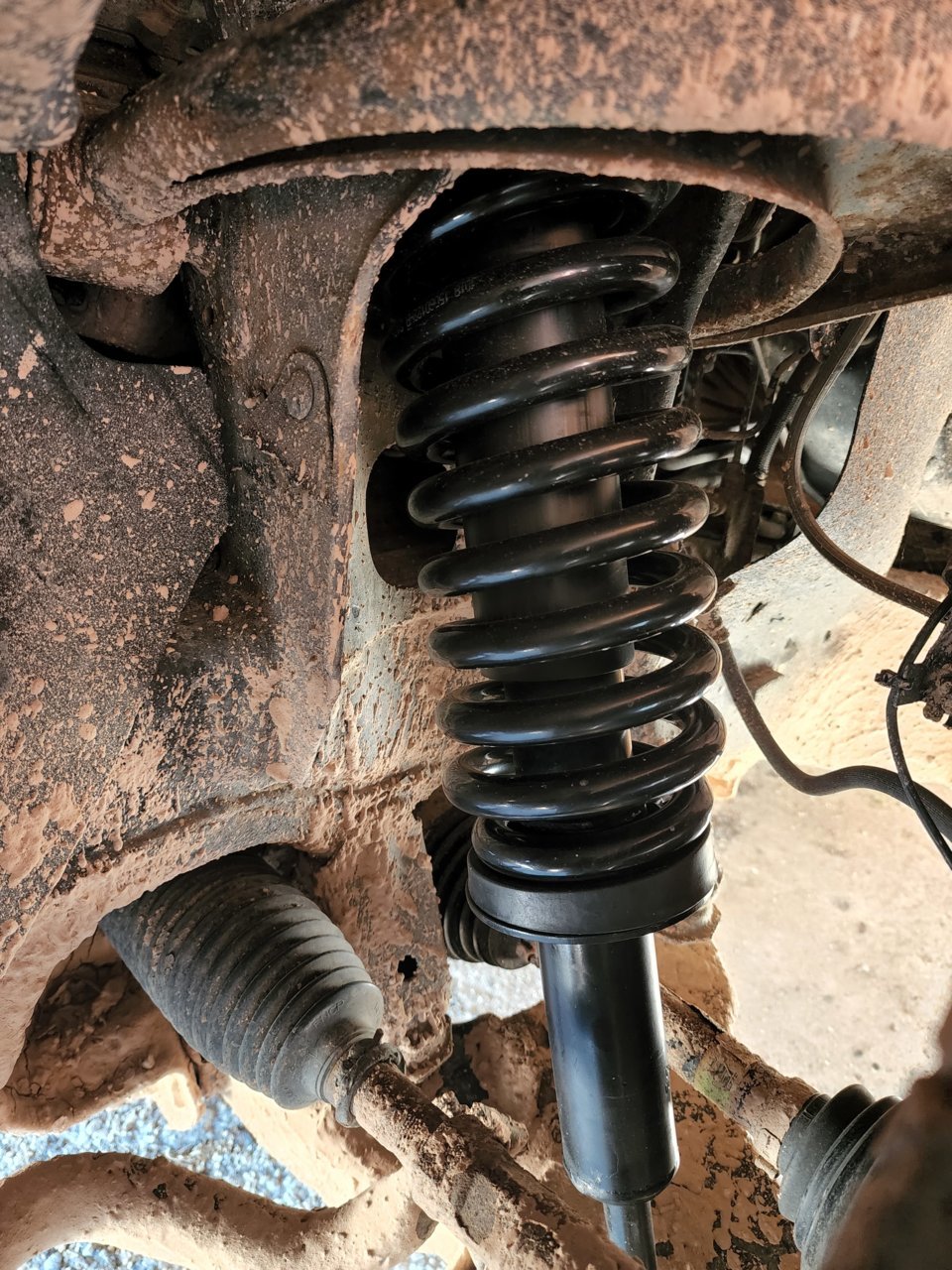

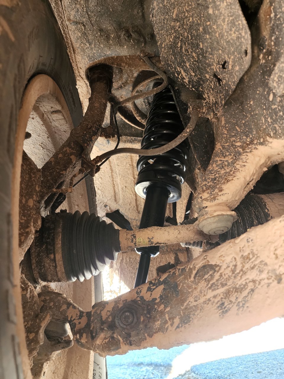

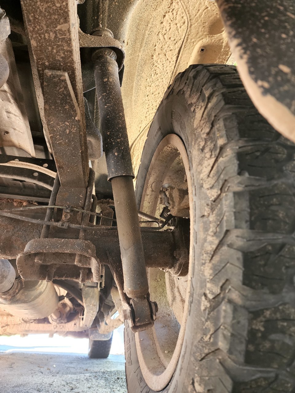

    So unfortunately I don't have any before photos from the front end. I did go out and get the attached photos of the front vs the back right now. The back is still lifted and the front isn't. Only the front struts were replaced.

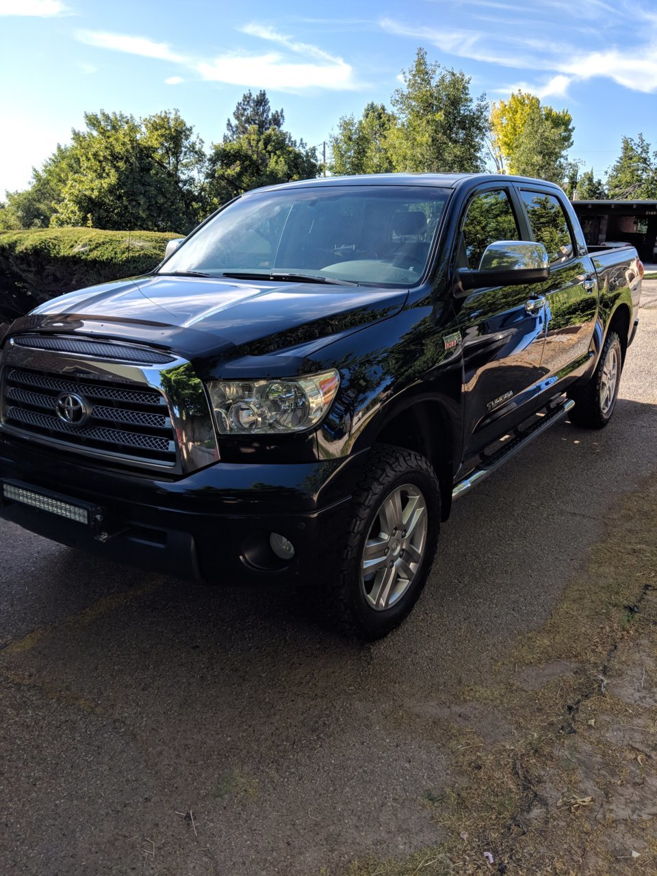

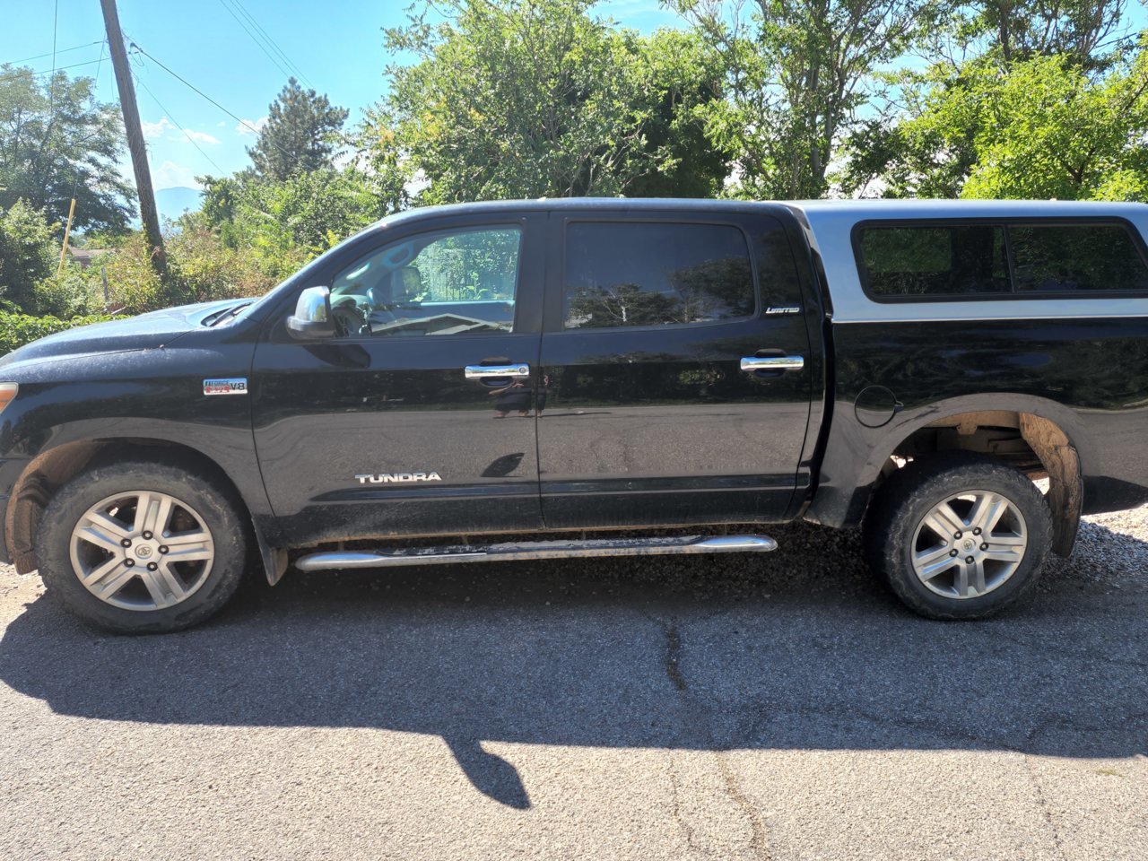

    Also here's a before and after of the truck itself. A bit hard to tell in the before but you can see in the after (the photo with the shell) that I'm missing a few inches in front.

    Looking at the photos, it has a 2 inch block in the rear. Now I'm wondering if it had a Readylift spacer kit in the front and the spacers were removed and not reinstalled after the front end was replaced. Option wise, it depends on what you want to do. If you plan to go bigger tires at some point, I would lift the front end again. If not and you want to level it back out which would drop the rear 2 inches, I would remove the rear blocks and brake line extension brackets, and replace the ubolts. Do not reuse the ubolts. A new set is about $40.00.

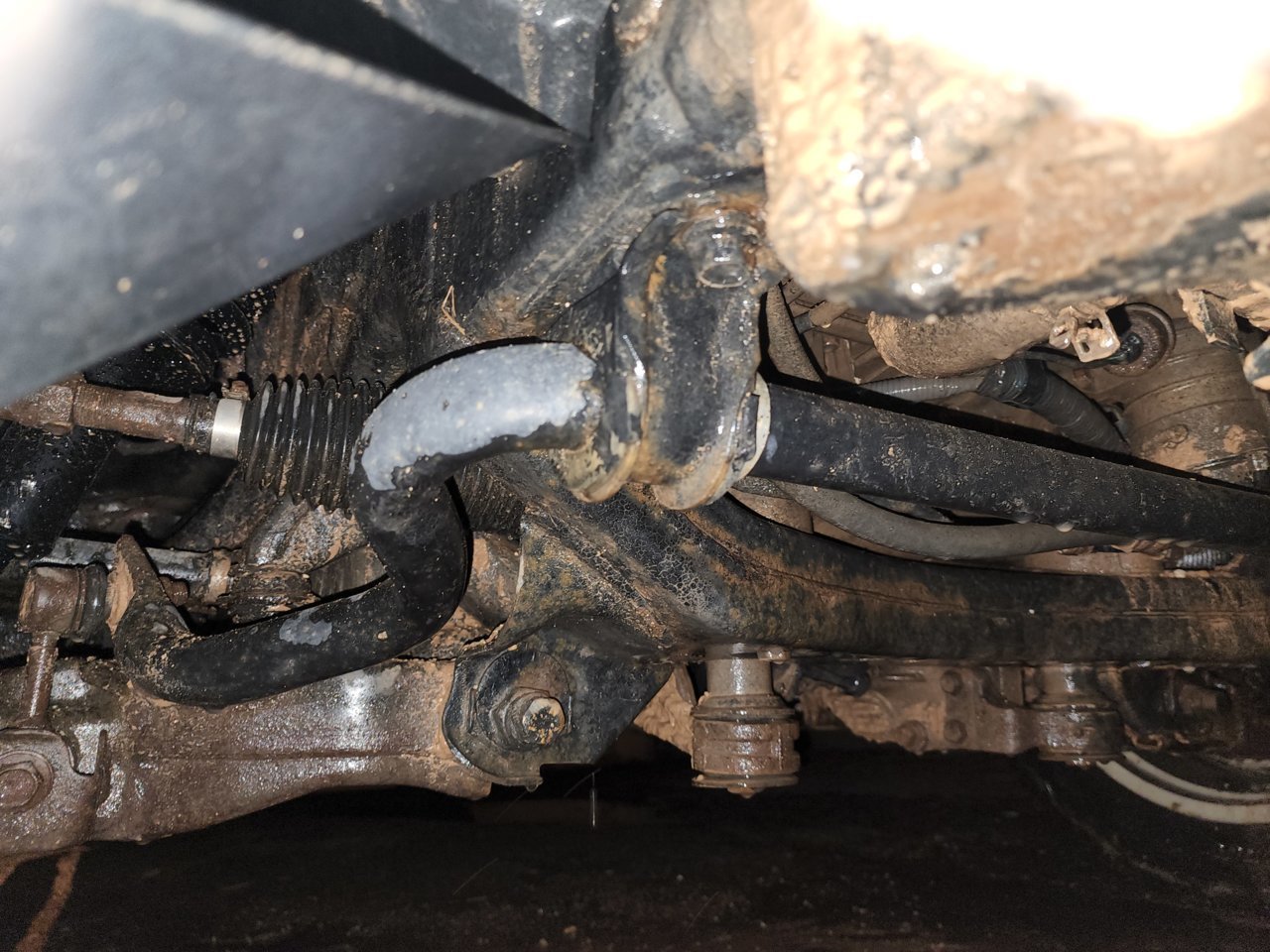

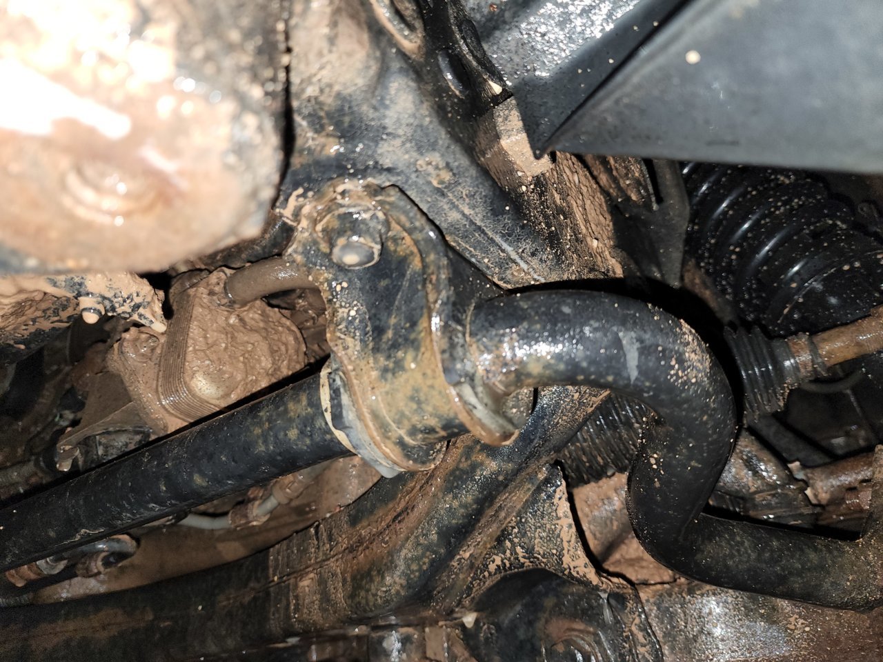

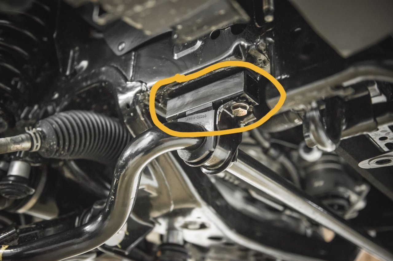

    Ok so here is what I think is the part on the sway bar that I'm supposed to be looking at. Doesn't look like it has a spacer but just wanted to confirm that I'm looking in the right place? This is both sides in the front.

    Ok so there is no sway bar spacer but there is a differential drop down spacer kit installed. Now I'm really wondering what was in the front before the strut replacement.

    So I called the shop and he said it had a 2" spacer in the front that he took out and the shocks that he put in it were 2" longer so he thought that would balance it out, which clearly isn't the case. He tried to put the spacers back on but it just was too long. This is out of my depth so I'm not really sure what to do at this point. Thoughts?

    A leveling spacer is not a 1 to 1 ratio. A 2 inch spacer will lift the front more than 2 inches, but your truck looks like it is sitting at stock height in the front. I don't think the shocks that he put in are 2 inches longer in my opinion. See if he will give you the brand and part number so that we can look them up.
