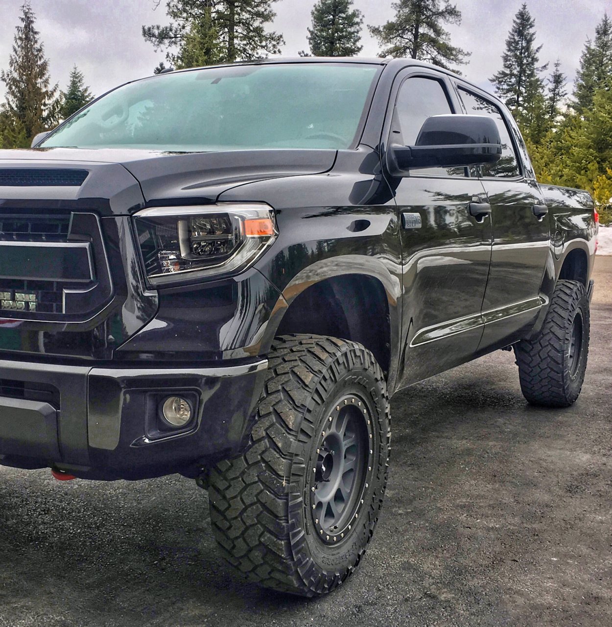

    Jan 3, 2019

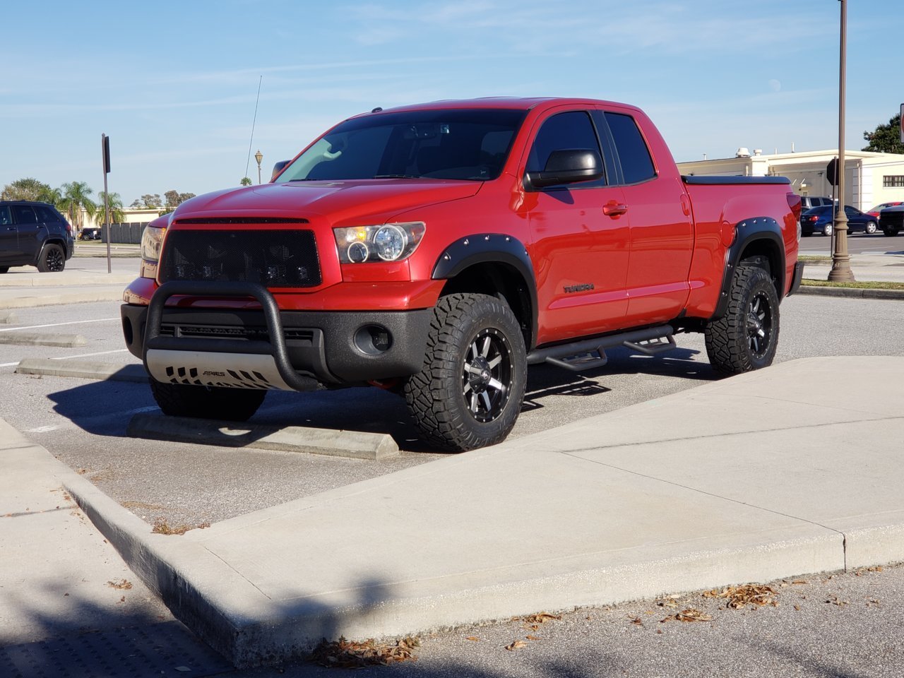

    Readylift 3/2 SST kit with 285/70/18 Ridge Grapplers on a +1 offset.

    Hey that looks good. I want half inch to inch of offset. I do not know what that would be offset wise.

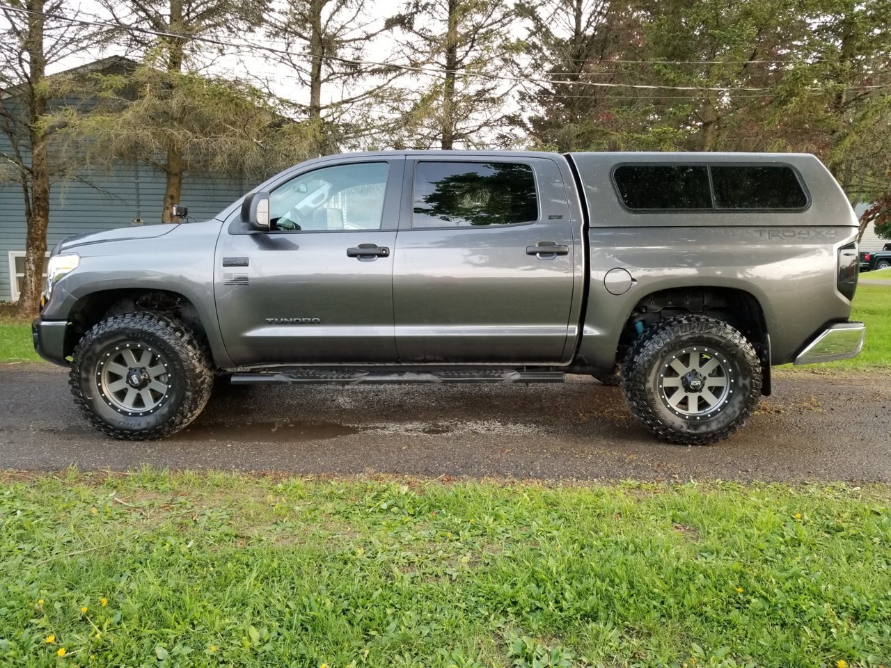

    Oh dang man that’s perfect. I really like that. What would a +25 be compared to +18? And what size tire is that ?

    I'm running 305 70 18s, have to trim and remove front mud flaps

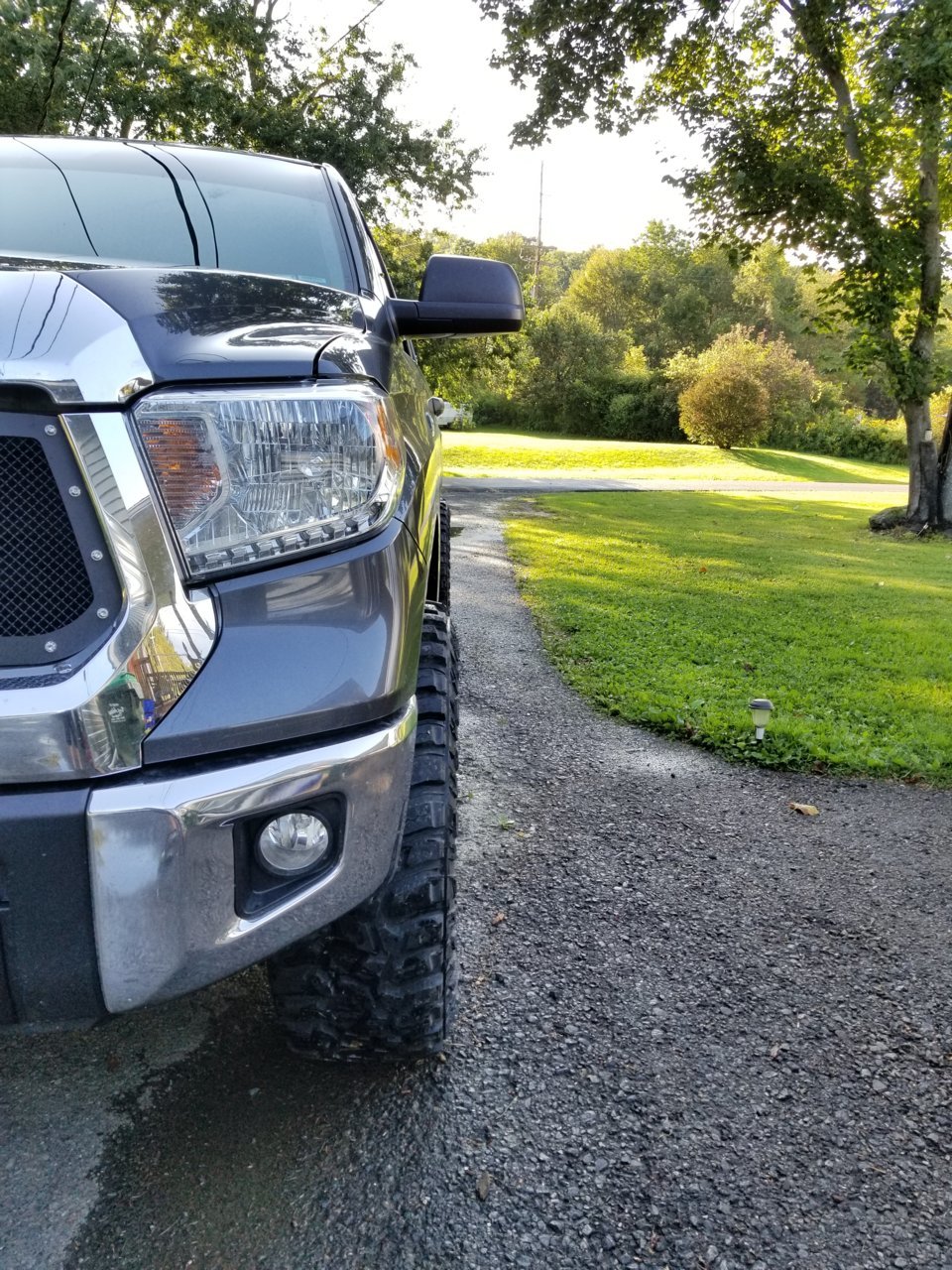

    Same +18 305 70 18s
    Stock wheels 2" spacers @ +10 305 70 18s

    That looks dang good man

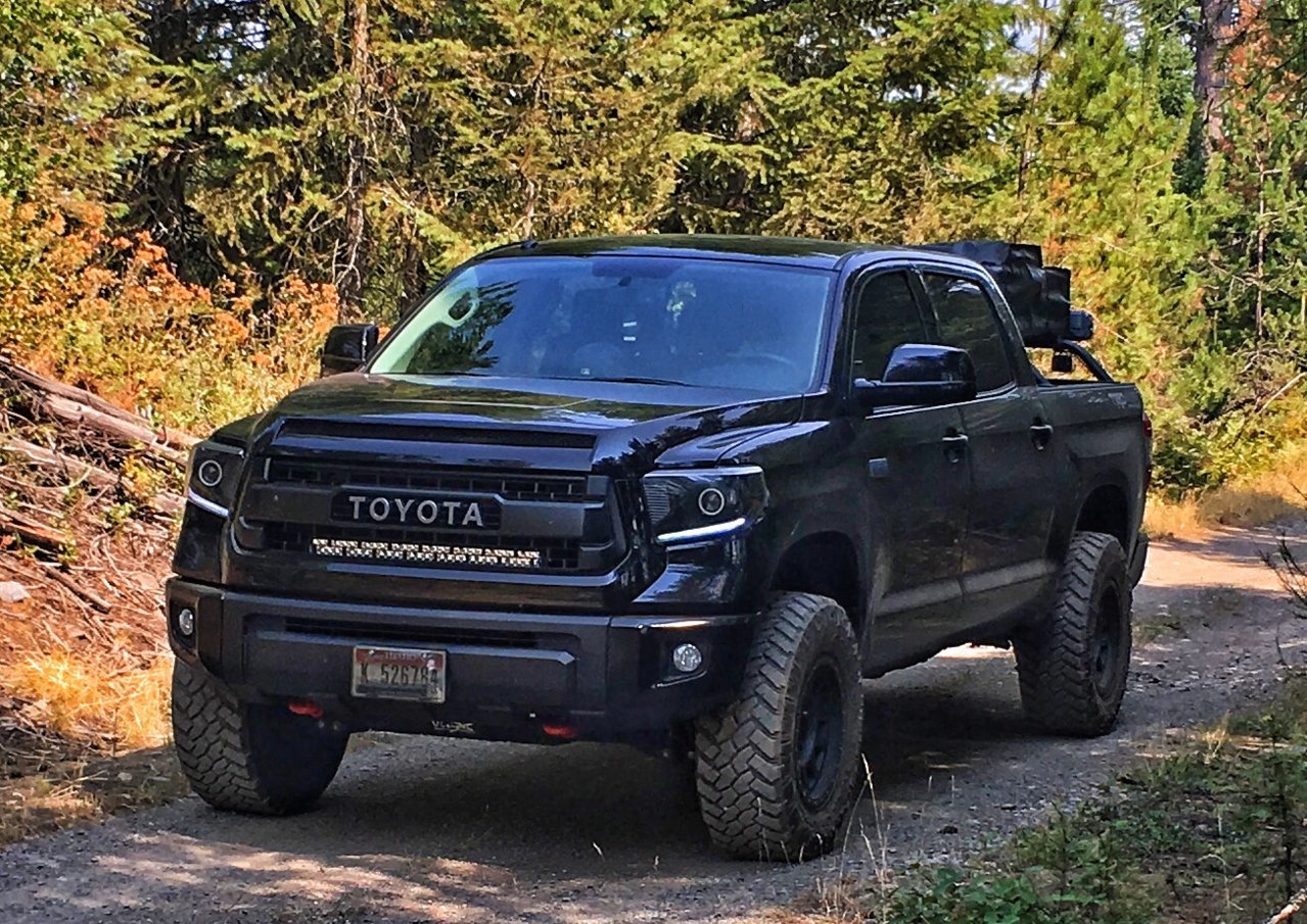

    Are those icons on ur black tundra ?

    Method

    Does ur tundra sit level or does it have a little rake before u had all the weight in the bed of ur truck ?

    level but I have aftermarket Deaver Leaf pack so it wont sag as much as oem toyota pack when loaded. Pictured above is really loaded with wood, gas, generator, smoker, gear etc..

    Mid travel fox 2.5 coilovers 2.0 real shocks shims 295 70 18 trail grapplers pro accessories 32in light bar blacked out bed cover sway bar Moto metal 970 18x9
    0 offset 295 70 18

    That’s a good looking truck. U have a BMC done I’m sure right ?
