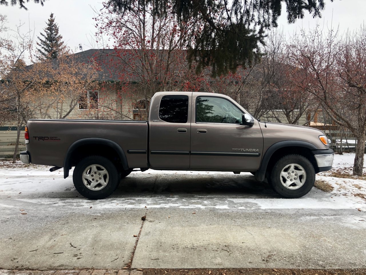

    Hey All,
    I have a 2002 SR5. Just installed Bilstein 4600's in the rear (it also has some relatively new leaf packs). After looking more at the truck I am starting to think about leveling the front end.
    What are my options for achieving a nice level? I am okay with buying new springs and shocks and prefer to avoid puck kits if at all possible. I also plan on installing a dif drop and the CV's after getting all the suspension figured out.
    Here is how it sits as of today.

    Bilstien 5100's are the route I went. Here's a pic of mine. I'm running 17" wheels and 285/70/R17 tires.

    That is a great looking truck. Did you just run 5100's in the factory springs? It looks like you have lifted the rear as well?
    Outbound[QUOTED] likes this.

    Yes, I kept the factory springs as they were still in good shape. I have 5100's on all 4 corners. Only the fronts are the adjustable ride height and set to the 4th notch which gives 1.6" lift. The rear are factory height.
    I believe the '05 trucks have a slightly higher stance than the '02, but I may be wrong.

    They do look a bit taller. That sounds like the easiest option, I think I will install 5100's in the front (unfortunately I already installed 4600's in the rear, oh well). I need to find some factory springs, the previous owner of this vehicle installed some Monroe quick kit and I do not want to reuse those springs.

    No problem. The 4600's will be just fine in the rear. Don't worry about those. I agree that you need to swap those springs out for OEM or a quality aftermarket. I won't let Monroe anything anywhere near my vehicles after my experience with their Sensatrac shocks in my first Toyota pickup.

    New(er) TRD Springs in the front with some Billy 5100’s. Looks like you have some mechanical skills and could steal some springs off another Tundra.
    Warning: The Billys are firm riding. Great for tow, haul, and road use. Off road maybe another option $$$ will $uit you.

    You're on the right track. Even if you wanted to, I believe it's been stated those monroe springs won't work on others. So you couldn't put those over 5100's even if you wanted to. In just mentioning that as an FYI.

    Called a buddy and he has a set of TRD springs for me. Going to pick up the 5100's and hopefully get it all buttoned up by the end of the week. Thanks for the help guys.
