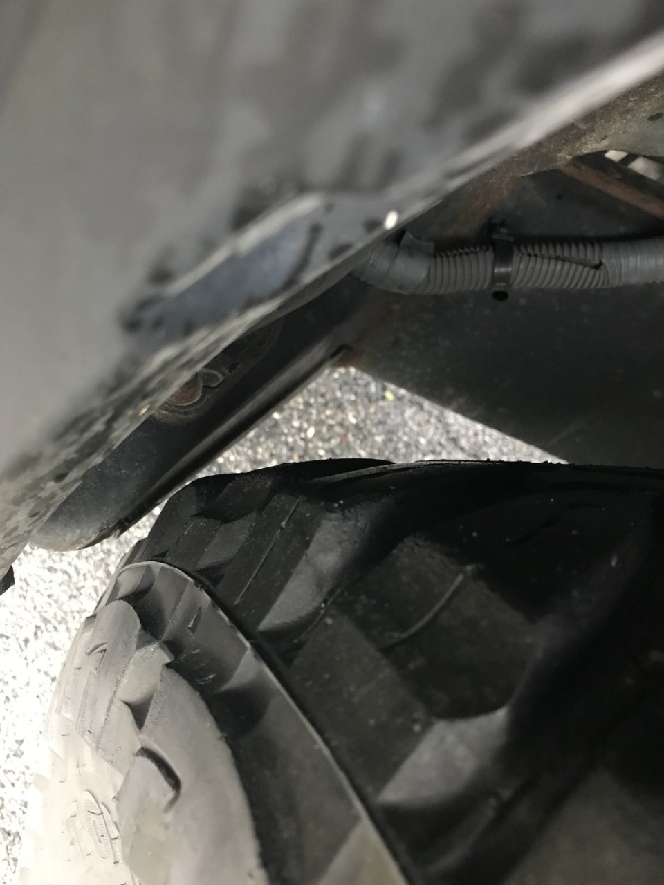

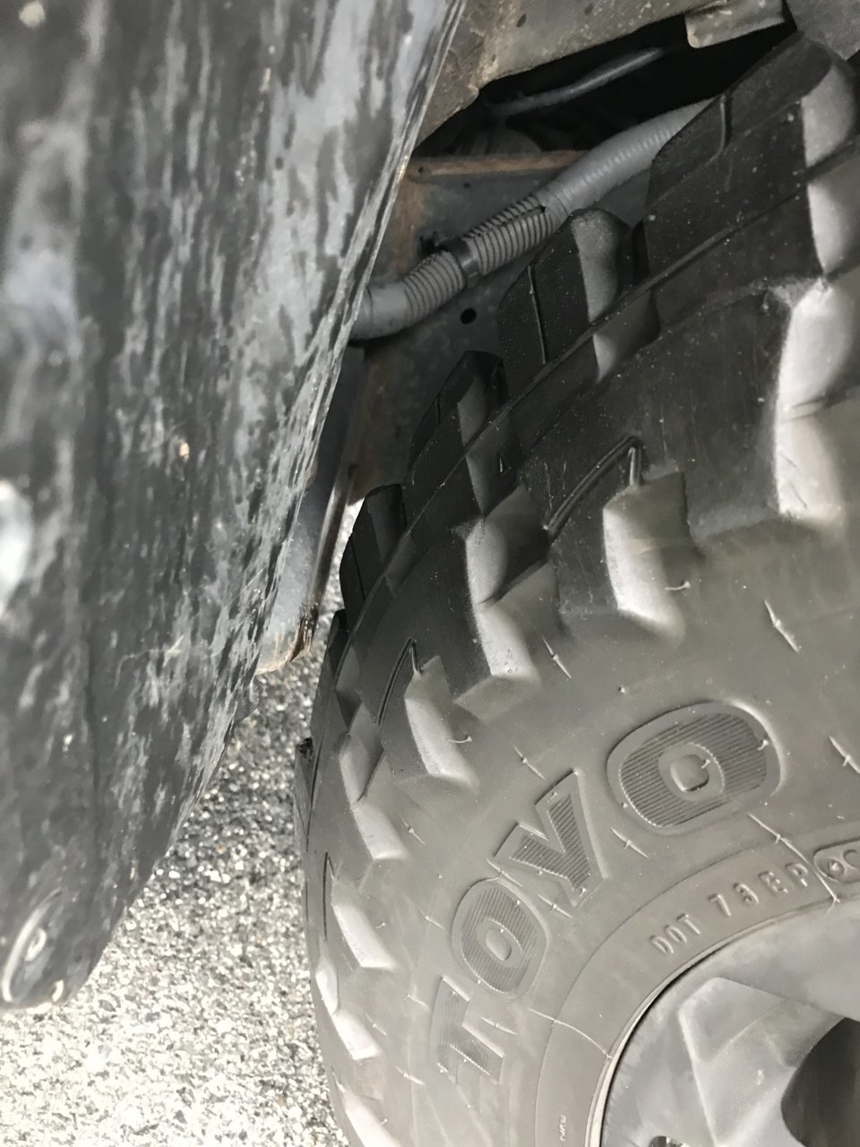

    Ian
    2011 Black Tundra CrewMax Rock Warrior
    Leveling Kit, 35's, Cat Back exhaust, Havoc HS2 Steps
    I have a 2.5" front leveling kit with 35's and the tires rub on the body mount. I will have to chop the body mount for the tires to not rub. 33" and smaller and you will be good with no chop. Current tires are worn down too; getting new tires next week and they will definitely rub more.
