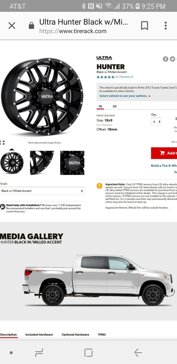

    I just ordered these wheels and I would like to level the front for now.

    Nice wheel. With a +18 offset and just leveling the front you could easily go with 275/70R18 or 285/65R18 with minimal issues. Level is ~2". The 5100's on the middle setting would lift the front about 1.57" so you would still have a slight rake. Going to the top setting on the 5100's is about 2.25" so it could be a tad nose high.

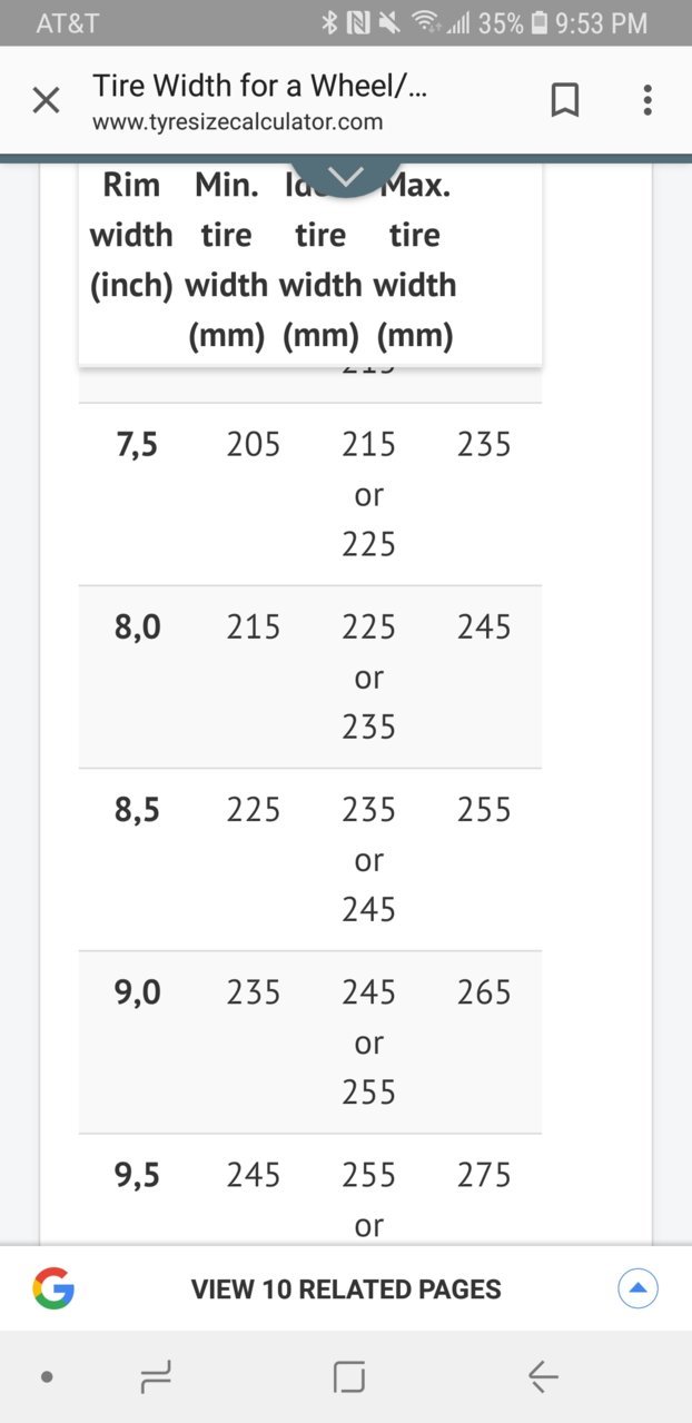

    I think that the wheel width for a 255/70R18 is 6.5"-8.5". I would check with your local tire store about putting these on a 9" wheel.

    This is what I went by

    I don't understand how tire companies decide this. Looking at the Toyo Open Country A/T, 255/55R18 & 255/65R18 says that it is for 7"-9" wheels and the 255/70R18 says it is for 6.5"-8.5". Seems like the 255/70 should work.

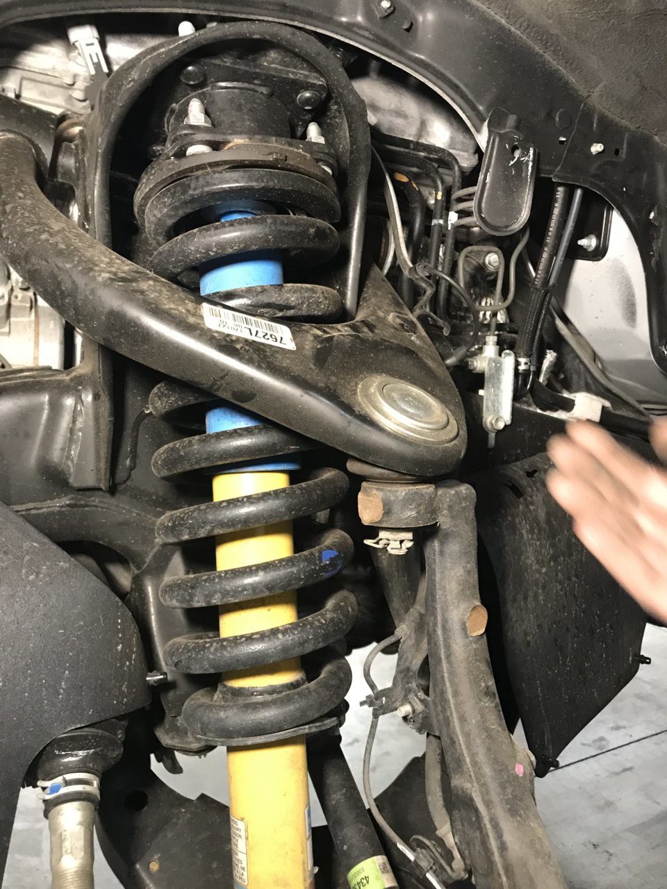

    FWIW, I took this photo the other week while assisting on an install. (Swapping this spacer for a coil over kit) This is a spacer with full droop- notice how the UCA is in contact with the coil?:eek:

    I would recommend this route as well. Ride quality is better, coil overs/shocks are top notch, and price can't be beat.
