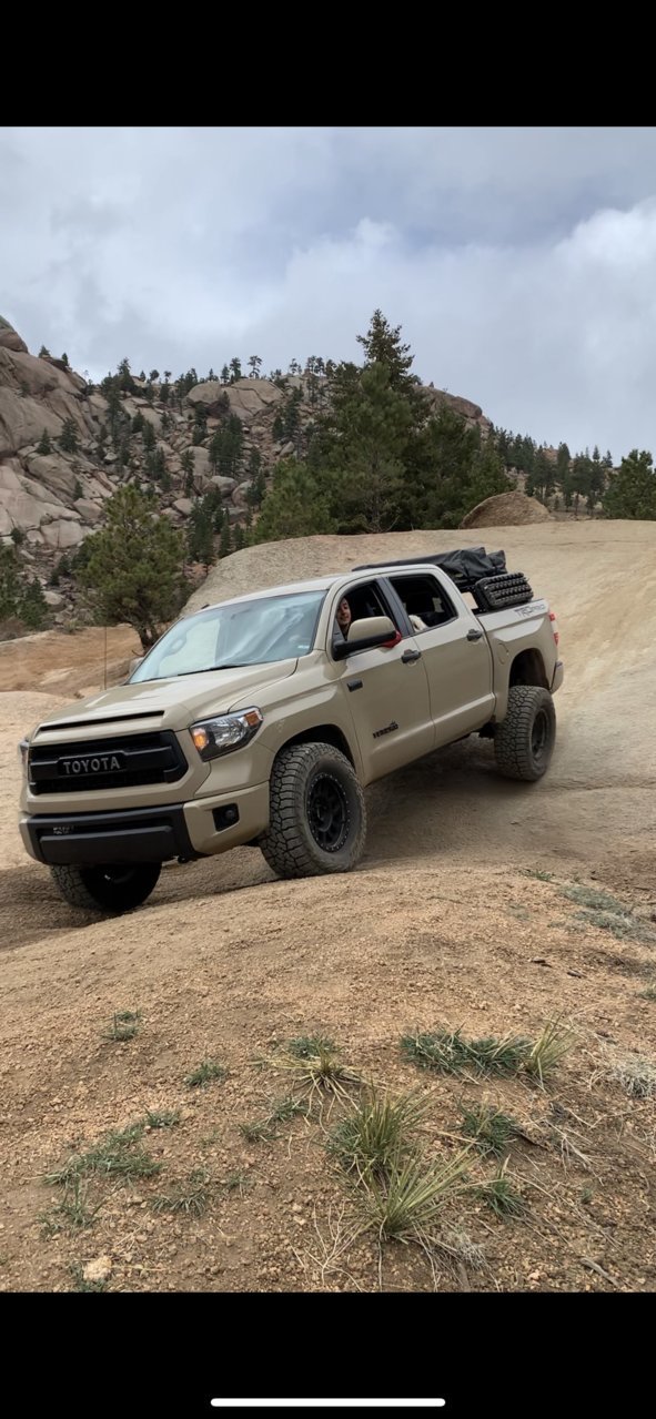

    Picture of the Rig.

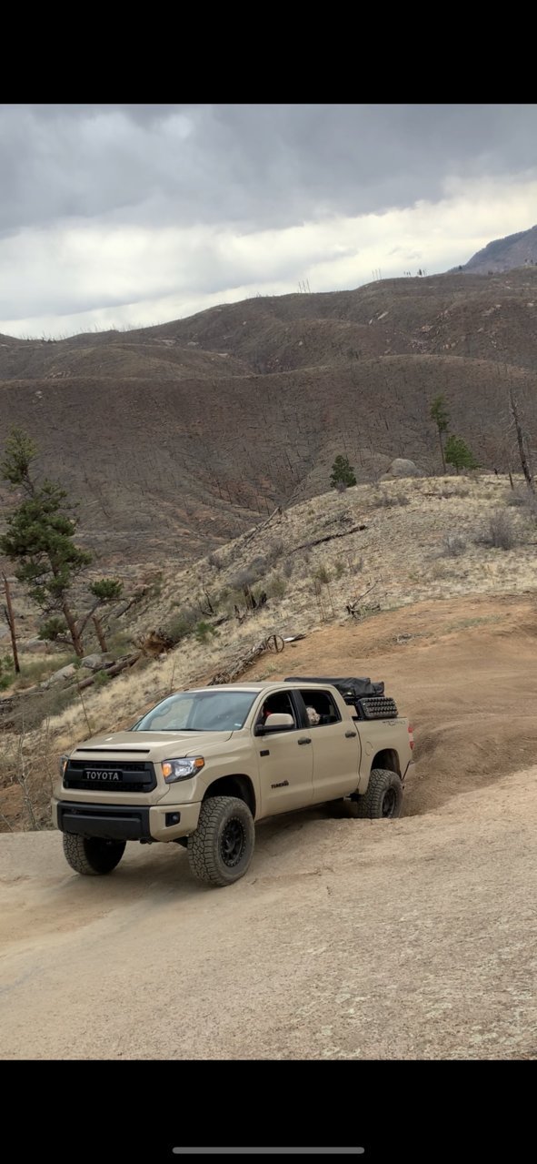

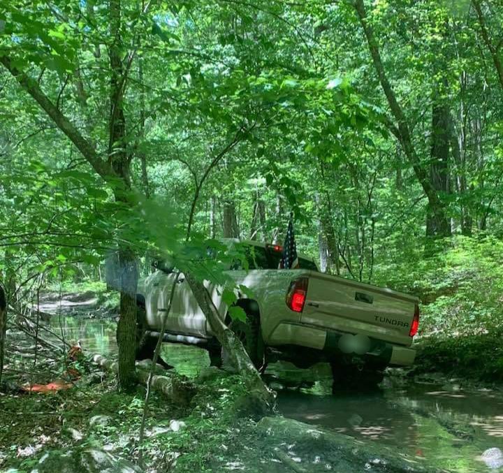

    I'm running Fox 2.5's with adjusters in the front and back, Icon RXT pack for leafs, and SPC for uppers.f Currently I only have a bed rack and RTT (and camping gear of course) but do plan on getting a front and rear bumper eventually. I'm on 650 pound springs and it rides perfect, especially with the adjusters.
    In terms of travel I haven't had any issues, although this past weekend I did end up with my tail end 3 feet in the air because of some wicked washouts...
    Below are some pictures of travel, I still had a bit of stretch left in the first pic. My setup isn't crazy, but it allows me to do tight jeep trails here in CO. Even had some jeep dudes say they were impressed I made the trail in the Tundra. It was Metberry Gulch for reference. Pictures don't do it justice.
    In terms of other suspension options (King, Icon) I went Fox over King because they use harder piston rods and a better hose for external resi's, plus are rated for colder weather (shock fluid). I didn't want to go Icon because of the digressive valving. I would say Fox is probably more linear, leaning to the progressive side, but there are others that can probably speak more to that. How I understand it is:
