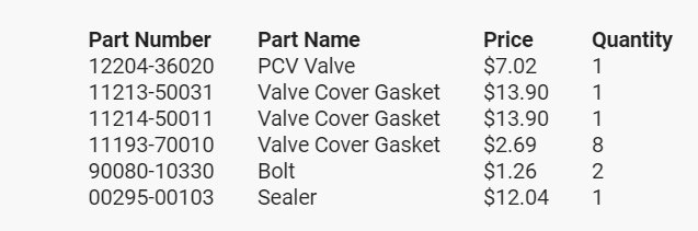

    You can you do the valve cover gaskets independent of the timing belt. I would honestly just order the OEM parts. They are not that expensive from McGeorge or Cool Springs Toyota.
    Below is the breakdown for my 02, some of the part numbers may be different for your 05.
    bmf4069 and skunk[QUOTED][OP] like this.
