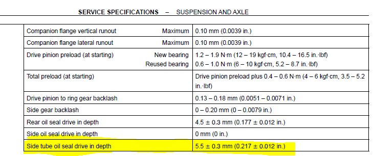

    Is this it?
    edit-better screenshot,

    I think it might be, I was thinking of the picture where it kinda shows which face to be measuring off of. Where it actually shows the pass side tube/bearing

    To bad, for others that need pictures to help understand. So if I’m reading it correctly it can be a minimum of .3mm past the very outside edge of the lip, and a max depth of 5.5m. So send it to 3mm deep past the very edge and call it a day? image.jpg

    That means 5.5mm give or take .3mm, so anywhere between 5.2-5.8mm would be in spec.

    You and @Festerw are why I come here. Haha it’s all how you read it! Thank you for the clarification.

    Is the part I circled in blue the seal, or the tool? Is the seal supposed to be 5.5mm deeper than the lip of the diff?

    Blue is the service tool, a 2” pvc cap or coupling works well. And yes it’s supposed to be 5.5 deep past that lip
