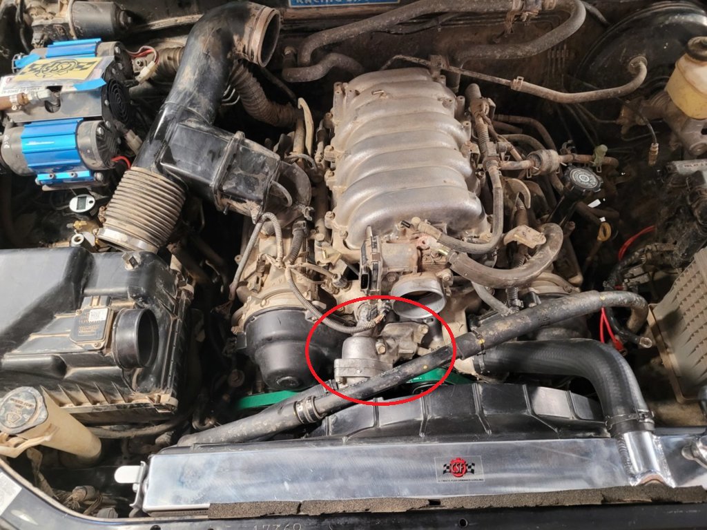

    The water pump is tucked in on the engine block, not the radiator. It could also be leaking at the thermostat.
    Look in this area closely and on the engine block.

    Just dug through some photos I took when I replaced mine -- you can see some of the stuff I had to clean off. The dried coolant is from the weep hole on my original water pump and wasn't an active leak.
